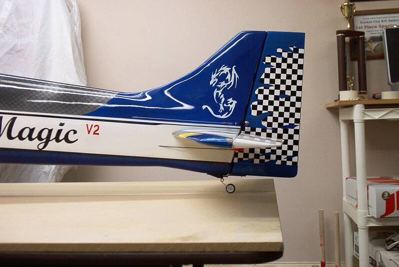

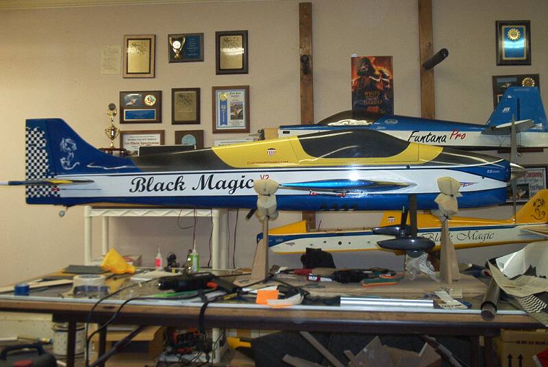

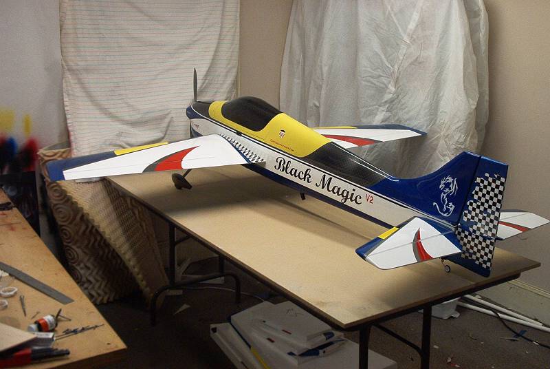

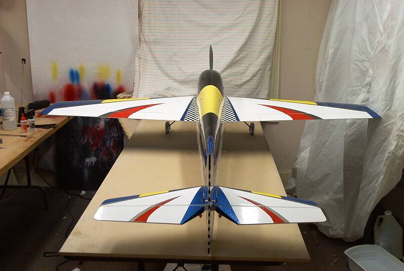

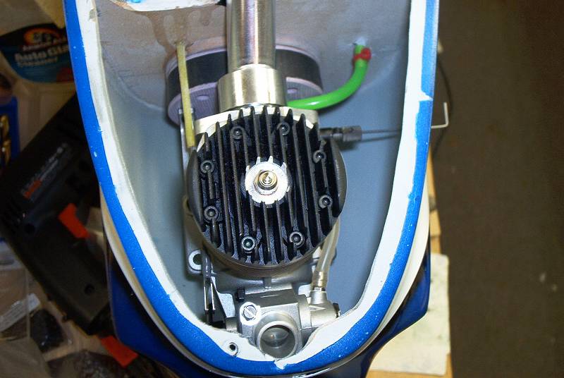

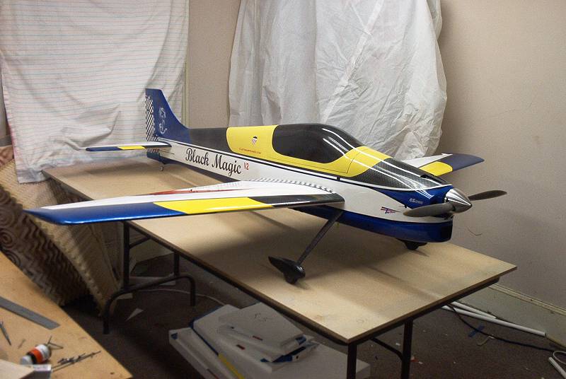

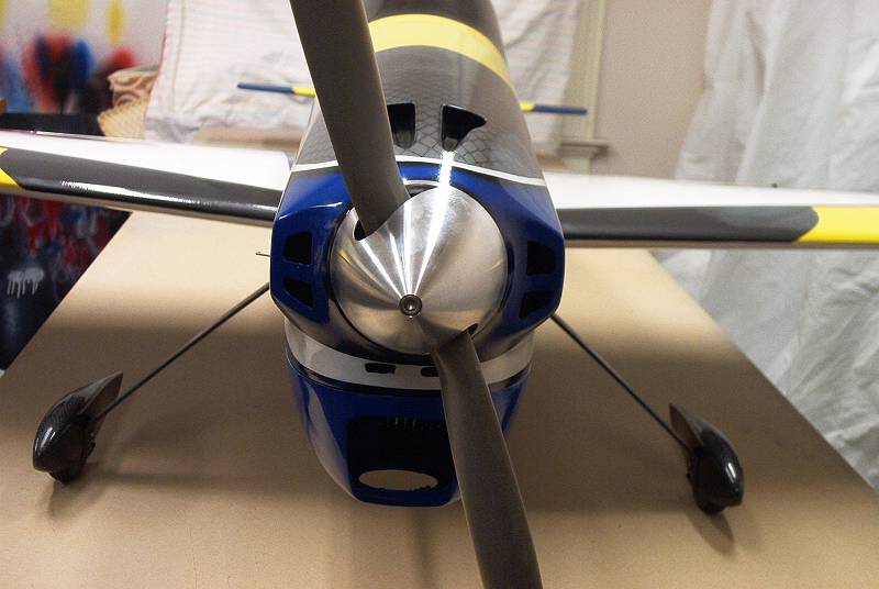

Ok, love it or hate it, here it is. The first of a matched pair of V2s for 2006.
Engine: OS140RX
pipe: Es 140m80
Servos: JR digitals all around
WEIGHT: 9 lbs 8 ounces!!!!!!!!!!!!!!!!!!!!!!!!!!!!!!!!!!!!!!!!!!!! !!! Pay up Frack! LOL j/k
With any luck, she flies this weekend. More detail pics to follow.
-Mike

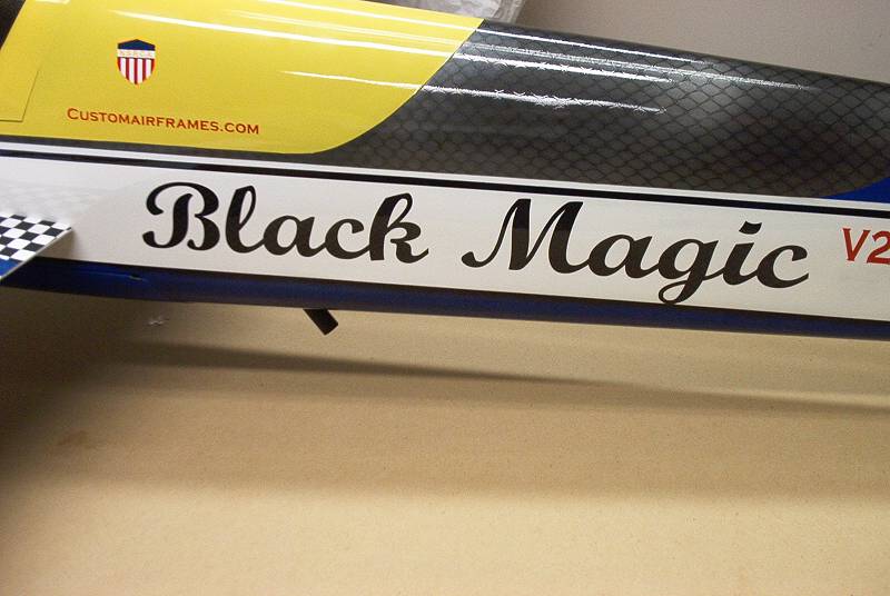

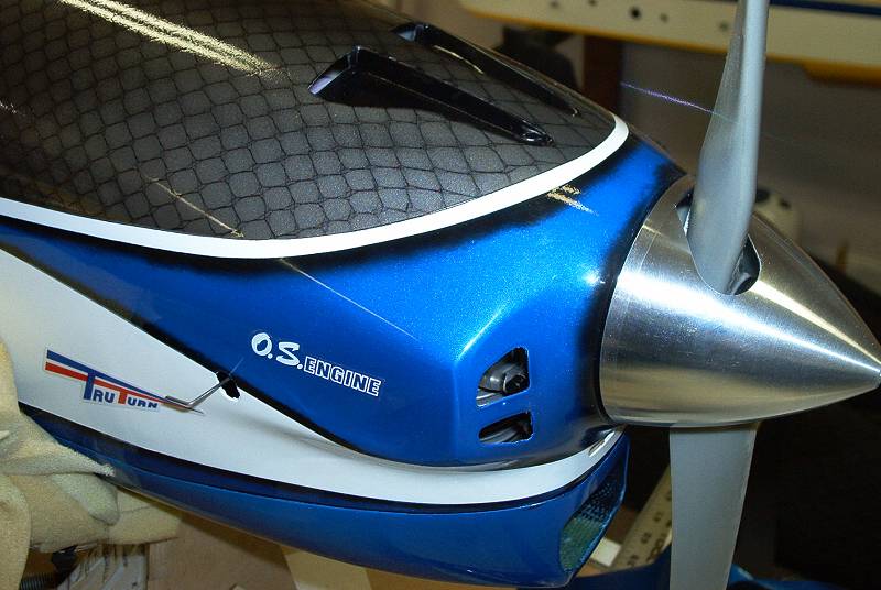

There, that's enough.
I'm not really happy with the yellow around the canopy. It lost some of it's vividness when I sanded and cleared it. But I'm NOT repainting.
Say whatcha want, it's definitely different!
9.5 lbs......wow
-Mike

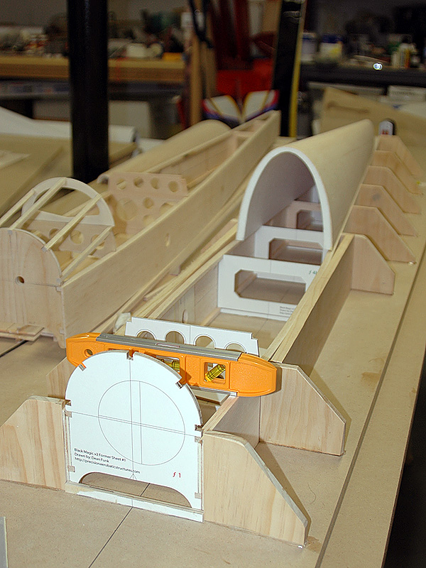

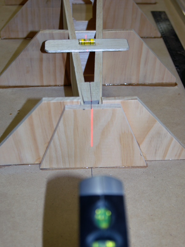

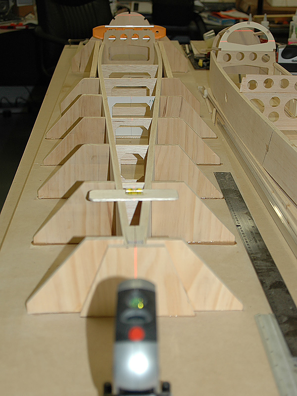

Hi All,
Here are some pics on the second fuse I am building for a customer. These are pics from the fitting this morning. Things lined up with very little triming or sanding. I have a little fitting to do around the firewall stringers then just run the glue... she is ready to go. I am building this fuse stock except for 1 - 5" x 2.75" verticle grain 1/8 blasa doubler from the landing gear doubler to f -3 on each side, it's like a 1 g piece of wood. I'll run the glue tonight and do the flooring weds morning. I need to deliver this at the Ocala meet. she's almost done...
I am also making a few improvments on the jig, smoothing out the slight bow between f2 - f4. I'll have more photos and a write -up once the dust settles a little round here.
I have also been caping my wing, stab and fin cores I sheeted last week. My stuff is coming along now... I've got my two main fuses to go into the jig next. I am waiting for more .007 x 3" carbon to come, I am going to run this on my fuse sides on the doublers. either 1/2 wide strips or a full 3" wide strip - running from the firewall to the rear alignment doubler. I am also running verticle grain 1/8 balsa doublers from f2 - rear alignment doubler.
I do have a small repair job on the Focus before I can leave for Ocala, My Focus has a modifed "top loader" canopy built by the original owner. Well to make a short story even shorter, the canopy blew off, and thank god came down without smashing to bits. I've got it taped on and it survived about 8 practice flights on sunday. But I guess I'll need to run a little epoxy on it too!!
Really looking forward to see Mike's and Emory's planes in Ocala. I hope the weather is great down there, we had a little bit of early spring weather this past weekend. Warm and a little wind.
cya, Dean
