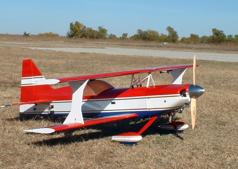

Hi, guys.... pardon the intrusion .... I've done a few Great Planes ARF's lately, that have been "Covered in Genuine Monokote". Some were not as bubble-free as I would like. As I started touching up these, I realized I was nudging the iron temp higher and higher....Finally, on my "calibrated" iron, the setting that REALLY ironed it down, and to itself, was quite a bit higher than I was used to. Can't tell you what that was, but also the "standard" Monokote heat gun has to be held within 1/4" of the surface and moved pretty slowly to get it to truly "shrink" over open-bays.
I'm only sharing this as it seemed odd to me, but the higher temp settings seems to have worked out.....

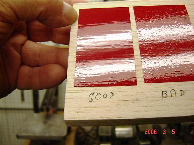

Mr. Baxter I contacted you last year about the problems I was experiencing with MK. You used the same explanation then as you are now regarding proper application to ensure a quality finish....well a picture is worth a thousand words...this pic of MK that others have posted before me speaks volume to the quality of today's MK. The symptom seen with the swatch on the right side is exactly what I experienced and tried to convey to you spring of 2005.
Wake up and listen to the consumer for a change....
If you are interested in actual examples of this feel free to contact me offline....

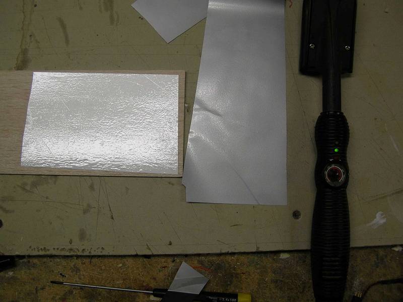

I saw a similar texture problem with the aluminum color rolls I recently used on a project. Every aluminum roll I got had it. Will post a pic when I get a chance.
Old 03-07-2006 | 03:08 AM
  #42
My Feedback: (42)
Joined: Jul 2004
Posts: 878
From: Randolph, NJ
Default RE: Monokote
Here's an example of the silver Monokote texture problem. The wood was sanded smooth down to 600 grit, cleaned up with a tac cloth and the Monokote ironed down at 375 F. You can see the adhesive side of the material from the same roll and it clearly shows the problem. It doesn't adhere too well either.
