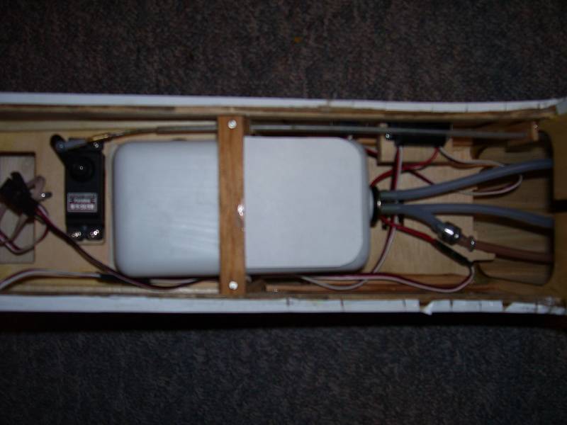

I have to run out the door for work, but here is one to start.
1) Here i cut the top (facing you when plane is upside-down) of the fuse former.
2) Add some small hardwood pieces to the sides of former to make a spot for the screws you see in the picture. They only need to be as long as the screws.
3) The cross member you see is 1/8 x 1/2 inch hardwood strip with screws. this reinforces the former back to it's original strength. and holds the tank in position.
4) I added thin foam under the tank to protect it from abrasion
As you can this provides a nice place for a tank.
Notice in front of the tank is more room, and more room at the original location for the tank.
Servos are in the tail.
I can post more pix later.

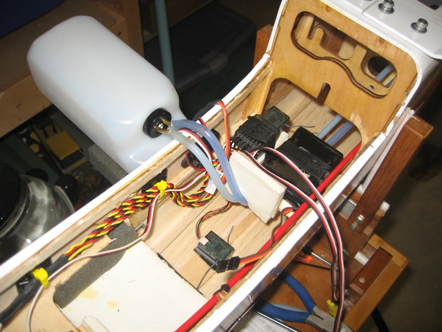

I moved the tank to CG in the way similar to what codfish did. If you search a couple of pages back, you should find some pictures.
Here are some more pitctures of my installation.
1. The cut out area around CG. Note that only the central area of the servo tray has been cut out. The two remaining sides become the anchor areas for the two veclo pieces (the rear two). The bottom of the canopy deck was beefed up with 0.2mm CF sheet.

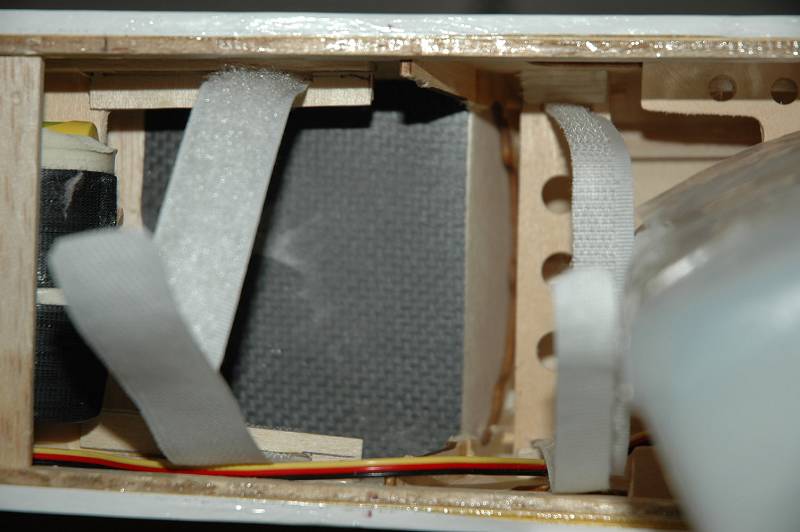

2. How the velco pieces are anchored to the fuze.
3. How the front velco piece is anchor to the fuze. The wood piece is glued to the fuze.

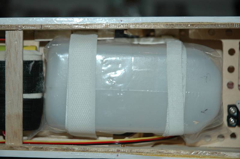

4. The fuel tank
5. the foam rubber is placed first before mounting the tank
6. Tie down the velcos to secure the tank
7. There is about 1/4" Gap for the tank to clear the wing.
8. Another wood piece added to mount the throttle servo.
