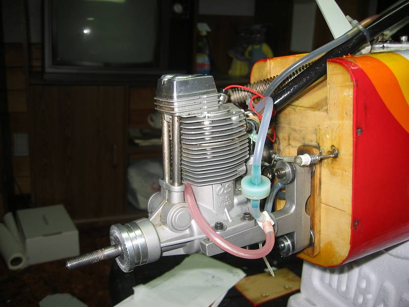

Would you recommend the Dubro Vibration Mount??
http://www3.towerhobbies.com/cgi-bin...5&I=LXD633&P=K
The size a weight of the 150 is actually smaller a less than the OS 120s.

ORIGINAL: TomTreese
P.S. I have not even changed out the rubber grommets yet. Maybe in another 100 or so flights.

Though I haven't had any failures, I don't think those mounts are well engineered. The torque pulses are what we're fighting and that kind of isolating mount is mean for low-amplitude, high frequency vibes. For you engineer-types I mean a rotating radial force vector like that caused by an out of balance prop.
I initially installed one of those Dubro mounts and very quickly wore out the isolators. I went back to the solid, glass-filled type and the airplane seems happier for it. I think that Merle Hyde got it right with his mount. It's designed to dampen shocks in the props plane of rotation - a rotating circumferential force vector.

Now what in the world do you think the difference is with my planes. I've used these mounts exclusively for 10 years now and have had them in about 10 different airframes I even used one on a 26 cc gasser with a full length tuned pipe. I have ALWAYS been satisfied with the vibration damping, have never had a failure of ANY kind ( mount, airframe, servos, switches, etc. ) and after a total of at least 2000 flights have NEVER replaced any of the isolators or have never seen anything but exceptable wear on them. My Venus has the canopy and cowl screwed on with servo screws and there is next to nil wear in any of the holes.
I'm baffled [X(]
P.S. I decided after I wrote this to pull the cowl on my Venus and check. I have 307 flights on this set up and over 100 since I pulled the cowl. The mount and isolaters are like new ????
I'm baffled [X(]
