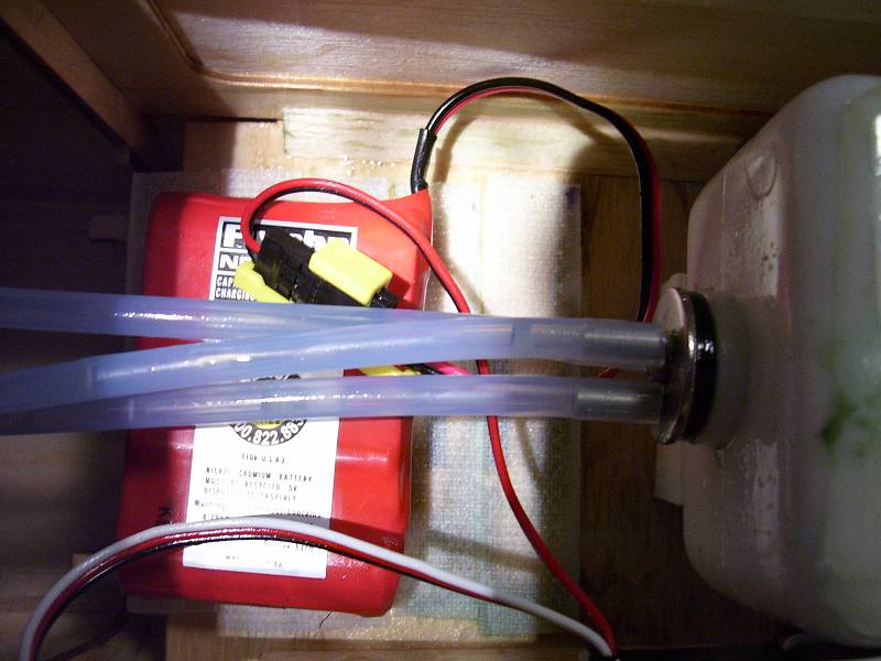

here is the pix of the front of the tank support. note the servo tray is used as a tank supprt, but it is installed deeper into the fuse than the origianl postion. this way it lines up with the tank top. note the triangle stock to make a bed for the ply.

I now have 19 great flights on my Venus II. However, with the Saito 150 and the stock 14 oz tank, 9 1/2 minutes seems to be the limit at Pattern speeds.
I can't find a 16oz tank that fits like the 14 oz that comes with the kit? I think the originally had one in the kit??
Has anyone used a Dubro 16 oz and mounted it on its side???
I am happy with the tank where it is since I always use elevator trim throughout the flight and I don't want to mess with too much cutting a fit for a larger tank.

I installed a Dubro 16 oz fuel tank in the Venus II.
I had to remove about 1.mm on each side of the slot in the former in front for the tank to fit in sideways. With the tank chin mounted to the right, that lines up the tank stopper with the hole in the firewall.
A strip of foam padding on the chin. around the former and at the back of the tank as well a 1" thick piece of foam above the tank all fit just like the supplied tank.
This will make the 10 minute flight with ease.
