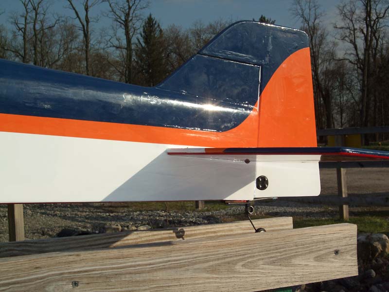

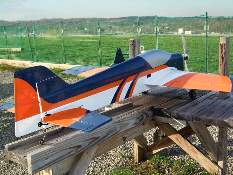

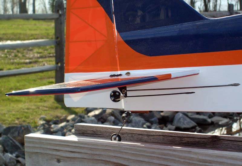

Here are some pics from my Venus II refurbishment project. Totally stripped and recovered with Monokote and Ultracote, and I shortened the nose about an inch and installed a new firewall, which should help with CG. I really didn't like the "shovel" type wingtips, so I lopped them off and used some scrap balsa pieces to stack, hack and sand the new ones. Fuel tank will be on CG, and I am using pushrods for elevator and rudder, keeping everything inside to keep it neat - the external servos on the tail are admittedly ugly, and covering up the holes (and the hole in the tail where I had buried some lead in the tail) was a chore, but worth it. I've got a Perry oscillating pump (VP-20) for the engine, the OS 1.20 FS that was in the plane before.

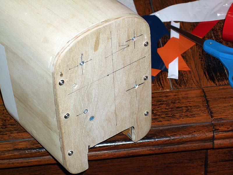

You can mount the engine closer to the firewall to help with the balance. There is room.
Indeed, achieving the desired CG with this plane with a heavier engine like my OS 1.20 FS is very difficult without adding weight to the tail. Previously, even with 3 servos in the tail I had to add 3 ounces of lead to the tail to get it to balance properly.
During my refurb, I knew it would take some serious changes to get it to balance because I planned to put the servos inside the fuse and use pushrods, making it even more difficult to balance.
What I did was; 1) shorten the nose of the model by 1 inch; 2) not use the 120mm flex pipe extension, which more than offset the addition of the Perry VP- 20 pump; 3) used a GF plastic engine mount and put the engine as close to the firewall as possible; 4) use a much lighter spinner; 5) put the fuel tank on CG, which was in fact the primary objective; 6) install the Rx battery waaaay back in the fuse, which was done by mounting the battery on a ply tray and gluing in behind the second former back from the wing saddle.
With all this, I got the CG to 6-3/4", just where I like it. With the fuel tank on CG it flies in the "sweet spot" all the time.
BTW, I painted the cowl and now have it installed, and some yellow trim on the wings, etc. No pics of that yet.
