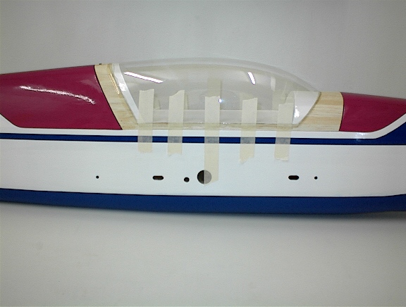

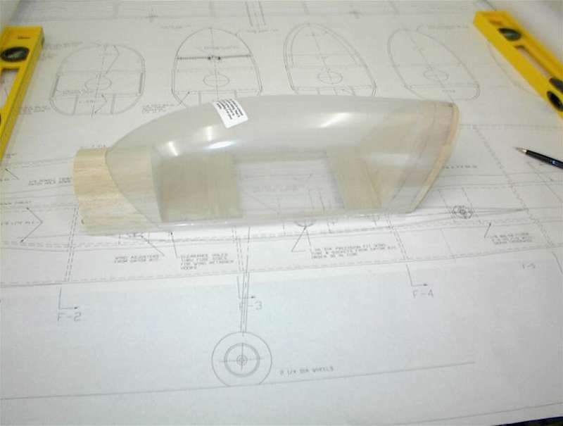

Gluing on the canopy.
I tried to make the frame look good by using some filler on the canopy glue joint.

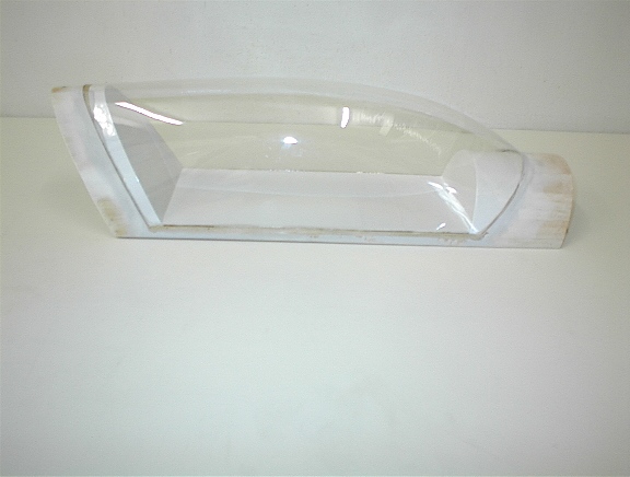

It really was essential for me to make a template around the canopy before cutting the film.

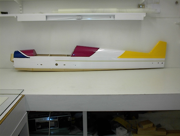

Now I have finished covering

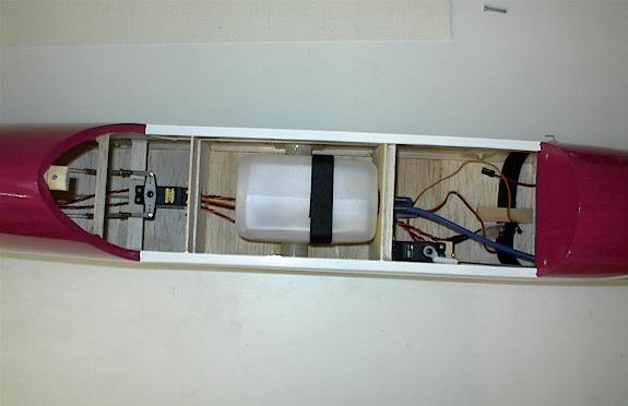

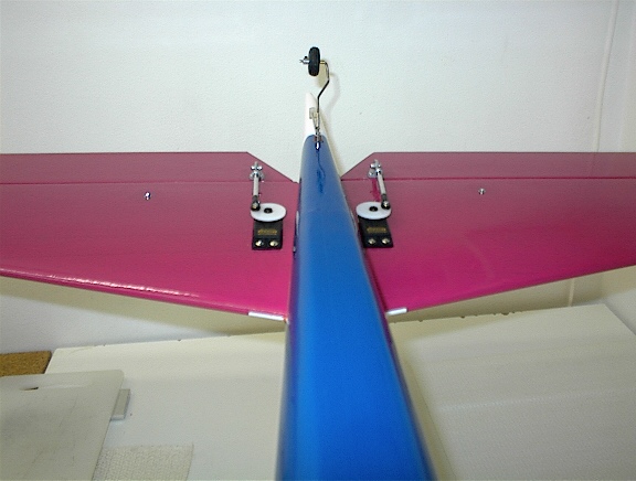

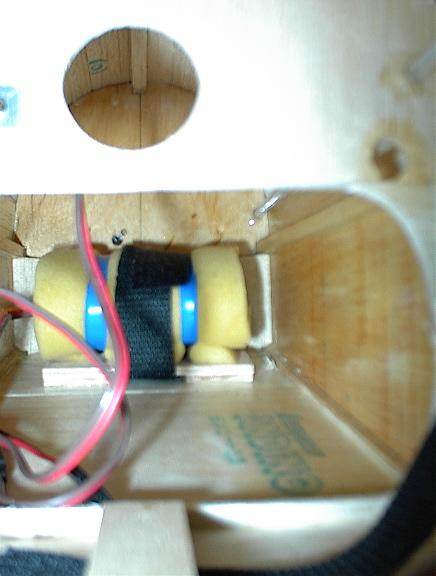

Spending time at the field really has slowed down my building so I took a break to finish my very simple sport Typhoon. With the servos in the stab and the battery up front, the C of G was spot on. There is so much room in this plane and that makes the radio installation very easy.
Servos for ailerons and elevators DS9401, for the rudder DS8321 and a standard ball bearing servo on the throttle.

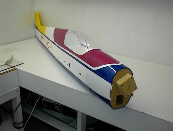

It takes a little time getting used to the huge Walbro carb sticking out.

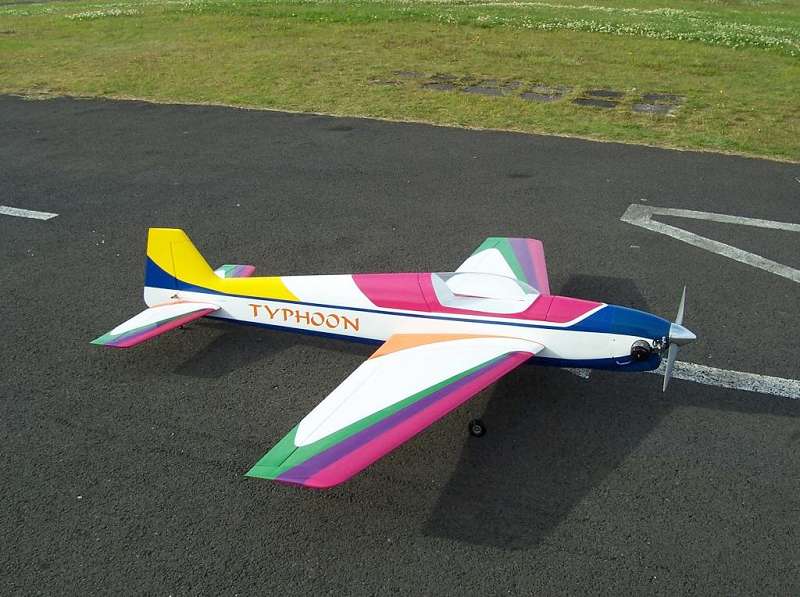

Flying
The Typhoon is the best plane I have ever had. Certainly flies way beyond my abilities and is also a real joy. Very very stable and accurate. The last model I took to the field was my old Magic so the difference in speed will take me a little time to get used to. The Typhoon just looks so slow in the air compared to my fast .60 size planes.
With the high fuselage it will be a challenge for me in cross wind so I'm looking forward to get to knowing this plane better and many interesting flying sessions.
