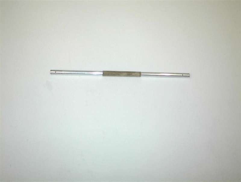

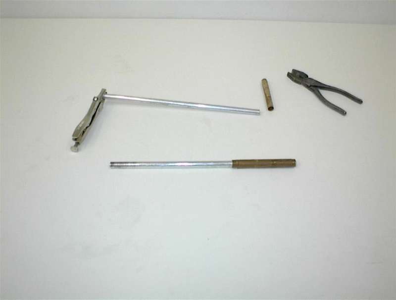

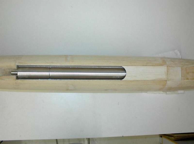

Before covering I needed to mold another socket for the tube because I noticed I had accidentally left a dry spot in it, stupid mistake. So instead of using fiber glass cloth like last time I wanted to try using paper and actually it was much easier.

Even though I waxed it carefully it took some effort to loosen the socket from the tube. But it came off eventually.

Done !
And this time it worked out very well.

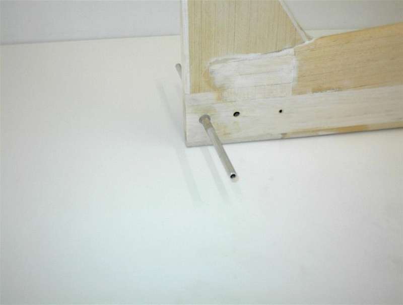

I noticed you are using (rectangular)aluminum stock in what seems to be a process to ensure stab is parallel with wing can you share this with us.
Also got the Supra-Fly 2500 down load and checking aound to find a local shop that can enlarge them..

Yes Richard
I use the aluminum stock to line up the stab and it works every time as long as they are lined up perfectly straight. I really can't do it any other way because my building board is to small. So it really works like an extension of my board.
Of course it would be much better to have a bigger building board but my room doesn't allow it. So for now it will have to do, but I always dream about a decent 2x2m board. Oh well, someday.... someday

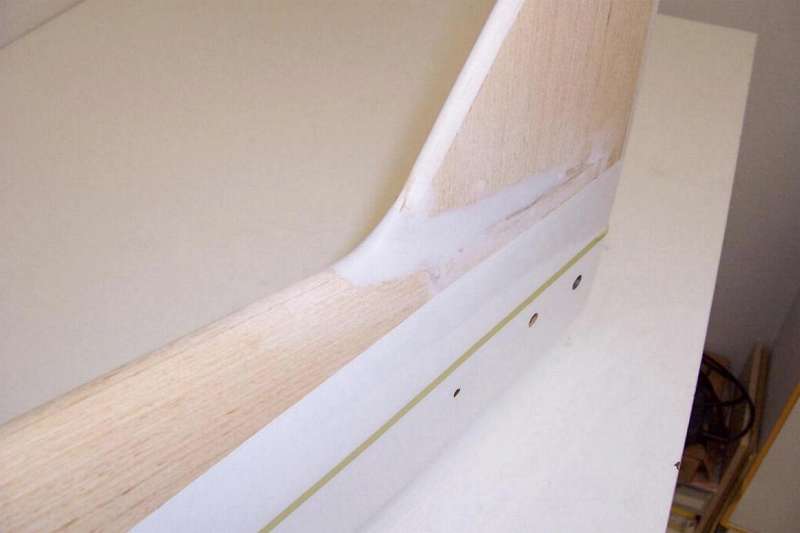

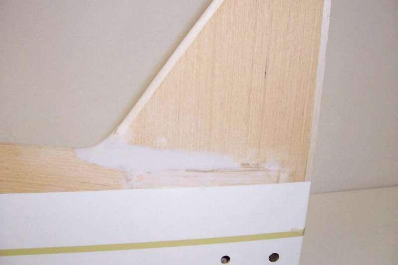

The Typhoon is such a beautiful plane it would be a shame not to try to get the fin to blend into the fuselage smoothly. I used a filler here, it is a little extra weight but I don't care, it looks so much better like this.

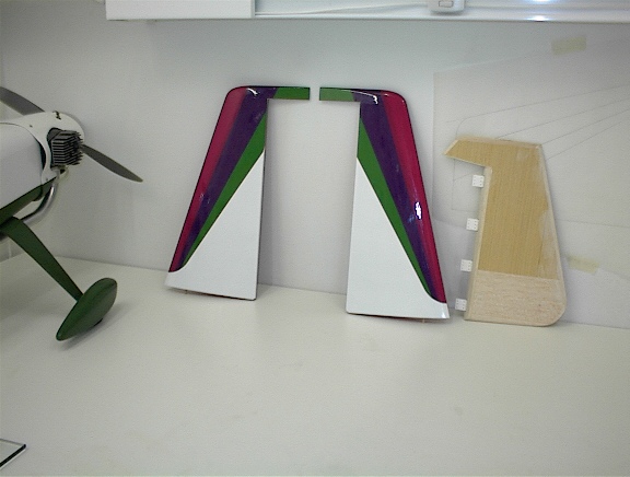

Now the wings and stab have been covered the ailerons and elevator halves are next.

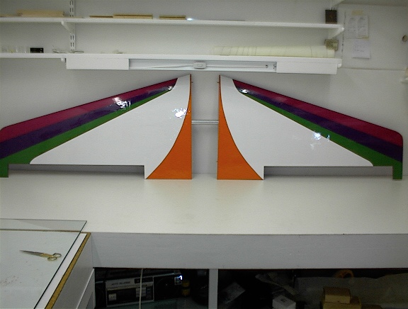

I have finished covering the wings and stab.
