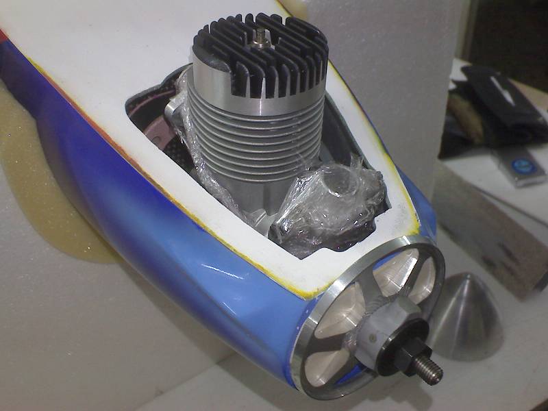

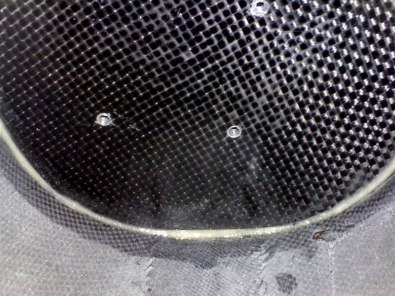

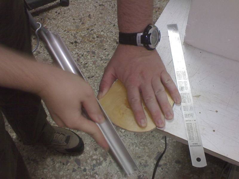

I would like to ask for an apologize from myself and the rest of you guys in this forum, since for almost two years I didn't put my hands on this model
Many things happened since then, a transfer far away with my job as well a new baby son in the family.
Finally I took the decision to start building it, I have all the staff so why not.
I started two nights ago and in total 5 hours firewall, engine position and nose ring are in position.
Here I am .........
**** Update, 8th May 08
Teh wings are installed and starting to work on the tail. Stabs needs a lot of cautiousness ... so be patient
