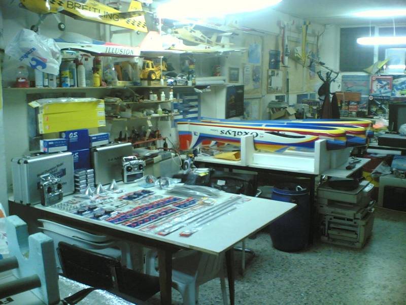

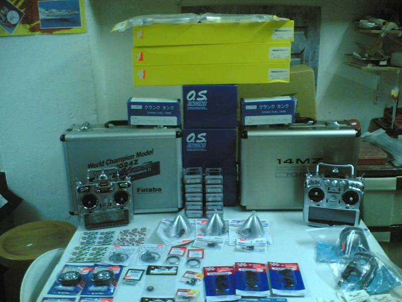

Hello Amram,
I got all of my staff on my bench (i think so) ... but haven't thought of using honeycomb instead of the kit parts ... what's your suggestion ?

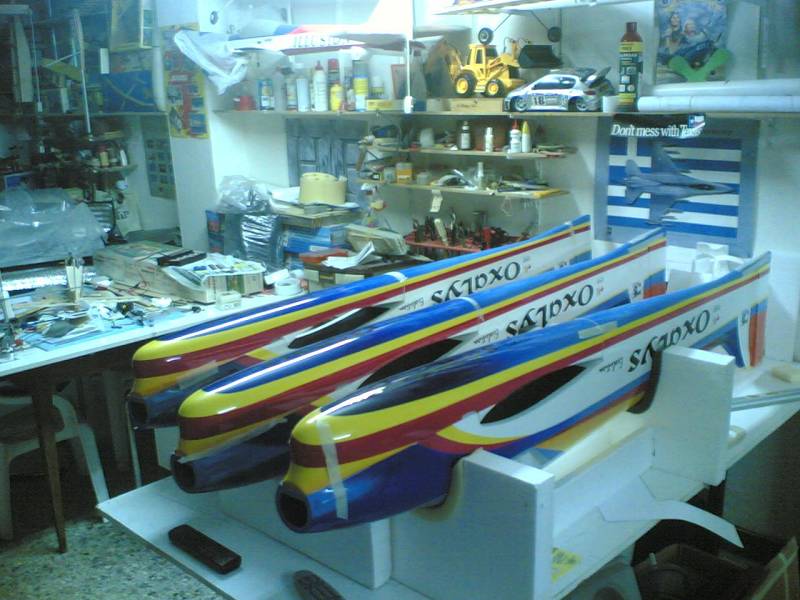

I am interseted for a canopy like yours, can you built for me two ?
I hope the next days to start working .....
Regards to all of you
ID:	495311   Click image for larger version
ID:	495312   Click image for larger version
ID:	495313   Click image for larger version
ID:	495314   Click image for larger version
