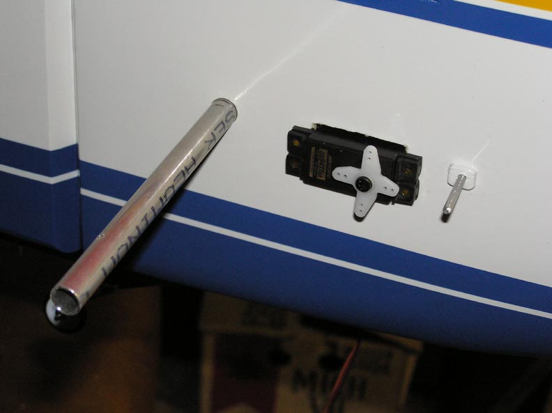

I installed the DEPS in my Brio and did not move the hard points on the elevator.
The exit holes came out slightly further forward than I would have liked, but it works just fine. Just for peace of mind I added a 1/8" CF rod over top of the .007 rod between the exit hole and the elevator horn since it was about 10 or so inches.
I'm very happy with he system and I think it provides excellent even control.
The primary reason I went with the DEPS was to move the CG forward because I built my Brio electric.

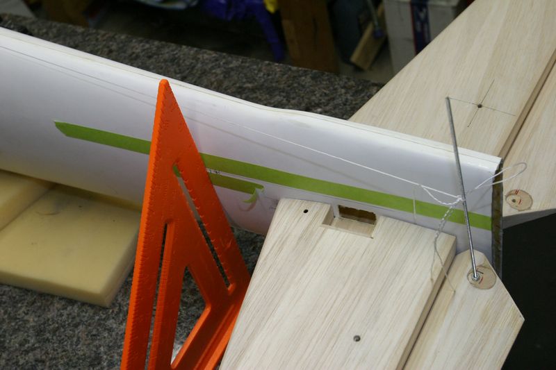

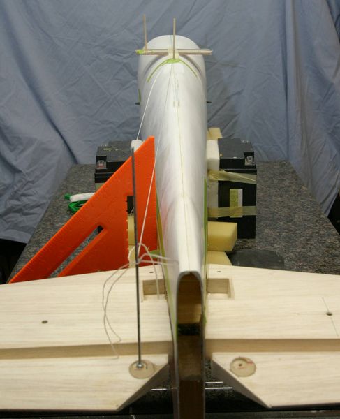

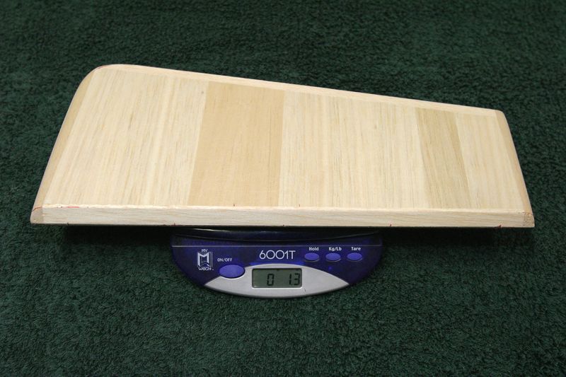

I forgot to mention:
1. Swapping out the rudder is a very good idea, the stock one is way too heavy and I've heard of cases where the hinge has cracked. It also makes it much easier setting up the DEPS system and a tail former if you choose to add one.
2. Two of the pictures included above show the technique I use to help find the exit holes for the DEPS system (also works for pull-pull).
I've attached some pics of my ruder build.
Keith B
Keith B

Thank you for the pictures Keith!
What did you install inside the rudder post on the fuse?
Also how wide did you make the trailing edge on the new rudder?

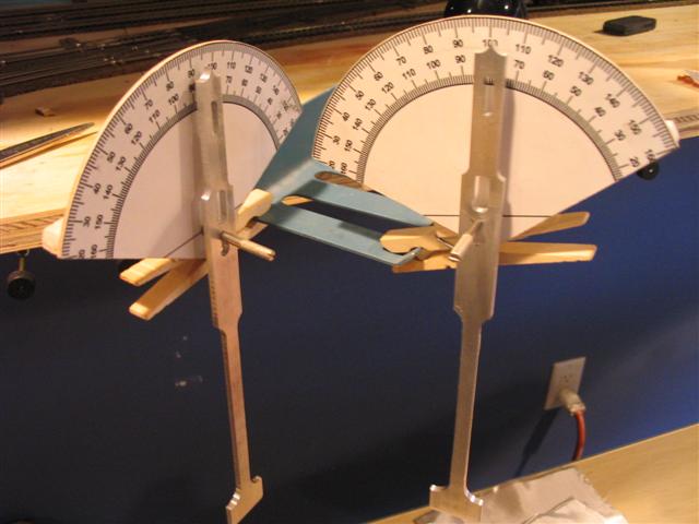

Maybe I am making a mountain out of a mole hill!
Most of my dual elevator troubles have been with large
planes and extreme throws on dual rates.
Setting up dual elevators to work perfectly at 45 degrees
and also work perfectly at 15 degree's is a challenge.
On top of that I like to keep all my radio endpoints at zero,
all my ATV's at 130 or 140, and all my rate numbers the same
in both directions. Basicly I work with the linkage and the
Hitec programmer until everything is perfect.
Right now I use carbon fiber sticks taped to the elevator half's,
some home made throw meters, a level table, a level aircraft,
and a lot of measuring.
Your laser pointer idea sounds great!
I imagine that setting up this plane should be a little easier
if I go with dual elevator servo's.

I have seen 3 variations on the dual servo installation,
One picture I saw had them in the fuse, another picture
had them mounted in the stabs but laying flat, the other
option is to build it per the instructions.
What to do????
I like the setup in picture #2

Personally I like the servos mounted on the stab, that way taking the stab off is simple and does not require unhooking the control linkage.
Second point, I see in your pic you have what looks like a JR DS9411sa. In my opinion that's WAY overkill for the rudder on a pattern plane. Also way too much weight. I'd suggest going with the [link=http://www.horizonhobby.com/Products/Default.aspx?ProdID=JRPS3421SA]JR DS3421sa servos [/link] which will save you 1/2 oz. They're about the same speed as the 9411s, actually .01 sec/60° faster
I've used these on two different planes with excellent results.
These smaller servos may also give you additional mounting options given their small size. I mounted both of my stab servos with the servo on its side, but I've found that this limits the throw that can be used since the arm will drop into the servo recess when throwing to the extremes. Because of this the next time I do this I'll probably mount the servo perpendicular to the stab (like is normally done with the aileron servo). This allows more throw without bumping into the wing surface.
Keith
Keith

And I on the other hand mounted them in the fuse because I didn't want to deal with the servo wires. I used the shortest extensions possible and had both pairs neatly twisted and running through a 1/2 in paper tube. It would have been more work to disconnect the leads from the receiver (2 channels on the receiver to your earlier question) and feed the extensions back through than remove a couple of <easy to get> bolts at the back end.

Picture #1 looks like my photo. I have 165 flights on this setup so far and have no complaints. Elevator trim is rarely touched. I just made sure I had two servos that were closely matched on centering. Lickily I didn't have to go beyond the handful I had laying around. I used the JR9411SA digitals which I also use on ailerons in my Brio and other planes. Just set end points equal and checked at various points and saw no need for multipoint mixing or anything like a matchbox.
