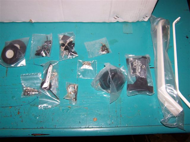

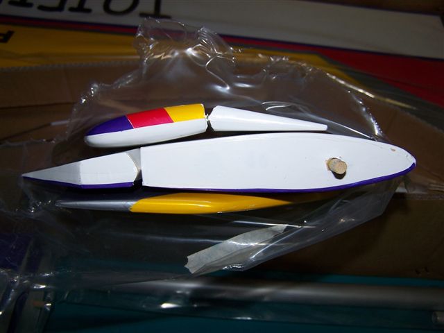

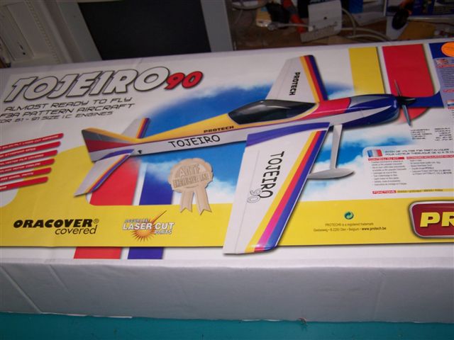

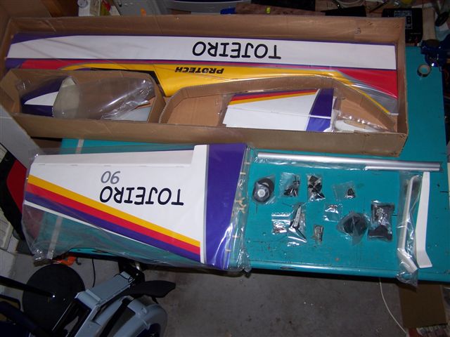

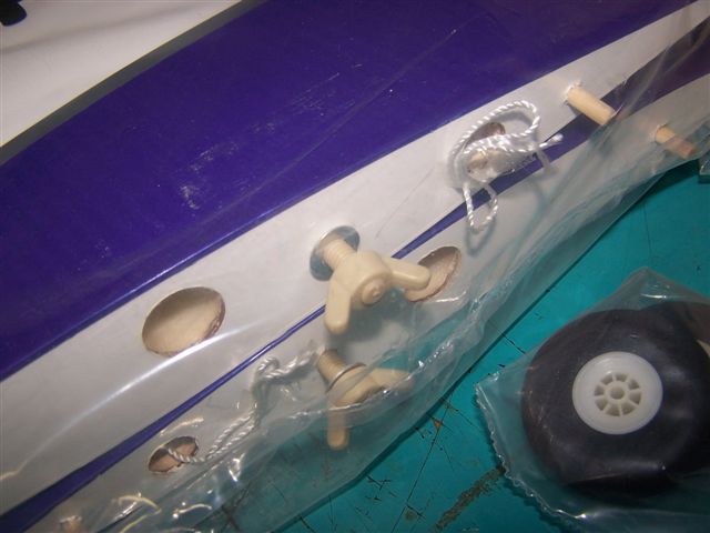

OK, just opened the box. I really love the quality of the hardware supplied with this kit. Also, with the Tojeiro-50 I was positively surprised, but this is better.
Pull-Pull for rudder, bell-crank for elevator. Real hinges! Oracover for covering. The wings are balsa covered foam, two piece. The fuse more or less ready for a pipe.
This plane will be powered by a APC 14x10, OS-91 FX with Merker pipe and a VP-30 pump. Really nice combo, I used this on my Fliton Infinity and it ran really well. The only thing I did not like was that with the Infinity I had the engine inverted (this one will be at 8 o'clock) and since the wing was only piece, I always had to take off the pipe. Now I can build all in very well, and should not be bothered anymore.
I also like the stabilizer which has a profile.
Here some pictures:

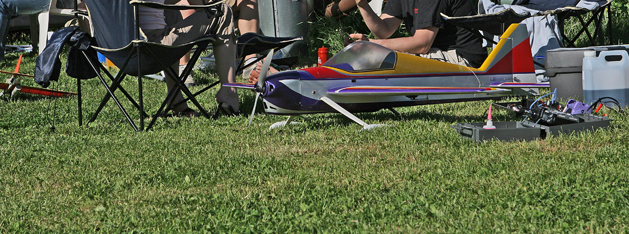

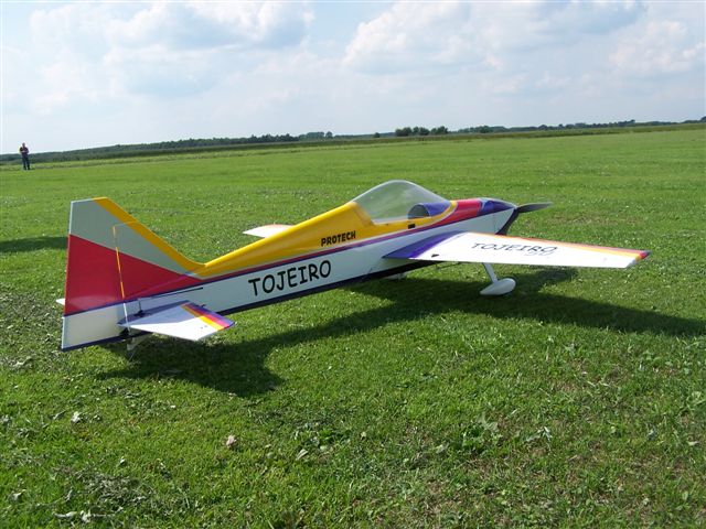

Here's a picture of my Tojeiro-50. It is powered by a Saito FA-82, APC 13x8. Weight 2.6 kg. Flies like the wind. I do expect the Tojeiro-90 to fly quite different due to its size and profiled stabilo.

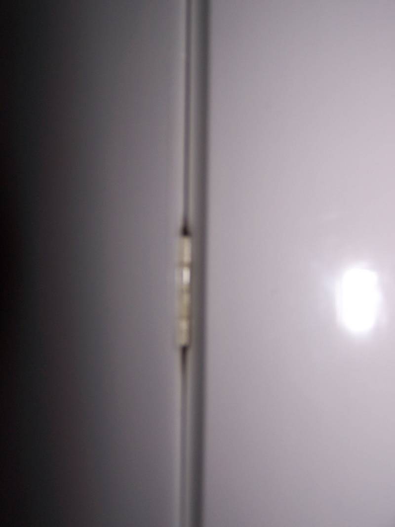

glued in the hinges for the ailerons. They are pre-cut, but I wasn't happy with the hinge-gap, so I recessed the hinges, for a minimum hinge gap. I have never sealed a hinge gap but I am thinking about it. Anybody with experience with this? Is this necessary on this size airplane?

I used clear Ultracote to seal my hinge caps on my Tojeiro 140. I use the same stuff to seal any hinge lines even on 40 size planes.

I seal gaps with the indoor foamy hinge tape. "Blenderm" is the real name I believe.

I'll be sealing those hinge gaps then! Thx!

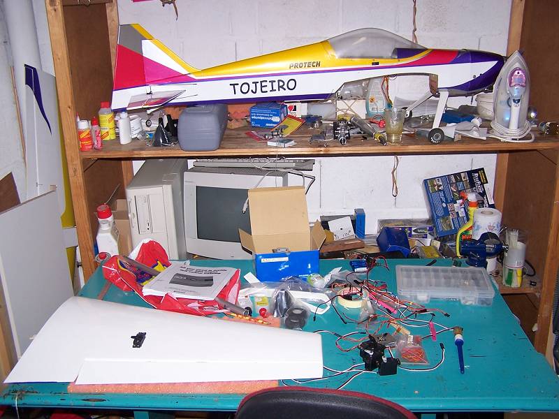

just to show what a mess it is today! Collected all electrics etc.
In the background you see my Tojeiro-50, which I use for winter flying. Weather is too good sofar, so I prefer to fly iso building!

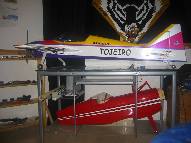

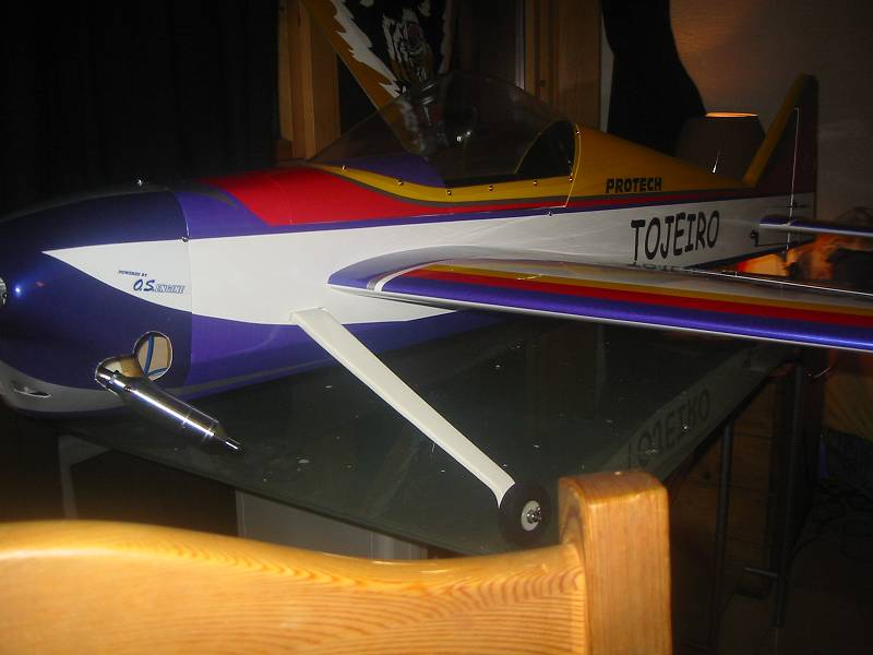

Here you have a few pics of my tojeiro 90, almost ready for its maiden
Happy new year btw:-)
