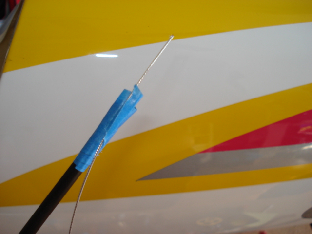

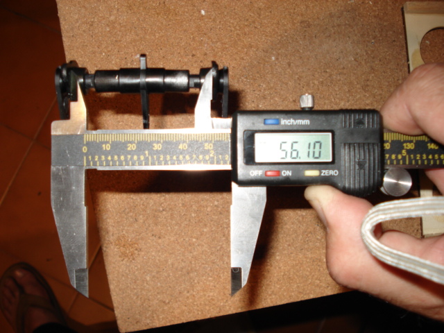

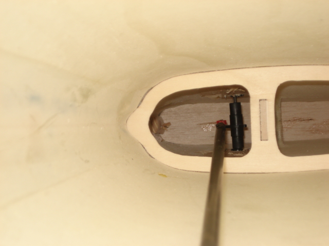

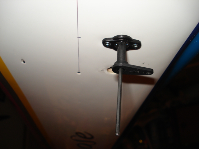

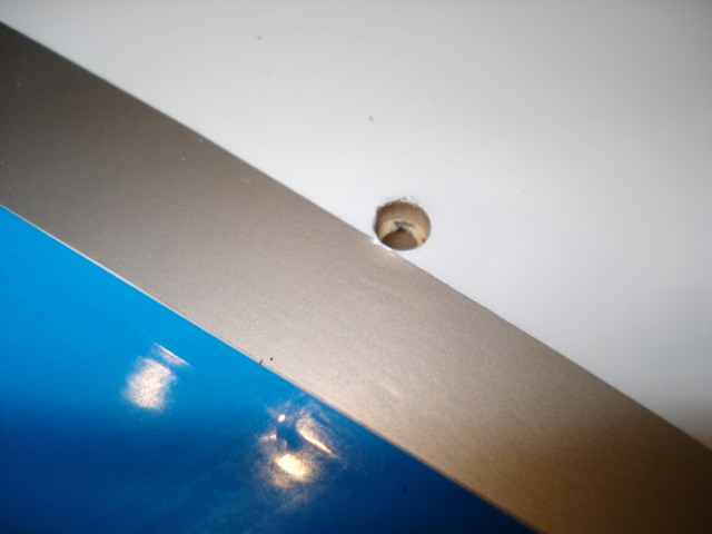

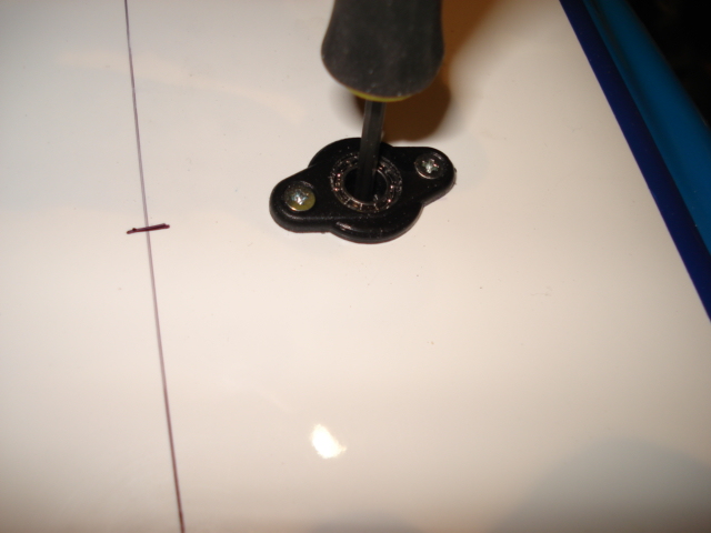

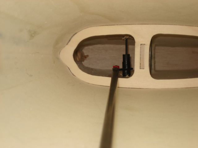

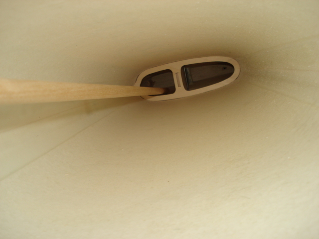

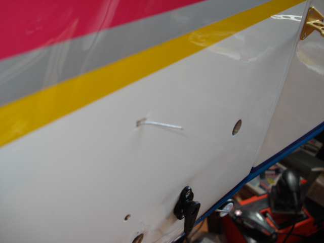

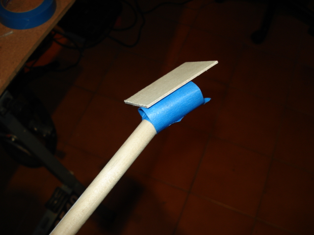

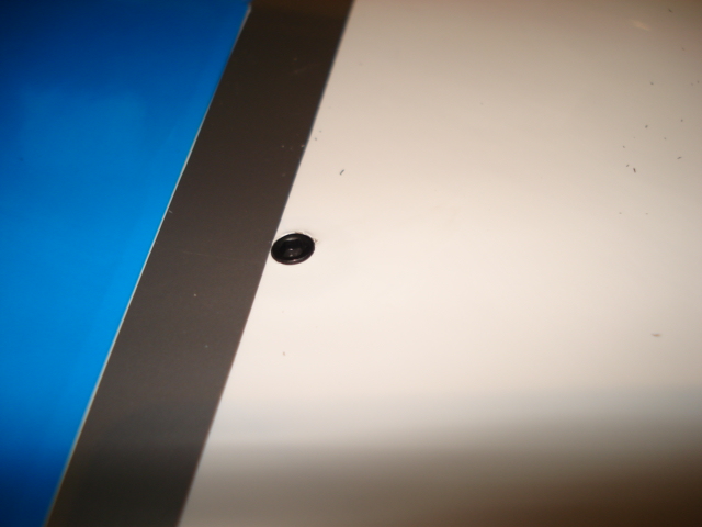

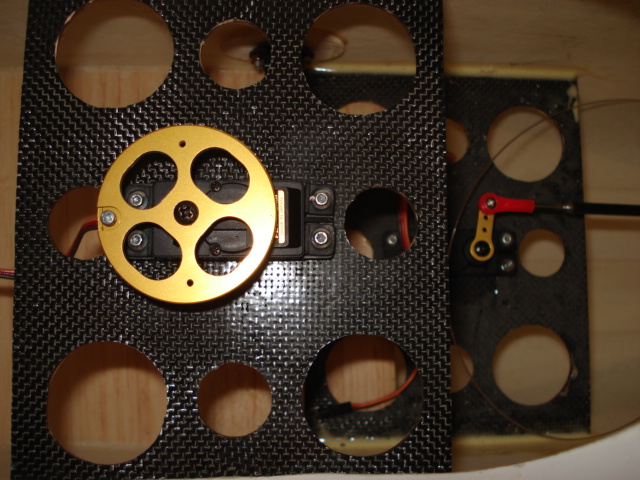

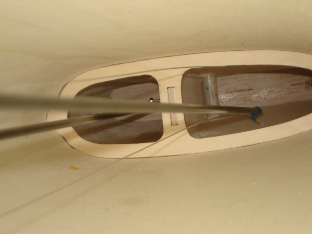

Some pictures of the airplane and assembly. Here is the installation of the MK bellcrank, I used this method because the rudder post is already installed and painted, very easy to do with masking tape. Note that after the bases with bearings are installed I just used a Allen ball driver to catch the bellcrank, then using the same slided in the outer horns. Also shown the holes made for the wing attachment, the installed dowel under the covering is easily visible, just drill the first hole for the 4-40 bolt then a little recess over the same bolt for the bolt head.
Regards

Here are pictures of the servos, I used only one 8411 for the elevator and the CH carbon rods with titanimu ends 3/16" dia., I laminated the ply bases with CF, also shown similar method to get the rudder cables installed.

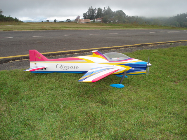

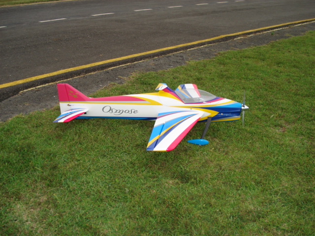

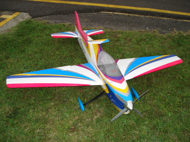

Pictures of the finished model.

Looks very nice, what is the final weight of the model with the YS-160 DZ etc?
The wings are not composite, typical foam construction covered with Monokote, right?

I didn't weight the airplane, it is very light, I ran to the field when I finished the model.
Wings are foam sheeted with balsa, covered in Oracover, very well done. The Deluxe version is all painted and Carbon/Kevlar fuselage.
The fuselage paint is outstanding and very light.

Hi Apereira
Why do you change position of dual coupler MK bellcrank ?
Is that you have too short ?
Claude
Old 09-01-2007 | 06:08 PM
  #163
apereira's Avatar
Joined: Jun 2002
Posts: 1,740
Received 5 Likes on 4 Posts
Default RE: CPLR new plane OSMOSE
I got the big one, but did not measured the fuselage right, it was around 3am I think, easy to fix, but I just put stickers so I could fly that weekend, but I left on a business trip[&o], it was compressing the fuselage a little bit and I did not wanted to have any stress in the structure.
