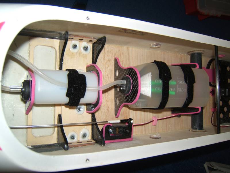

Anyone have any photos of how you mounted the fuel tank in this model ?
Or how you plan to ?

propnuter,
lay out of tanks.
