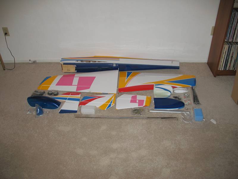

Ever since I sold the Groovy 90 3A to a fellow club member after my initial test flight, I had been contemplating on getting another one for a more thorough testing. However, after a short discussion with my good friend Fai Chan - one of the owners of World/ Airborne Models - he convinced me to try one of their latest pattern offering - the Spot-On 120. The plane came in two different sizes, the 50 and the 120 size which retailed for $399.99. However, if you are a current NSRCA member, Fai will extend a 10% discount to you. Since I have a refurbished YS 140L sitting on the shelf, the 120 was an easy decision.
The construction of the Spot-On is almost identical to the Groovy - an all wood design with most of the surfaces including the trim pieces covered with World's very own "ToughLon" coverings, including the belly pan. The exceptions are the top cowling and the bottom chin cowl, which were both painted. I was having some problem on the Groovy with the trim pieces peeling off before assembly, but found the Spot-On a much better finishing.
Similar to the Groovy, the Spot-On came well equipped with the following accessories - spinner, fuel tank, aluminum stab/ adjuster tubes, carbon fiber gear, wheel pants and wheels, push rods for all moving surfaces, horns, clevises, an assortment of screws and their very own anti-vibration engine mount. The wing is a one piece design, therefore, no wing tube required.
Since I have had prior experience on building the Zen III and the Groovy 90 3A, I think the Spot-On 120 will be finished in no time. Of course, procrastination is always a big obstacle. Stay tuned ...

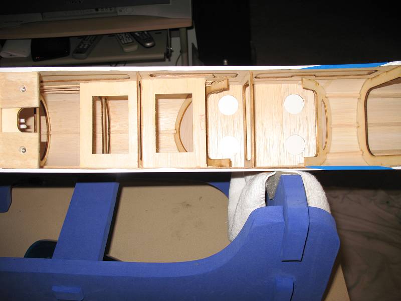

May I ask where you got the blue cradle?
David
Old 05-09-2007 | 12:49 AM
Joined: Feb 2004
Posts: 796
From: Oakland, CA
Default RE: World Models Spot-On 120
Airborne Models... blue color. It says "plastic" but it is made out of foam.
http://www.airborne-models.com/html/...sp?AGroupID=15

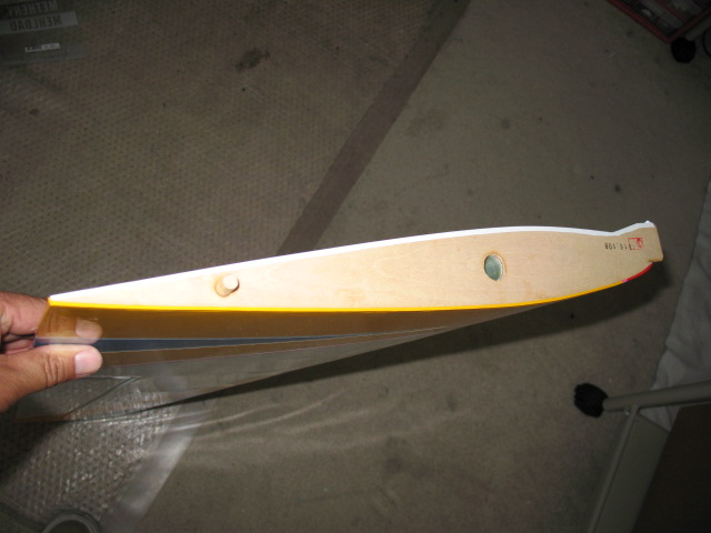

Adrian, if I may---"Airbone Models" on their web/site says "Plug-in rib wings" & a phone call confirmed this (two-piece wing with tube mt.)---can you clear this up please?---
Ed

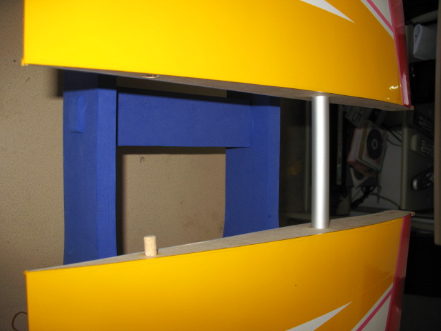

ORIGINAL: tande
Ed
Ed, if you examine the pictures Adrian posted in first message here, it shows a fuselage with the wing saddle showing as well as the 2 wing halves which I assume need to be joined at the center section. Looks like it ends up being a one piece wing after assembly.
Woodie

ORIGINAL: tande
Ed
From the pics of the fuselage it looks like a one piece wing - but looking over the other pics it looks like a 2 piece wing - perhaps they are joined with a wing tube and mounted like a one piece wing?

ORIGINAL: woodie
ORIGINAL: tande
Ed
Woodie
Wow Woodie, You're the man.
That's right. It has a wing joiner, and you need to glue the two wing halves together to make it a one piece wing. See pix below:-

ORIGINAL: riot3d
With that setup I can't see a good reason to actually glue the wing halves together, unless you like transport problems and hangar rash from storing a big one piece wing.

ORIGINAL: mmattockx
ORIGINAL: riot3d

ORIGINAL: riot3d
I have been flying my Astral with a one piece wing without any transportation problem. Besides, I don't see how you can fly a one piece wing design without gluing them together. As a matter of fact, the World's instruction manual specified that if wing halves were not properly joined and glued, failure in flight may occur.
As for hangar rash, a simple wing cover will solve the problem.
Your choice. Gluing them does nothing but keep incidence alignment between the halves. All the bending loads are carried through the tube. I might add a second alignment pin in front of the joiner tube. The two wing mounting bolts will hold the halves together and if that worries you, add a simple bolt to clamp the two halves together as many do with typical two piece wing aircraft. I would find two wing panels of less than 36" length much easier to deal with than the one piece version...
