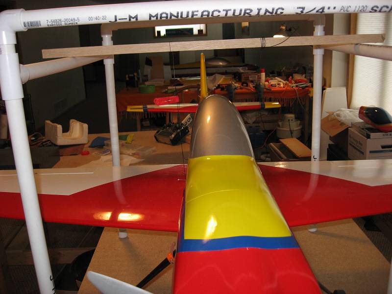

Yes a good CG tool is worth the time. It gives the base line to start the trimming process. 10 dollars spent on PVC pipe and fittings you can make a nice cg stand.
The ply wood you can see has holes drilled at the CG point. The ply wood has clearance holes for the wing tube and alignment pin.
Hope this helps Mark

Just a quick question - I thought one has to measure CG of mid and low wing planes upside down. That is a mighty interesting stand yuse made up - I use a T/F CG machine myself.
Ok - another question or rather information - what plane am I looking at - it looks very good.
thanks, Greg
thanks, Greg

Greg
The CG can be measured with the plane up side down if you like. The CG is at the same point on the wing.
The Plane is a Smaragd ds/dt. Smarargd Fuselage with a Platform modified Temptation / Phemon wing. The Rudder and Fin is changed. Stab is Temptation.
The Plane fly’s very different than the stock Smaragd. Better I think. More crisp snaps and the plane tracks better.
