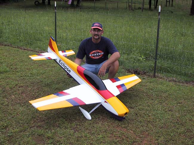

Old 05-06-2003 | 09:20 PM
  #44
Posts: 540
From: Guntersville, AL
Default CA Model's Eclipse Kit
Need some digital servos, new receiver, and a motor now!! Thats gonna hurt.
Old 05-06-2003 | 09:22 PM
  #45
Posts: 2,504
From: private, FRANCE
Your right, its too much. Ditch the plane...in fact, I'll pay shipping...I'll PM you my address now.
Old 05-06-2003 | 09:23 PM
  #46
Posts: 2,504
Oh, lookin good BTW.....Nice Job, well done.

Old 05-06-2003 | 09:34 PM
  #48
Joined: Mar 2003
Posts: 69
From: USA,
Looks great GW!
Old 05-06-2003 | 09:36 PM
  #49
Posts: 540
Thanks for the kind comments guys.
Old 05-07-2003 | 09:29 PM
  #50
quist's Avatar
My Feedback: (198)
Posts: 3,327
Received 9 Likes on 5 Posts
From: Glendale, AZ
Gerald, That looks AWESOME. I have an ARC and still have not touched it yet.
