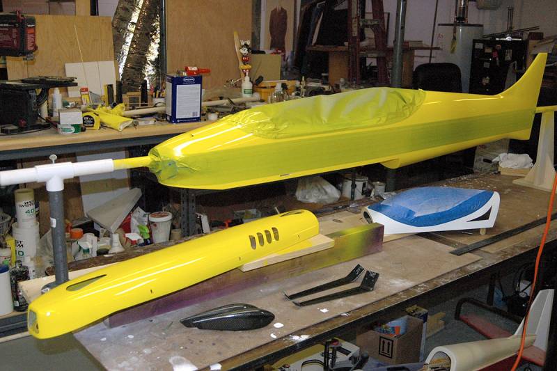

HI All,
Here is a quick update, my wife and I have had our moms visiting with us for the last 3 weeks. The little shop time that I've had been spent painting that other plane (the v2.2). Our mom's are leaving next week and I'll be back at it on the build thread.
I did manage to trim out the cowling. What I do is mark about a 3/8" lip around the bottom opening and about a 1/4" lip around the front opening. Use the Dremel Tile Cutting bit. It's a very course cutting teeth and really does the best job on the s-glass that Mike uses on these cowls. I finish off with the 1/2" drum sander.
On the bottom opening leave a band across the back of the bottom opening, that will help in fitting the cowl from distorting when fitting it to the front of the fuse.
I'll be doing the DEPS installation and buttoning up the fuse asap when I get some time, next week.

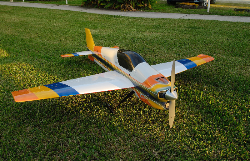

Well, My VF3 flew this afternoon, had a dead stick first try due to new motor and rich mixture, second fly went ok but still rich. Third flight was the charm with motor running great and the plane felt good. Going to get a few more on her Sat. and alot more on Sunday!! Here is a few pictures of her at the field today. Thanks for the help Billy and if your a good boy I might let you fly her, ha ha. Hope to fly her and show her off to the D3 gang at Billy's contest next weakend. Hope to see you Mike if you can make it but I know you have family obligations and might not get down here. I will try not to crash her before the dist. champs so you will get to see it there. Thanks for the help Mike and it was a joy to build and fly it, something satisfying to start with a butt load of wood,foam and some molded parts, two and half months later have a nice plane up in the air.
