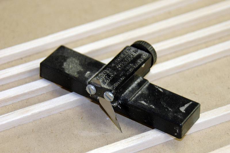

When using the balsa stripper adjust it to make perfect 1/4 square stingers. Use one of the formers to test the stingers in the notch. Tab the former into the fuse side and check the fit. Small adjustments to the stripper can make a huge difference in fit. If anything you want the stinger to be just a bit too big than small.

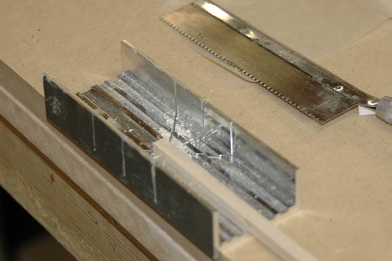

Next using the 45° miter box and razor saw, cut 45's on one end of each stinger, using a 72" straight edge as a guide, butt glue 2 stingers together to form a 72" stinger.
When selecting the stingers to glue together, select good pairs and glue the straighter ends together.

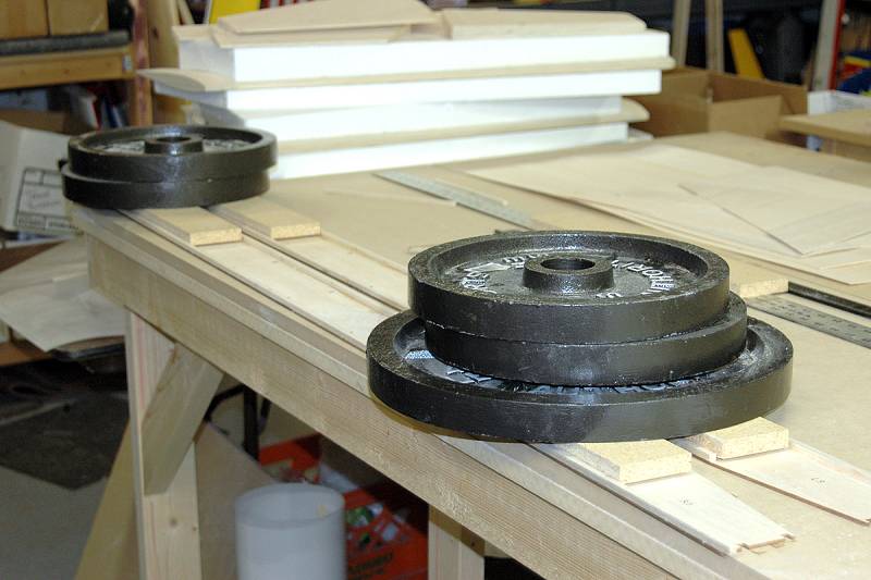

Once everything is prepped, I mix up a small batch of West Systems epoxy with either the 206 or 205 hardener - http://www.cstsales.com/west_system_epoxy.html . I coat the front of the ply firewall and place it on top of the prepped side of the carbon plate, I then coat the backside of the ply firewall and place the balsa doubler in place - I then run a bead of epoxy around the edge of the ply donut and slide that into place. Wipe any excess epoxy away.

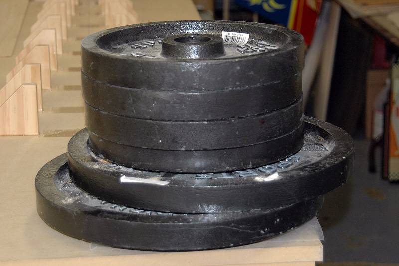

I lay a piece of wax paper onto of the stack and put 150-200 lbs of weight ontop while it cures overnight.

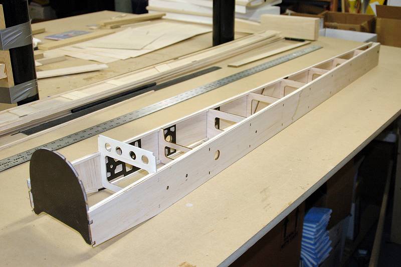

Here is the finished firewall. I left the carbon plate covering the stringer slots, this makes for a cleaner look. Shaping the carbon is easy with 150 grit paper on a block. At 65 grams this works just fine.... next step is to mark and drill holes for the blind nuts. I lost .2 gram after trimming the carbon from the firewall, using 200 lbs in the press helps put the squeeze on.

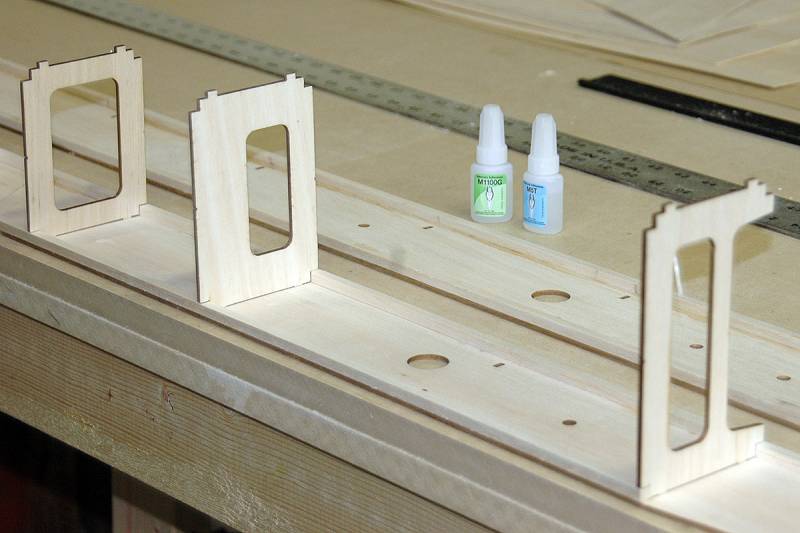

Now let's glue the fuse fore/aft sections together. The aft fuse sections are identical and the fore sections have the right thurst built into their respective lengths. what I do is fit one side together and strap a piece of 2" wide masking tape pulling the two pieces together tightly. Flip the fuse side over and tape it to the edge of a 72" straight edge. position the tape so that it pulls the sections towards the center.

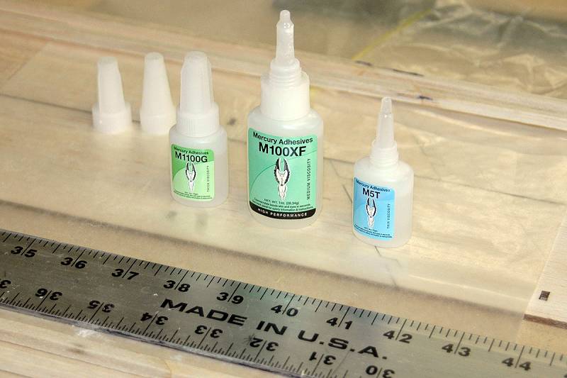

I have starting using Mercury Adhesives CA for this build and I do recommend these products. These CAs are different and better than any other CA products that I have used in the past. This stuff rocks.
I just hit the seam with thin ca and yer done, then block sand the sides flat across the seem with a large block just enough to make a flat surface for the doubler.
these pictures say it all.

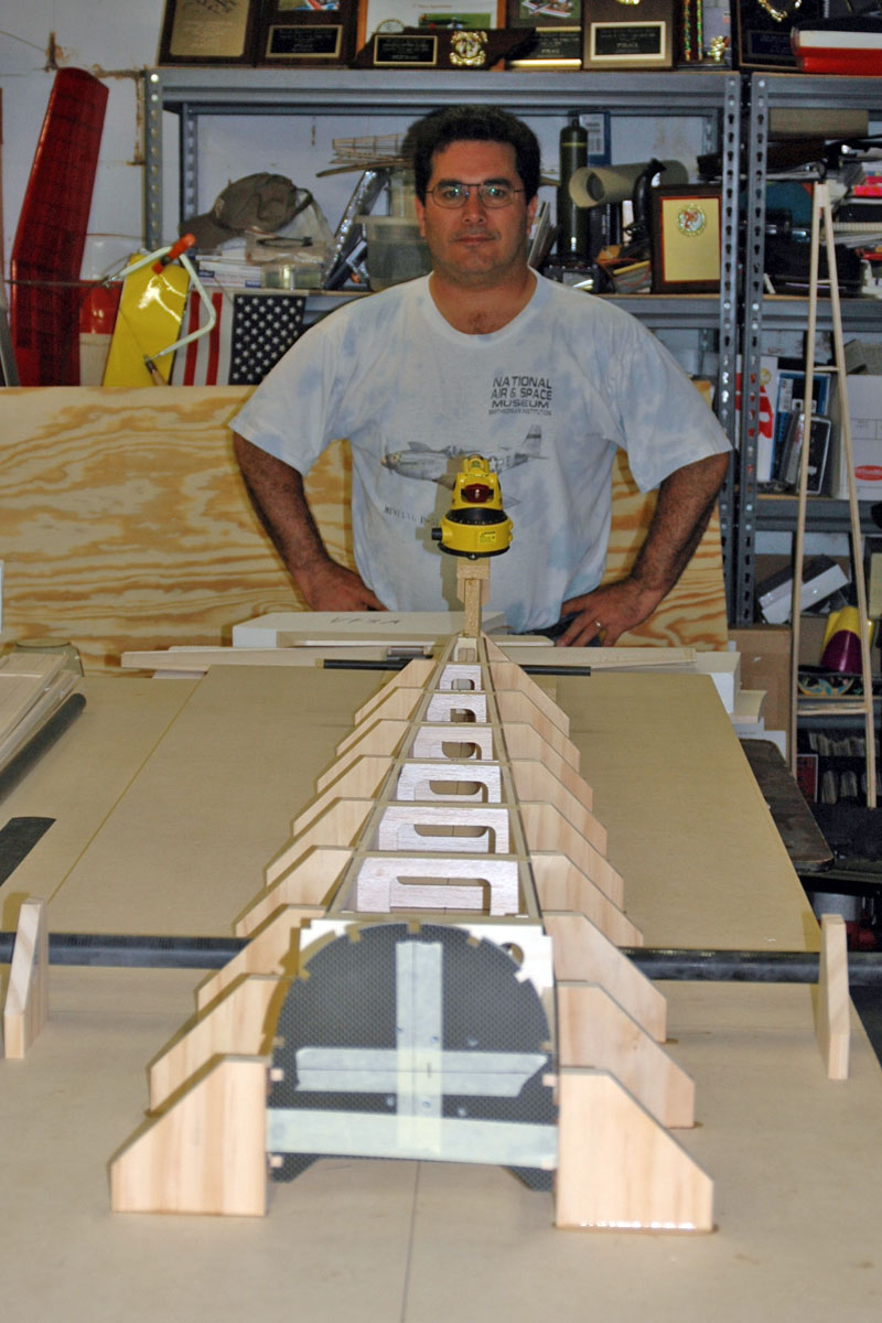

I will outline the construction of my fixture jig shortly, and sorry it doesn't come with the kit. If you would like to build one of these the cost is less than 20 bucks for the materials and I could cut the stations and tail blocks for you at a reasonable price.
I would also recomend Pete Cosky's jig at http://petesrc.home.comcast.net/ Mike uses Pete's jig and will be outlining that on the electric thread.
stay tuned we are about to get the fuse in the jig
Thanks!

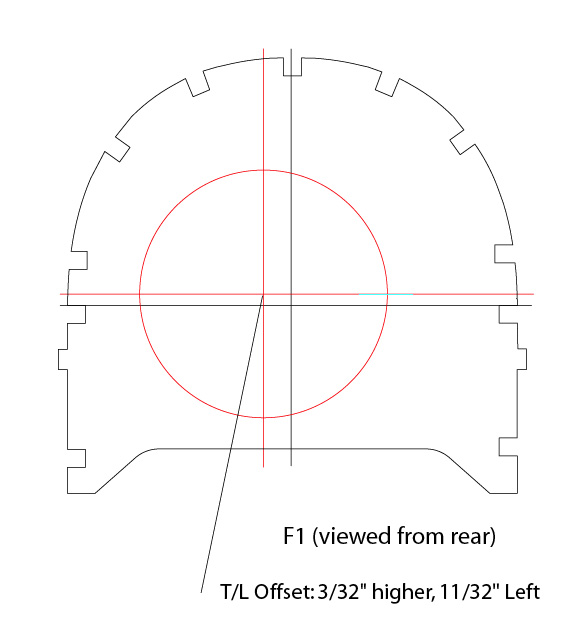

Let's mark up and drill the firewall for the Hyde mount - Mike designed this plane around the Hyde AR-80 mount and strongly suggests "no substitutes". But any mount can be installed as long as you can fit it within the 6 3/8" between the firewall to spinner back plate. I learned this the hard way when on my first VF3 build I tried to install the high dollar Hyde ARIA-S mount which is about 6 5/8", yea that won't work...
The first photo is of the firewall from the plans indicating the proper position for the mount's center line. I created a template from the actual mount, taped it to the firewall and drill for 6/32 blind nuts. Just double check everything before drilling. There is critical alignment between the engine mounting position, cowl, and chin, there is a lot going on here so just take your time. When we mount the cowling you will see how that all fits together.
Don't worry if you mess up the position it's easy enough to plug the bad holes with dowels and epoxy and re drill, so don't stress to much.

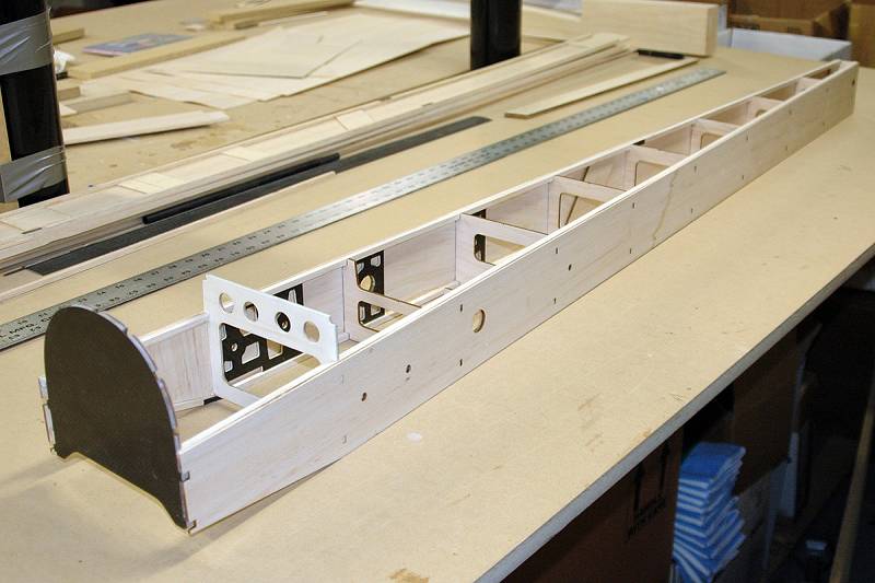

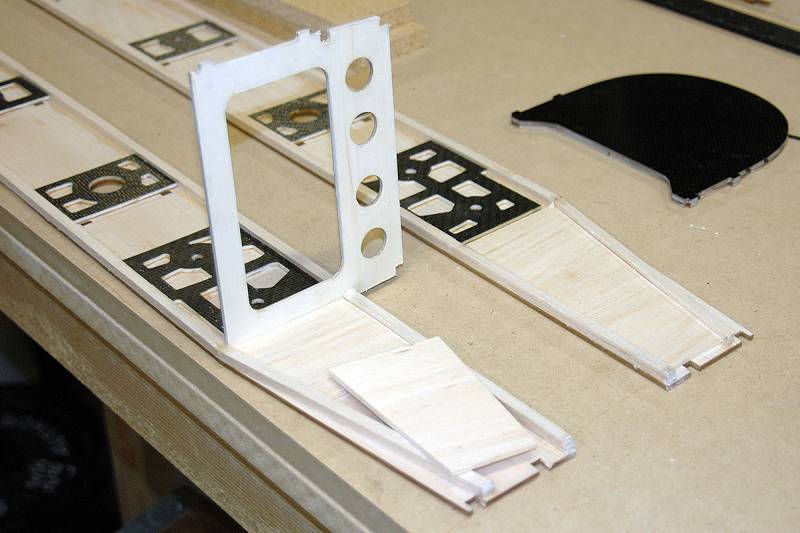

Now lets glue on the stringers to the fuse sides you just made.
First you want to identify the left and right fuse sides, note that the right fuse side is shorter in length due to the right thrust. Mark each fuse side on the inside with a "R or L" just so you don't glue the stringers on the outside, you want to glue the stringers in place on the "INSIDE" of the fuse sides. Position the stringers so the spliced section is between f6 and f7. What I also do is tab in the formers into the fuse sides to act as a positioning guide for the stringers. The upper stringer extends all the way from the tail post to the firewall, the lower stringer gets cut at f2 and angles up to the firewall, again use the firewall as a positing guide for that lower section of stringer.
I tack glue the stringers in place around the formers, than remover the formers and wick thin ca to complete the gluing step.
My Feedback: (23)

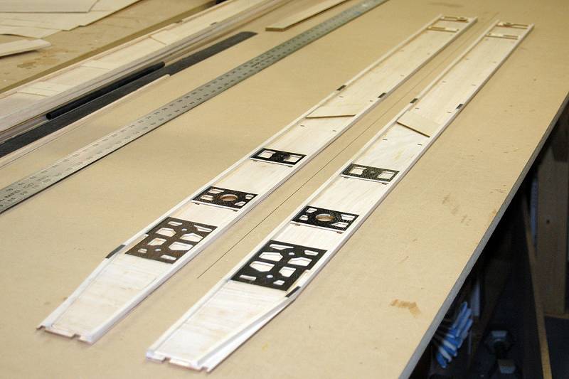

Let's install the fuse doublers.
Test fit the 3 forward doublers and prep sand and fit into the fuse sides. Test fit the rear doublers for the Stab tube and forward stab adjuster. On the stab adjuster doubler mark and drill a 1/8" hole for the adjuster wire. I use the stab root plywood plate to position the stab adjuster doubler. Note here that the hole through the stab root plate is offset and the hole is above center. Cut and fit the 1/8 balsa vertical grain doublers that extend form f2 to the firewall, leave a 1/8 gap at the bottom for the flooring and fit it to the rear of the firewall.
Once everything is fitted I mix a small batch of West Systems epoxy and spread a thin layer with an epoxy brush, I usually cut the bristles of the epoxy brush down to about 1/4", you will be able to spread a neater thinner coat of epoxy that way. I actually position the stab adj. doubler with the wire and tube in position as I lay it in position with epoxy. Work you way up the fuse epoxying the forward doublers in position, use the formers again here as positioning guides to get a tight fit. Do both sides and lay both sides up together with weight. I cut small planks of MDF or partical board and stack my weights across both sides. Again use all the weight you have on hand, also wipe away excess epoxy. Let this cure overnight.

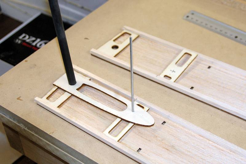

Okay once cured drill out the stab adjuster rod holes through the blasa fuse sides with an 1/8" bit - we are currently using the Gator style stab adjusters.
Cut 6 1/4 x 1" strips of .007 carbon I get my carbon lams here - http://www.cstsales.com/carbon_Laminates_36.html CA these across the 6 splices in the 1/4" balsa stringers. Use Mercury's High Performance CA M100XF - this stuff is designed to be used with composites. Fit and trim the 1/8" blasa fuse side splice doublers and glue in place - I use med or thick ca and again Mercury products really work well.
Once you have the carbon strips and balsa doublers glue in place you can trial fit the entire fuse - you can see at this point a jig is not really necessary. There is a slight inward bow between f2 and the firewall but the rest of the fuse is a straight taper.
The final step is to true the edges of the fuse sides. Which is done by edge sanding with a large block sander. What you want to do here is to sand the stingers flat to the fuse edges. Do this by just sanding the stingers down until you start sanding off the laser burn off the balsa fuse side, when done you should have trued sides.
At this point your ready for the jig.

WOW -
I started this thread about 24 hours ago and we have 500 hits. I hope you guys are enjoying this effort and are thinking about your builds.
I logged less than 3 hours to get to this point in the build, with one overnight cure. You all can see that the VF3 builds fairly quickly and easy. The fuse sides and firewall are a few of the most critical parts of the build, once we get the fuse glued together in the jig the rest moves really quick. If your ready to jump ahead at this point you can follow Mike's work on the electric VF3 thread where he sheets the turtle deck and belly. I will outline how I do the sheeting next and setting up a fixture jig.
But from this point on you get the most building satisfaction from your efforts, this plane builds fast and BIG.

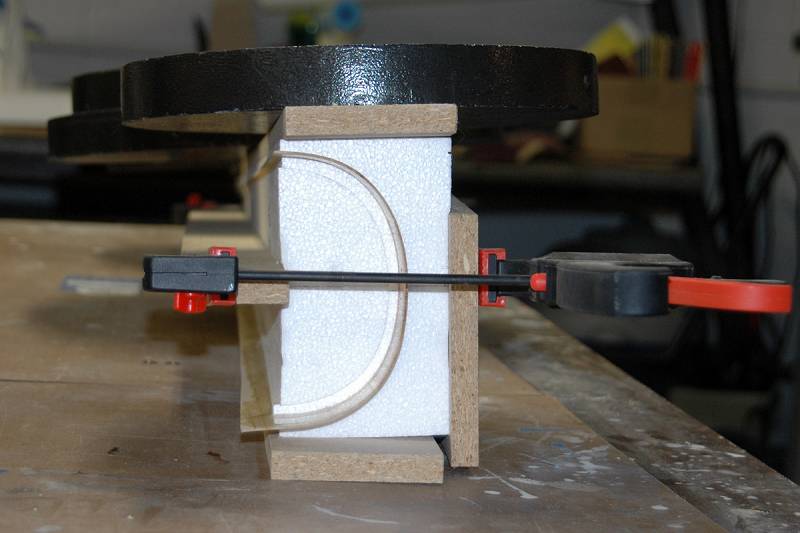

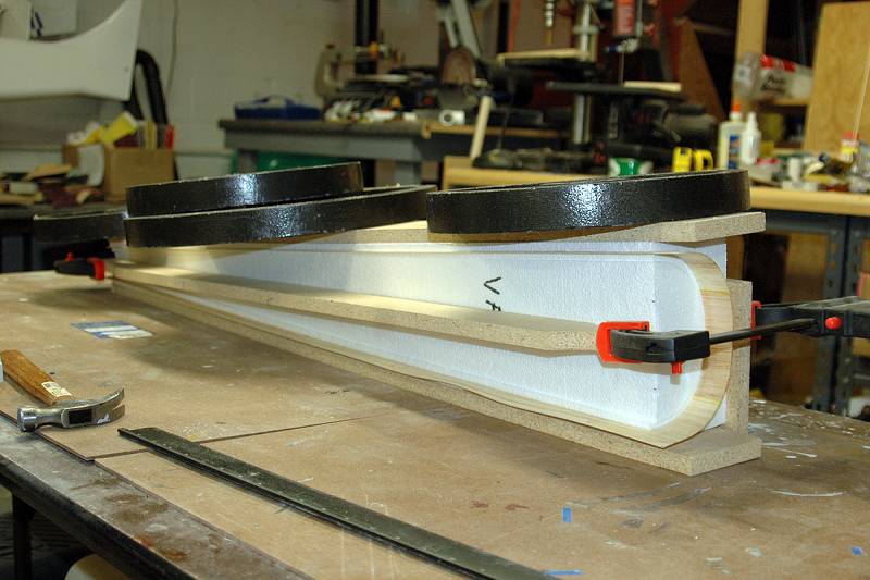

Okay guys next we are going to sheet the turtle deck and belly cores.
Using nice and lite 12 gram 1/16x4x36 and 18 gram 1/16x4x48 contest wood, assemble the sheeting panels per Mike's plans. First true the edges by triming with a #11 blade. If your careful and hold the blade at a 90° to the sheeting your ready to go, if not you can make a 90° edge sander from home depot shelving material and stick on sandpaper and sand those edges true. It's not really necessary if your careful with the blade.
Using blue painters masking tape, put together the panels per Mike's drawing. I tape across the seems with small bits of tape to pull it together, then run a long strip of tape along the entire seem. then using white Elemer's glue and a glue syringe run a tiny bead of glue inside the seem. What I do here is to open the seem up by running the seem along the edge of your workbench and folding one side of the panel down. Once you apply the glue, lay the panel flat, wipe away excess glue with a damp towel, lay a piece wax paper on top of the balsa panel and place a large flat surface on top of the stack, I use a piece of MDF board trimmed to size. I then generally place about 50 - 100 lbs on top of the stack just to keep it flat. Let this dray overnight.
My Feedback: (23)
Now prep the cores by lightly sanding any ridges flat and removing any melted foam bits. Just try your best to make the surface smooth without distorting the shape. No big deal here, just take your time with 150 grit paper. Towards the aft sections of the cores there might be slight ridges, there is a lot of taper to these cores and that is to be expected.
Prep the sheeting by lightly block sanding the sheeting flat, you just want to level the wood across the seems, mostly on the outside, I usually run the side that I taped to the outside as it may be flatter across the seem and cleaner. I run the side I glued against the core. Next take a can of hair spray, I use the cheap 99 cent White Rain brand. Spray the side of the sheeting you are gluing, do a solid coat maybe even two coats. When dry your ready to spread the laminating glue.
I use West Systems epoxy to laminate the sheeting to the cores, Mike talks about using elmer's ultimate polyurethane glue for the sheeting in his electric thread. I haven't used the polyurethane glue yet, it may have an advantage as you can spread it a bit thinner and it expands as it cures.
What I did here was to mix a 18 gram batch for the turtle deck and a 22 gram batch for the lower belly sheeting. Using a business card spread out a thin layer across the sheeting. Leaving a slight thicker bead around the edges. If your sheeting is stiff, you can do the water/ammonia trick on the outside surface of the wood to make it more flexible. Slide the sheeting wood into the shuck and position the core with the inner chuck into the outer shuck. At this point you need to make sure you have full contact around all the edges and that the shucks are tight around the crowns. Using weights, poster board, large levels etc. just position things so there are no gaps.
The large 48" belly can be a beast, I made a jig out of particle board that holds the shucks together tight, these photo's show my methods, experiment with what you have on hand. Using slow set epoxy helps give you the time to make adjustments if needed. I've got 150 lbs on that belly core, it came out nice and true. And the edges where sealed and attached well.
What is cool about building these planes is there are many methods, lots of different ways to do the same thing.

Let's talk about assembling the fuse.
You have a number of options, Mike designed the fuse to be built flat on the work bench with just a straight line down the middle. Use a 72" straight edge and a sharpie. Tape the straight edge down to the workbench and run a line the length of the edge.
The picture of the fuse here show the fuse held together by tape. There is a slight inward bow between f2 and the firewall. All this can be accomplished with masking tape.
To assemble the fuse you need to install all formers the front flooring between f2 and the firewall and the landing gear block at the same time. Use CA for the balsa formers and slow setting epoxy for the firewall, the front lower flooring, the landing gear block, f2 and the tail former f9.
If using this simple method I would place weights on top of the fuse to hold everything in place while the epoxy cures. It would also be important to make sure your fuse sides are very flat. And since we are using only top quality contest wood that should be a problem.

The method I am using for the VF3 is the fixture style jig. Which can be made for less the $20 in materials. It takes about the same amount of time to assemble the jig as it does to assemble Pete's jig. But you need a table saw and maybe a table router to make the stations.
As with anything there are a number of pros and cons regarding the fixture style jig.
First the cons:
1. The jig is purpose built and will only work on one fuse design.
2. You need a table saw to make the stations.
3. it's a lot of work if your only building one or two fuses.
The advantages:
1. Once the jig is built there is no jig adjustment and alignment time - (which could be almost an hour of time to adjust all 20 station arms and to make sure your datum and right thrust is correct.)
2. You are building right on top of a hard datum line.
3. Your thrust angle is built into the jig.
4. If your building more than one fuse, you are assured that you will have perfectly matched fuse crutches.
5. You can easily align wing and stab tubes in the jig.
6. Once your fuse has cured it easly slides straight out of the jig and your ready to build your #2 fuse in about a New York minute.
