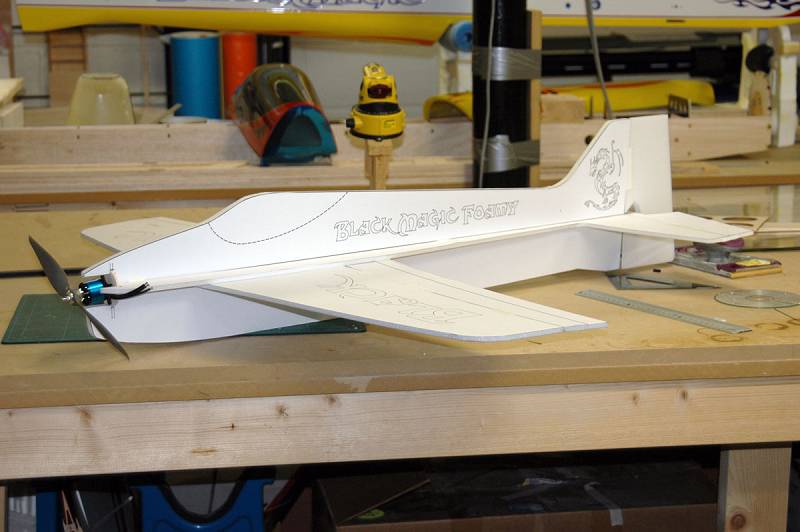

HI All,
Well I am slowly getting back into the swing of things around here. I got to do my first pattern meet in 2 1/2 months this past weekend, without any practice, flew well and had a fun time in Jacksonville. Those Jacksonville guys, Billy, Patrick, Brian, Rufus put on a great meet, I did have a blast. thanks all!
Well I've been working on some drawings for a VF3 foamy. Here is the plane fitted together. I'll get the spars and everything glued together soon. Should be fun. We are having our D3 Districts Championships in two weekends and I hope to spend as much time until then practicing. I'll be working up the rest of this build shortly after. I hope to be able to paint my two VF3 in the next month or so. The V2 is painted, I need to do a little touch up on the clear, I had to sand some bugs that face planted in a couple of spots but it's basically done and ready for monokote and final assembly.
So stay tuned, I know a few of you guys are getting started build but I expect the majority of guys out there are still lining things up to start their winter projects.
cheers, dean

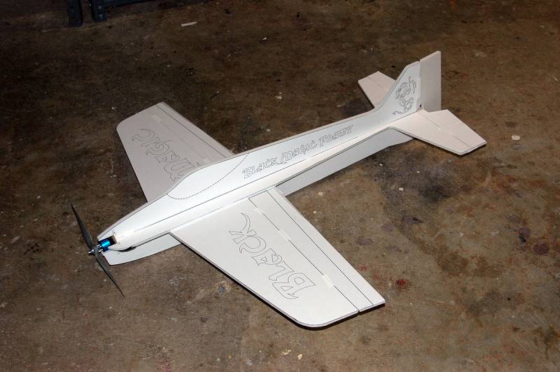

I know, I know..... but I can't help it.
good news my #2 VF3 build fuse is almost complete and after the cajun nats, I'll get busy with the write ups. I've got the fuse done to the point of aligning the wings, which means I only have to do the lower cores and blocks, and glue on the cowl - but it's moving forward after my long break from the shop.
so here is my second version of the VF3 foamie, On #1 I tried some stiff but heavy 10mm depron on the fuse and some heavy pushrod guides etc.... It did fly well but with the weight at 16 oz it didn't 3d well.
on the v2 version I've enlarged the elevators and rudder, went to a 6mm depron fuse and the basic airframe is already 1 3/4 oz lighter. I'll be going with a smaller esc, and a smaller rec. so I am aiming at less than 14 oz RTF. It's a big foamie with a 39" wing and fuse.
Should be flying it at the Cajun Nats....
