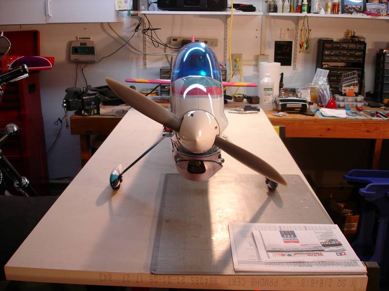

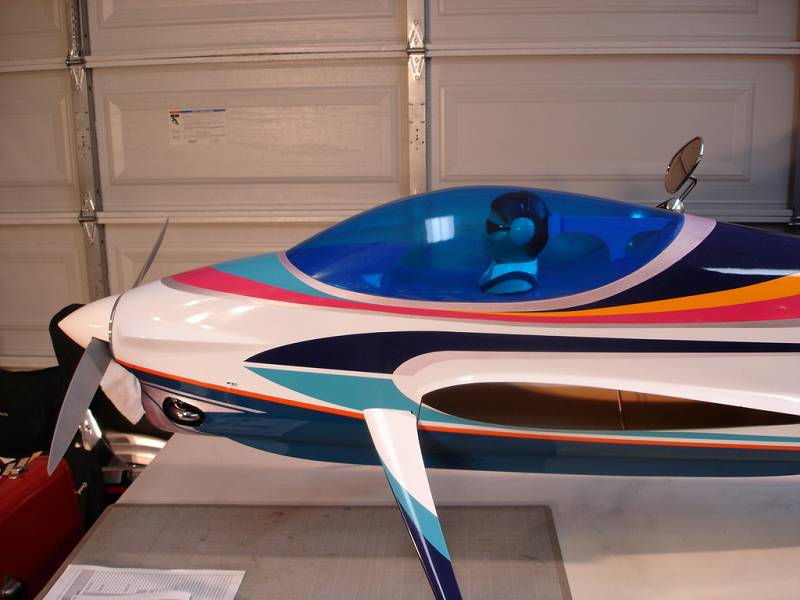

Default RE: Extreme composite Pro-Line
My ProLine is finally finished - yes, I'm a very slow assembler. Weight on the plane is 4880g. Fuselage weighs 3800g and the wing weighs 1080g. I have one 4 cell 1500mah Nicad RX pack in there now which I'll be changing to 2 1100mah LiPo's with 5.1v regulators on each with the addition of another switch.
Equipment is as follows:
YS 170DZ
Akiba mount
Futaba equipment - 9154's on aileron, 9602 on throttle, 9151 for elevator and 9255 for rudder
Hatori 823 header and short Hatori pipe
Attached are some pictures...

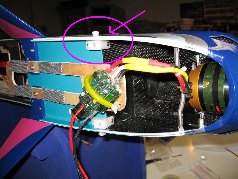

Hi Guys,
Anyone know where I can get a set of these. I prefer these over the release latch on my proline.
