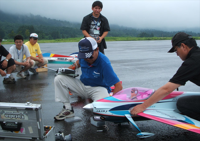

Does anyone know if the Extreme composite proline is going to be used in the World championships in Argentina next month?
Can anyone tell me if Akiba is using an ARF here? and where do i get one of those gorgeous minimalist transmitter trays he has.

Doubtful. I'll know in a week.

Riot is using the Akiba version of the ProLine - not the Extreme version. I suspect that there won't be an Extreme version at the WC... since they were just released - 1st in the Japanese market and then in the US.
