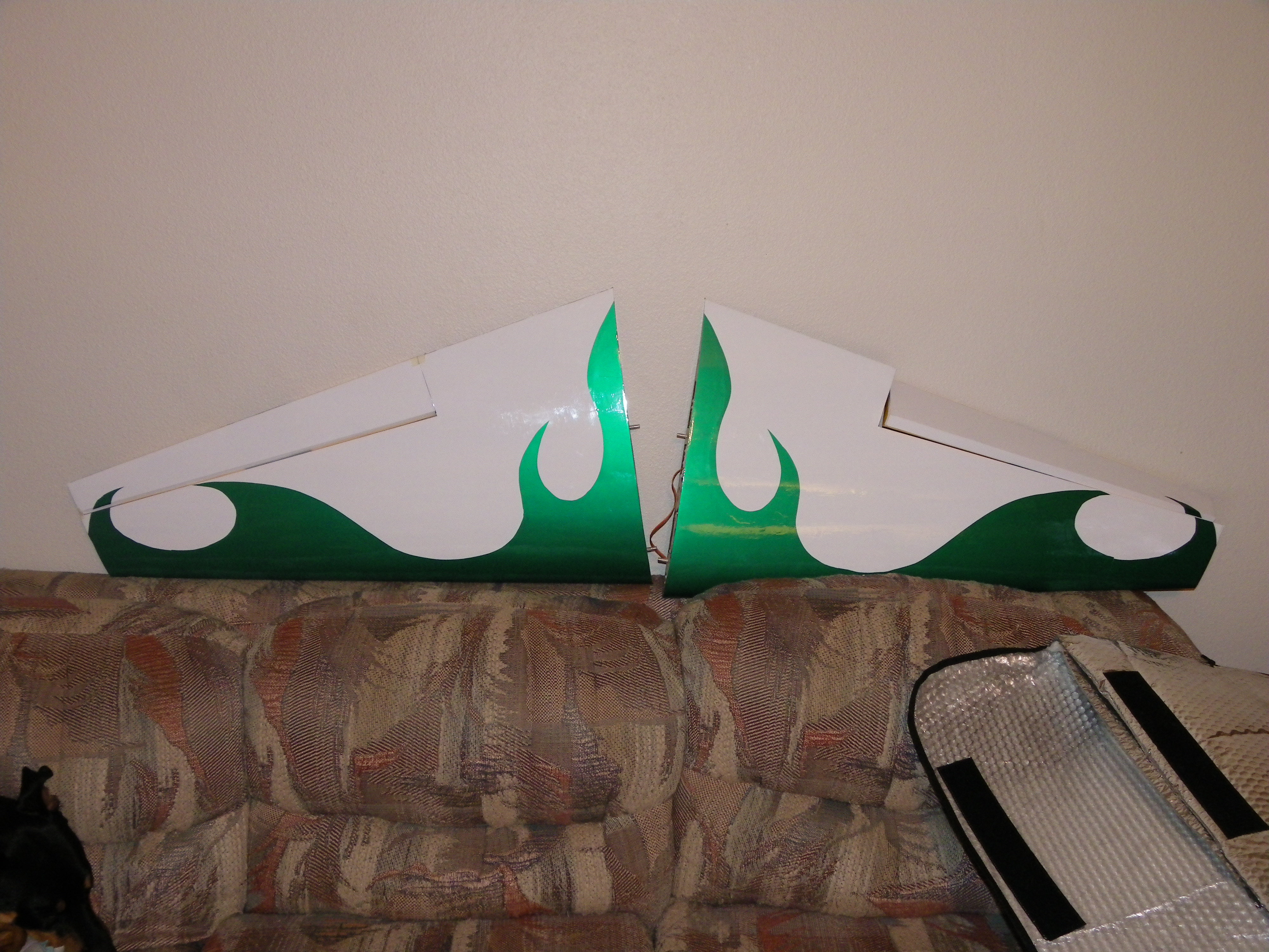

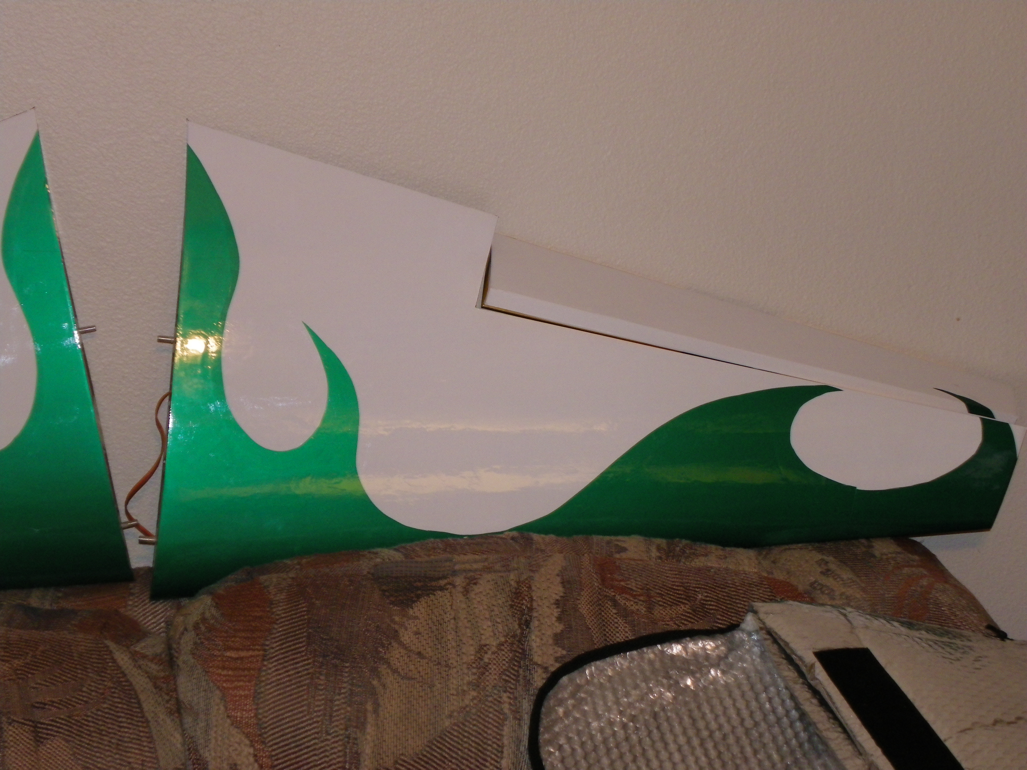

Been working pretty steady on the plane.
Wings are done.
14.2 oz RTF per panel.
Enjoy!

Why are there two sets of pins in each wing panel?
I'm new to pattern and am just looking for a brief explanation.
Old 04-11-2010 | 10:57 PM
  #82
RC_Pattern_Flyer's Avatar
Joined: Aug 2004
Posts: 1,119
From: San Antonio, TX
Default RE: Pentathlon Kit Build
Initial design has two bolts to secure wing to plane. one of these will be removed.
thanks,

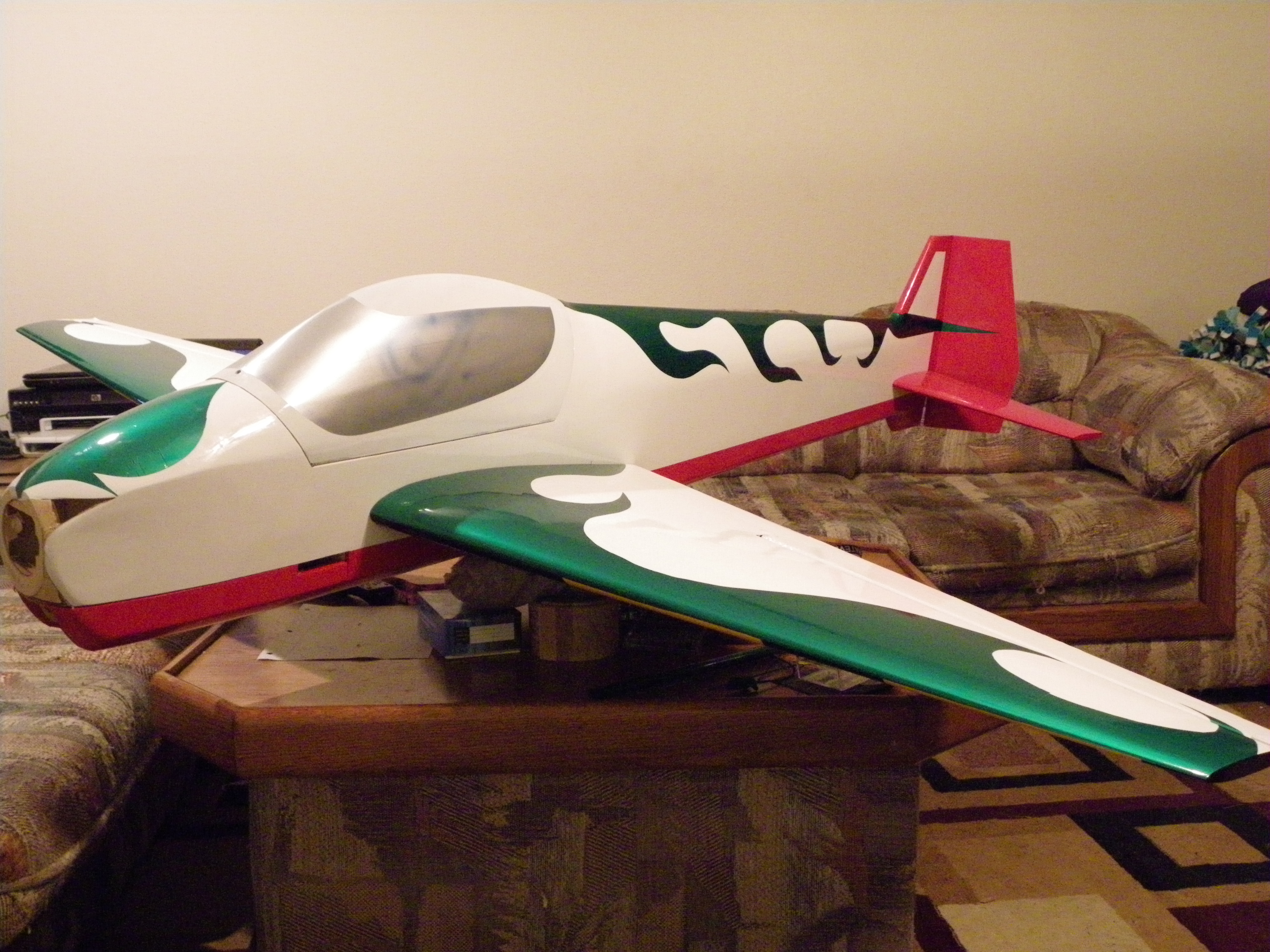

Been busy this evening. started with bare fuse 4 hours ago, printing shirts and covering planes... hmm forgot the beer
must be why i got so much done!

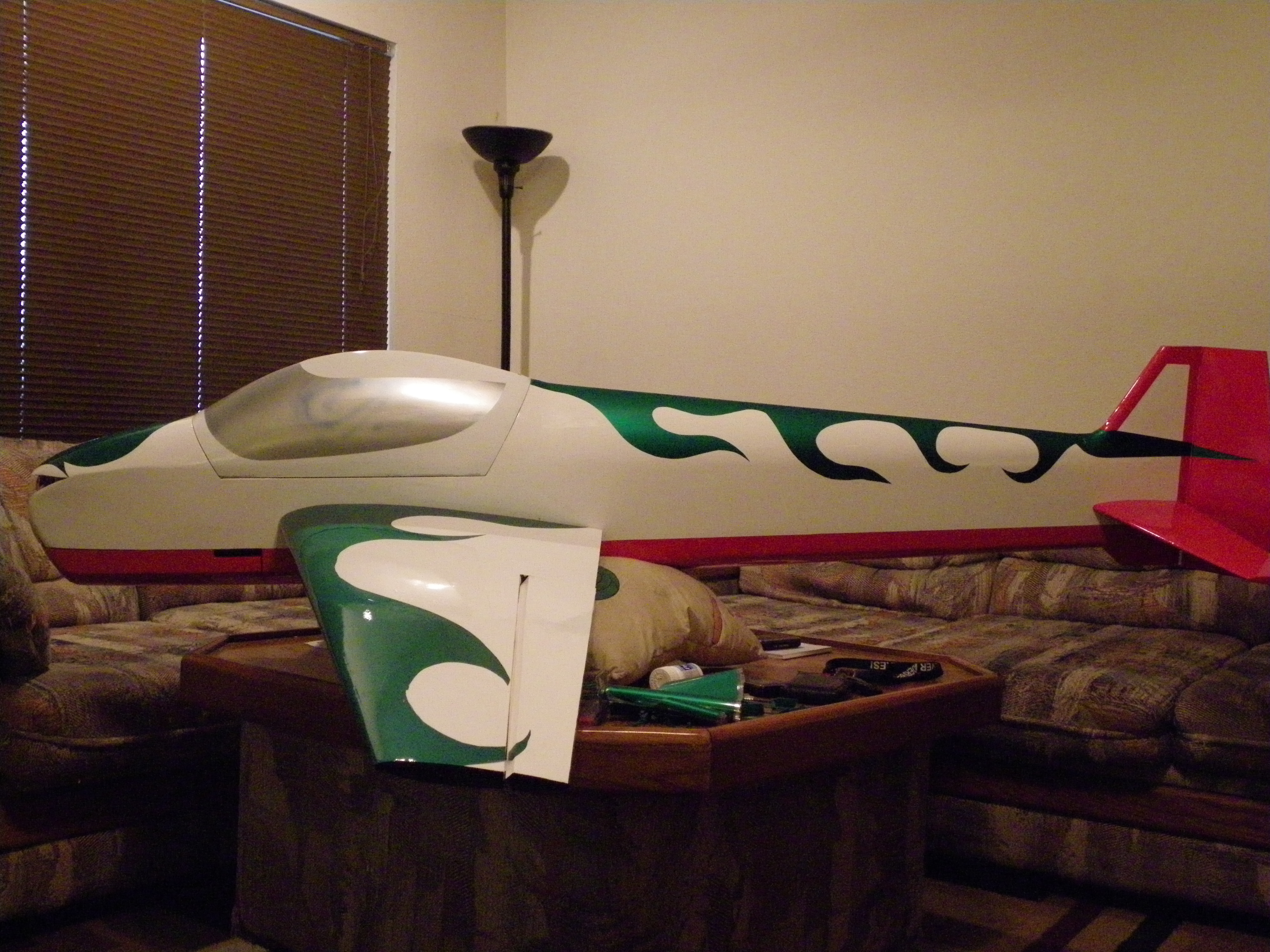

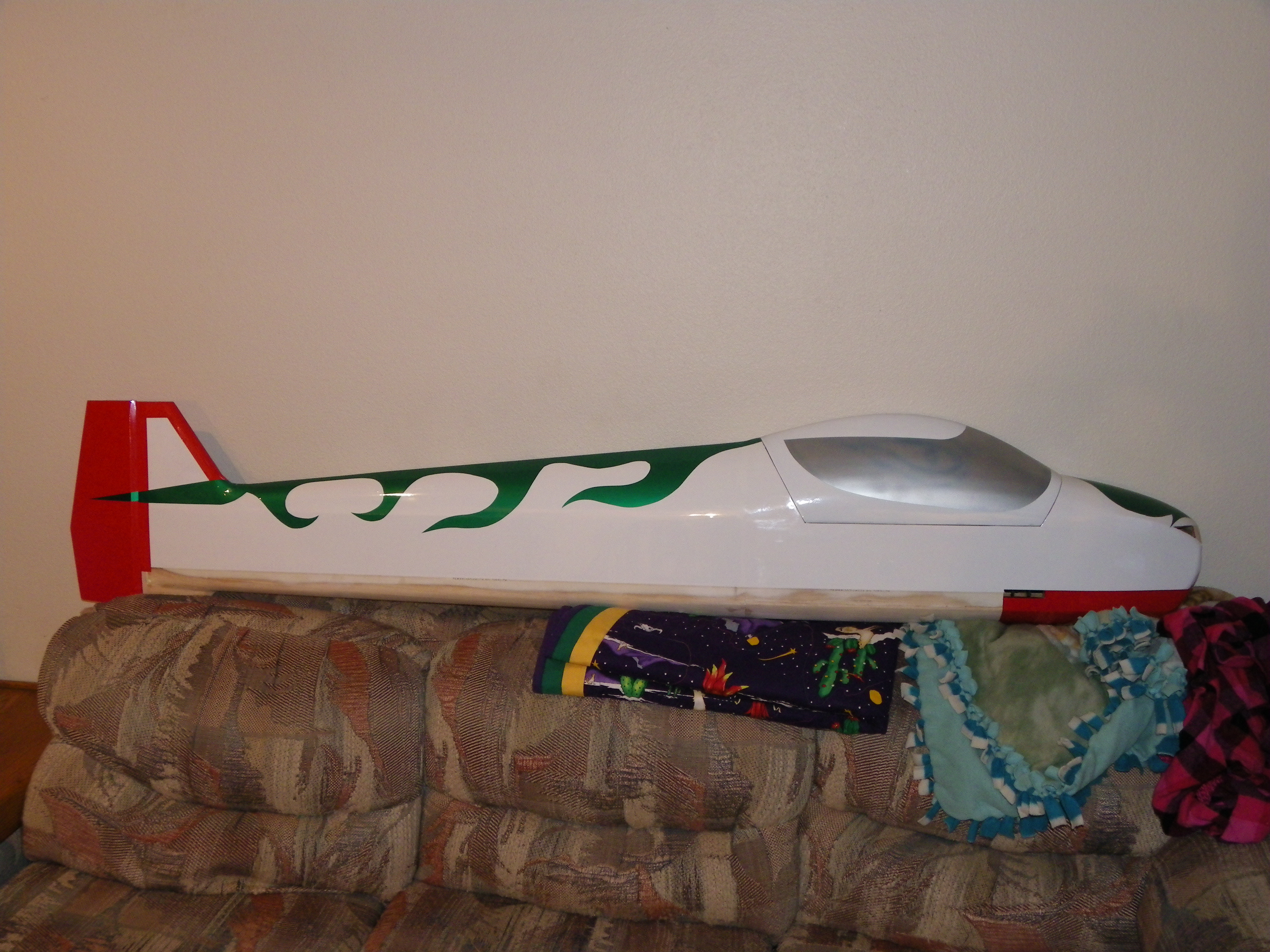

What happened to the fins on the canopy and fuse ??
Old 04-17-2010 | 12:58 PM
  #86
Joined: Aug 2004
Posts: 1,119
not there yet eddie!
more pics and weights coming in a sec....
Chuck

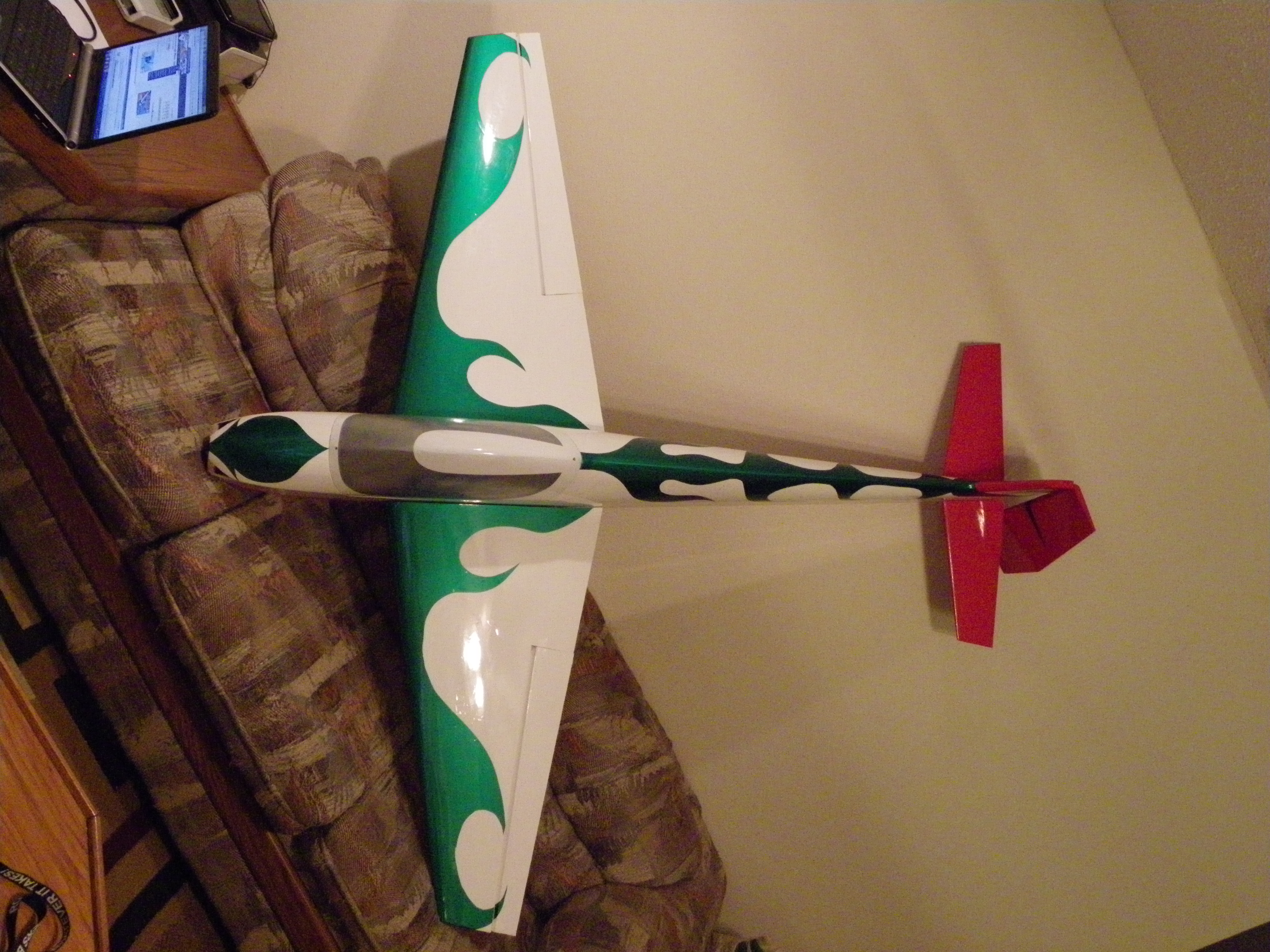

Weight including elevators and carbon gear is 5 lbs 2 oz.

Ok, MAIDEN complete!
Ended up using Hacker c50-14xl running 20X15 and castle 85hv controller.
2 clicks down trim and i click aileron. nice. love pattern planes
Ok, so rolls to the canopy on knife edge slightly and went to the canopy. So.. one turn on the wing incidense and barely goes to canopy, will mix that out cause DOWNLINES are nice.
Anyways, totally stoked about the plane, and
10 lbs 9 oz.
Chuck

Alrighty then....
First contest in the books along with flights 3 thru 7 go figure.
Plane is not locked in much better. I had initially not put the fins on and trimmed plane for straight and level and noted that the plane pulls to canopy in knife edge and also in down lines. It also rolls to its back with rudder.
So.... being the weather sucked I didnt make any changes to the plane and I wanted Mark H (Designer) to fly it and evaluate.
Mark H flew it... he flew it very very well and we have deteremined that....
CG is forward a bit which should take out the issue of pulling to the canopy and need to mix out the roll couple although slight.
So.... onto the fins.. I had a ton of right trim to get the thing to fly straight and also need to stab right rudder when pulling into verticals under power when the fins were off.
Fins on... all right trim gone. Very little pressure on the rudder when pulling to verticals.
Chuck Hochhalter
