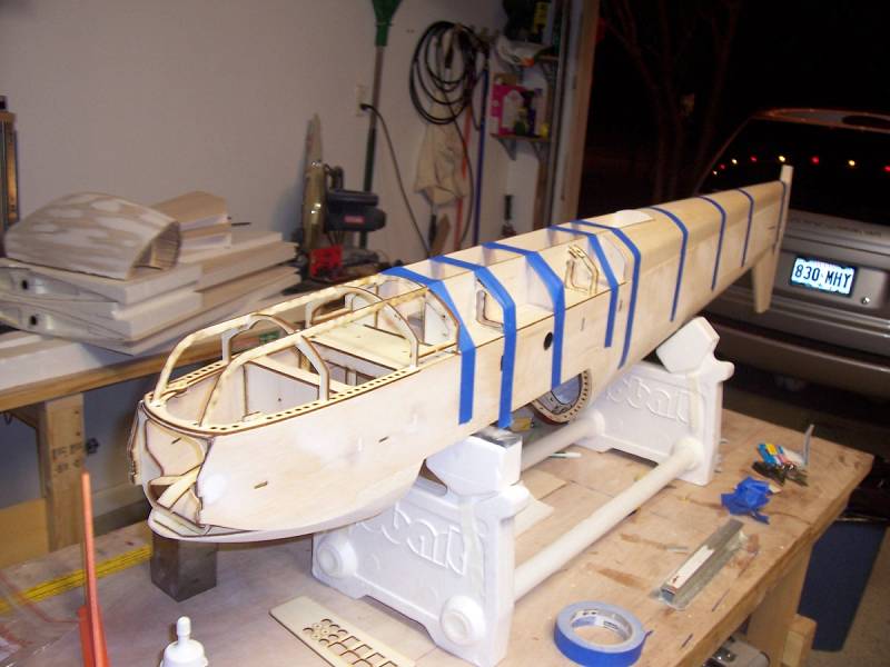

With the fuse still flat on the workbench, the wing tube can be trial fitted along with the stabs. On this plane, the stabs will be set and glued after the fuse and stabs are finished seperately. I centered the wing tube in the fuse and did some careful measuring. I tacked the tube socket in place and then carefully test fit the wing panels. With the panels, on I did some measuring and checking to make sure the panels were parallel to the cockpit floor, and square to the length of the fuse. There were no surprises when checking, so the socket was glued in.

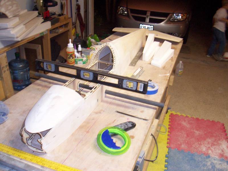

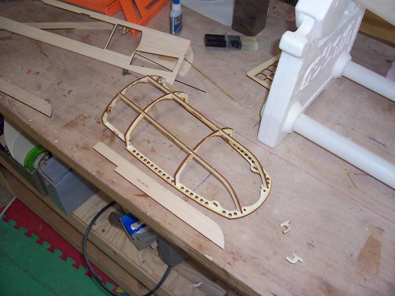

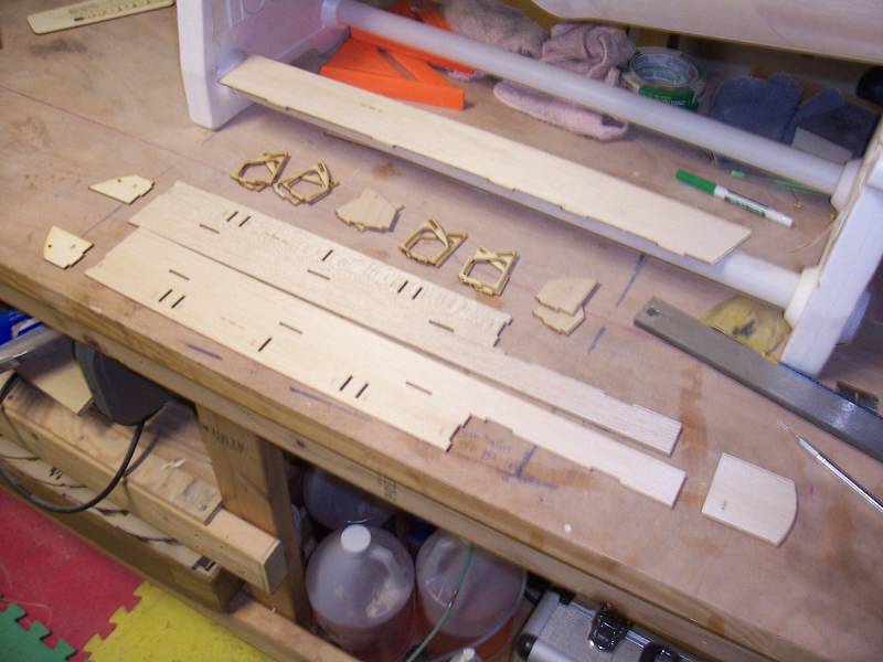

Time to work on the bottom of the fuse. There are three simple sections to add to the bottom of the fuse....the chin cowl, the pipe tunnel section, and the aft bottom foam deck. In order to fit everything properly, I framed up the chin cowl and pipe tunnel assembly and dry fitted them to help position the bottom rear deck. The bottom rear deck will also need to have a cutout for the aft end of the pipe tunnel..so having the pipe tunnel assembly handy will make this much easier.
Start with the chin cowl parts and carefully assemble the frame work. No need to sheet it yet...sorry for the fuzzy pictures.
The pipe tunnel section can also be assembled without the final sheeting.

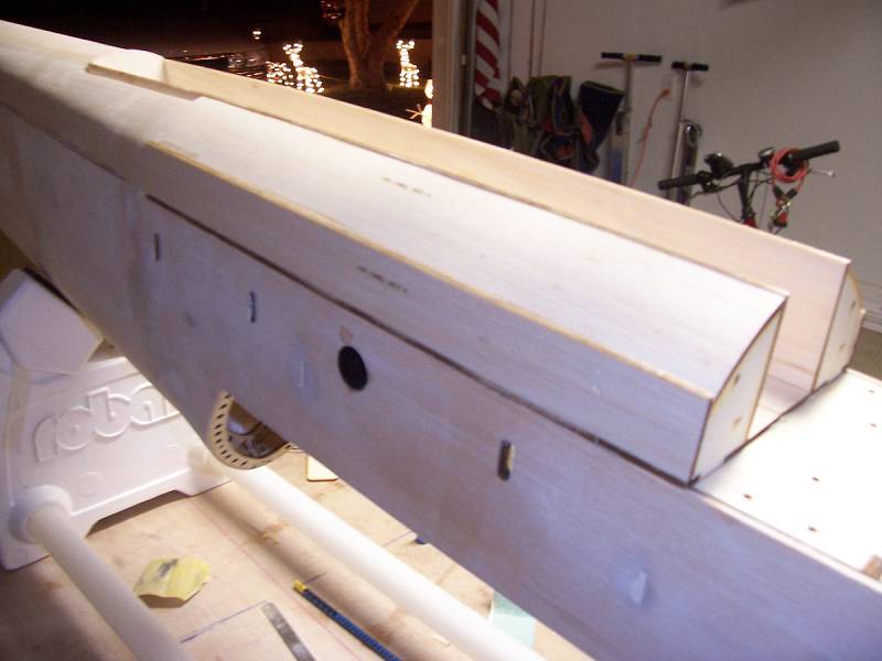

With the chin and tunnel temporarily in place, the aft rear deck can be marked for the pipe tunnel cutout and fitted to the fuse. Glue in place with polyurethane glue.

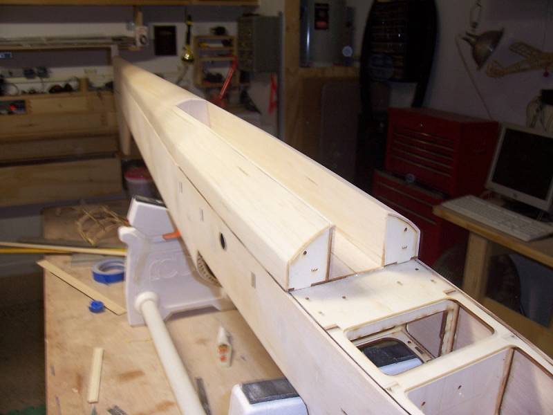

The pipe tunnel asembly can be glued on to the fusebox and sheeted later. There are laser cut pieces for the the sides and the bottom of this assembly. Don't forget to add one of the little lite ply donuts to the back side of PTF-1 to accept the pins from the aft end of the chin cowl. A little sanding and we have a pipe tunnel.

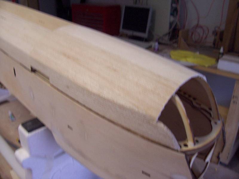

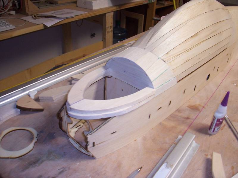

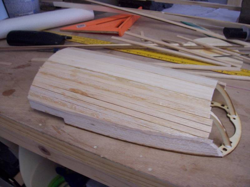

Time to sheet the chin cowl. Before sheeting, make sure you have added the little ply donuts at the back for the mounting pins. You can start with the 1/8" balsa sides. Sand the top edges of the side pieces flush with the curvature of the lite ply frame. If you want to sheet the bottom with a single piece, you may want to preform it. I choose to plank with small width pieces.

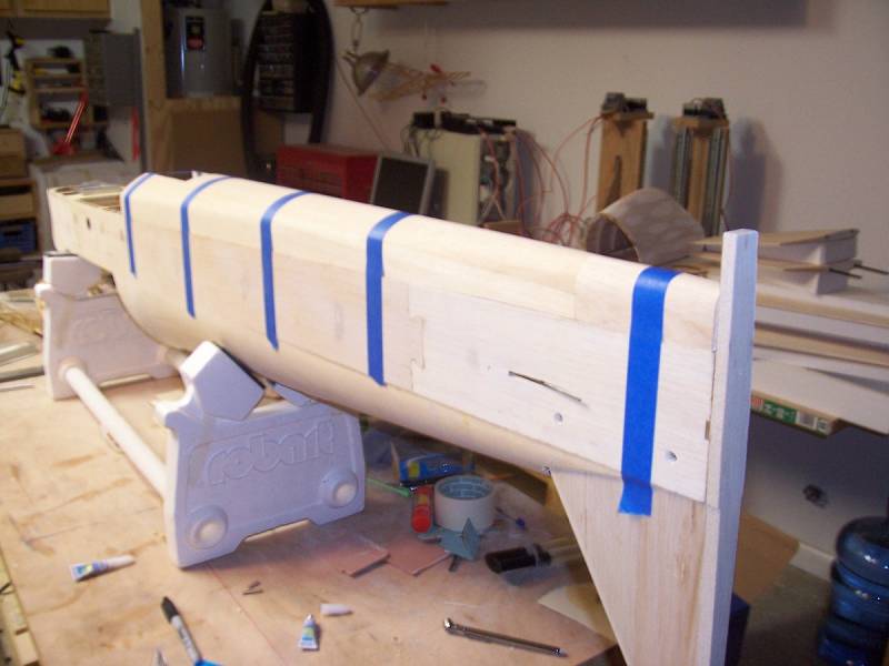

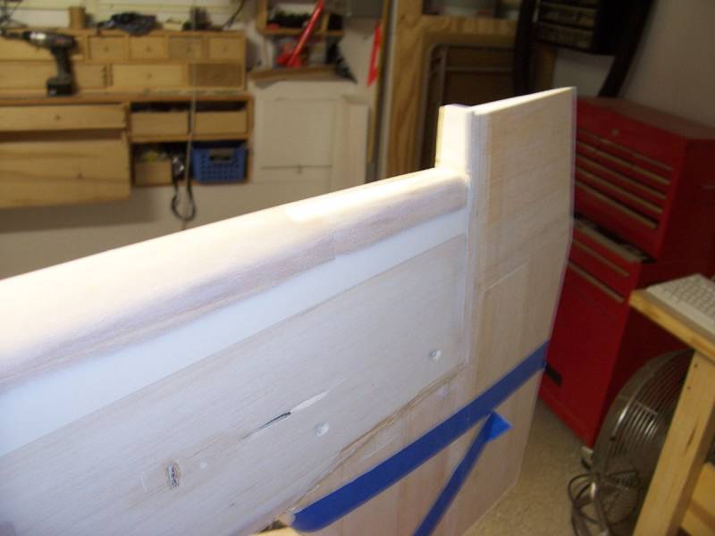

The bottom of the vertical fin can be glued in place as shown. Sand a small flat area into the bottom rear deck. Carefully align the fin with the rest of the fuse. A small ply plate is provided for mounting the tailwheel later. Some filler and sanding will be required around the base of this piece.
ID:	836034   Click image for larger version
ID:	836035   Click image for larger version
Old 12-28-2007 | 08:23 PM
  #59
flyintexan's Avatar
Joined: Apr 2003
Posts: 1,207
Received 2 Likes on 1 Post
From: tomball, TX
Default RE: Pentathlon Kit Build

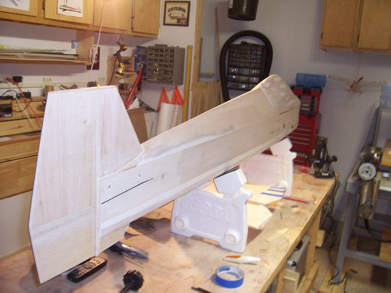

The bottom of the rudder should be capped with medium balsa. This should end up flush with the bottom of the vertical fin and tailwheel plate. The top of the rudder and vertical fin can also be capped with the provided balsa piece.

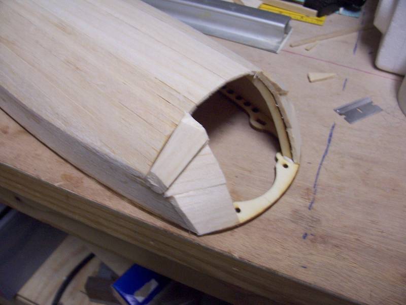

Back to the nose (I was waiting on a motor to perform the following...).
There are multiple ply rings in the kit to accomate the two most popular soft mounts. These rings can also be used as motor mount spacers if needed. The blind nuts can be installed in the ring/s (I use two rings...some may only want to use one) and free hand positioned behind the firewall. Feed the motor mount bolts thru with the mount and snug them up. Then mount the motor and check to make sure the prop shaft ends up where it is suppossed to (haven't had an issue yet). If all is well, then the ply rings can be glued to the back of the firewall.
With the motor in place, I then installed the F1 former in the nose. Notice I add some scrap 3/8" balsa between F1 and F2 (nose ring former). This is mainly done to fill in small gaps that exist in this area. The additional strength gain doesn't hurt either.

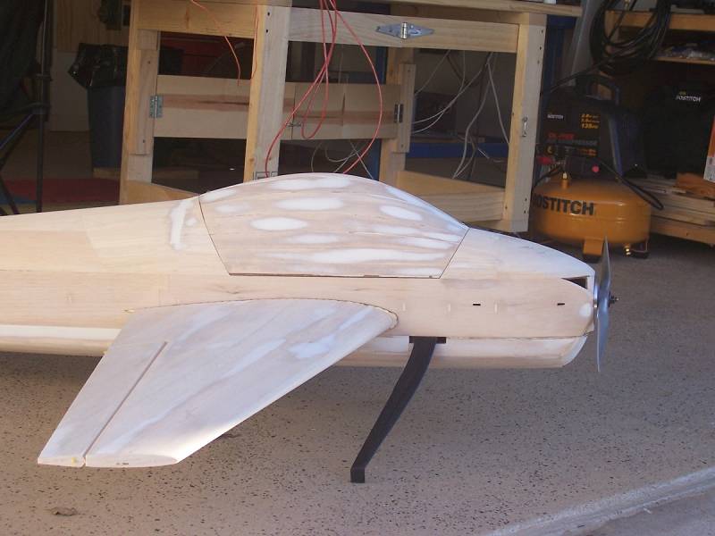

I did get the landing gear mounted. If laid out early on, the landing gear can be carefully clamped to the landing gear plate. The plate already has through holes for 6-32 blind nuts, so just use these as drill guides. If the gear is not handy early on, there is a 1:1 scale PDF file for the gear template included on the CD. For best prop clearance, you will need the Bolly F3A Long for an electric setup. The Bolly F3A Electric will do fine for nitro.
You will also see that I did a bit of rough sanding around the nose. Some fill and final sanding and the nose section will be complete.

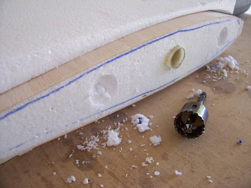

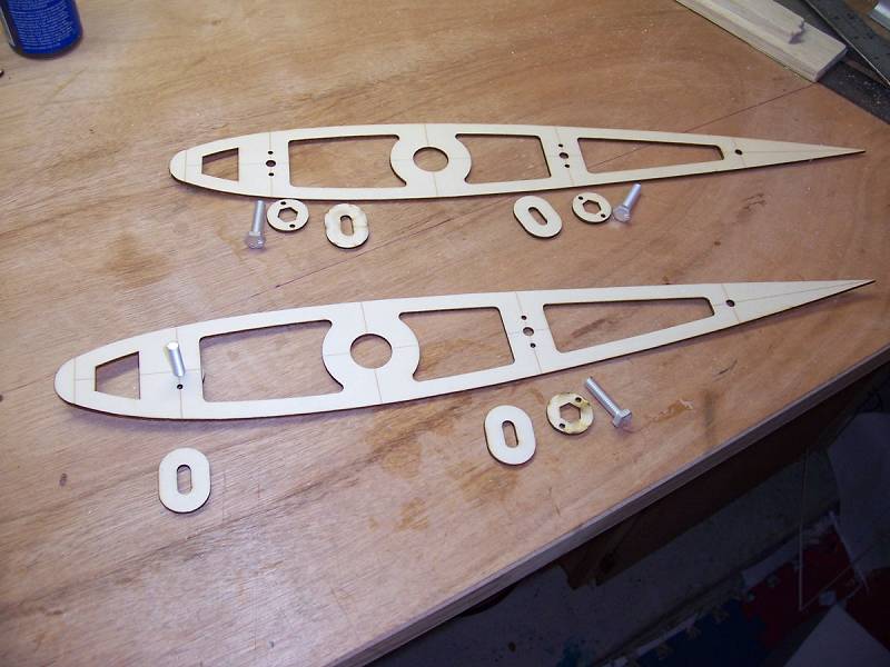

You may recall, the wing panels were still lacking the root ribs. I installed the wing panel on the fuse without the root and used a pencil to trace the fuse side profile along the top of the wing. I simply hold a pencil against the side of the fuse and drag it from T.E. to the L.E. Make sure you are about to remove the same amount of material from each panel....try to keep your wing panels as identical as possible...for obvious reasons. I cut along this line, but not thru the wing tube sleeve. I hand cut my way around that, leaving about 1/8" sticking out from the foam to engage the wing tube hole in the lite ply root rib.
Don't forget to add the wing bolts to the back side of the root rib. You will also want to glue a piece of hard balsa behind the adjuster hole. Relieve the foam in these three areas and glue the root rib on.

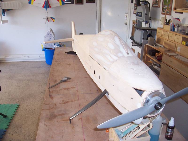

With all the major components completed, it is time we assembled this thing. We are still lacking aileron servo pockets, and hardpoints for all control horns....otherwise it is ready for finishing. Weight of airframe with landing gear legs, canopy and chin mounted, and DEPS is 66oz (includes the fins that are not installed yet).
You may notice the top line profile along the canopy and down to the nose is bit higher than usual. I wanted to try this new shape...about 1-1/2" higher at the front canopy former...we'll see how it flys sometime this Spring.
Enjoy your new plane John.

I have the pleasure of completeing this fine airframe.
Changes to be made:
Remove pipe tunnel and lighten fuse for electric setup.
Remove original firewall and install custom designed firewall by Mark Hunt.
Purchase new Bolly Long style gear set.
Purchase Yak wheel pants.
With what I have nearby this is where I am at after 24 hours.....
