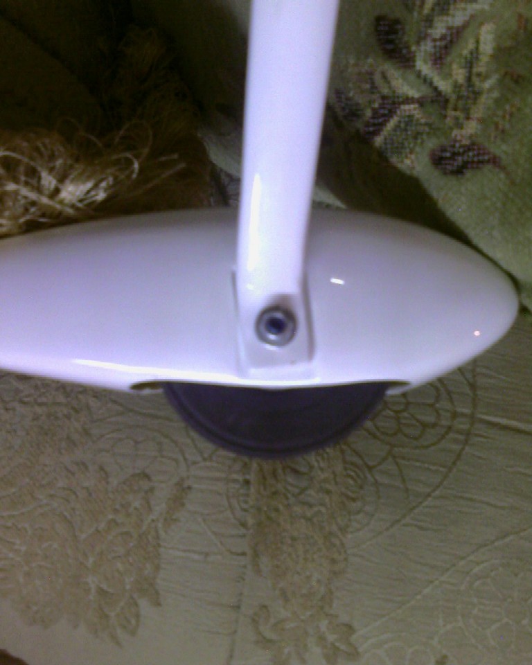

Thought you may like to see the carbon UC and the sprayed cockpit, the cockpit makes all the difference more comments about it than the plane at my local field, sprayed on the inside with a lexan model car body paint. Extra pic of the rear elevator servo installation.
EDIT: Until I looked at this pic I did not realise how dirty my plane was, must try harder.
Mike

Dear All,
I have completed my model. Posting few pictures for alterations I made;
1. 2 servos on elevator to balance the mode properly & effective controls of elevators
2. Replaced supplied wheels with bigger foam wheels to save weight & improved clearance of wheel pants
My next post will be after Test Flight which will be once I complete break inn of the engine.
All the best to all,
Sunny.
Sunny.
Sunny
IMHO you ought to get rid of those turret connectors to the elevators and anywhere else you have them, perhaps they are OK on the throttle but they are not reliable enough for a patten ship, go for 3mm ball links for the best control.
The next time you put servo's at the rear for elevators try to get the pushrod parrallel to the tailplane to ensure correct geometary for both up and down operation.
Mike
Mike
