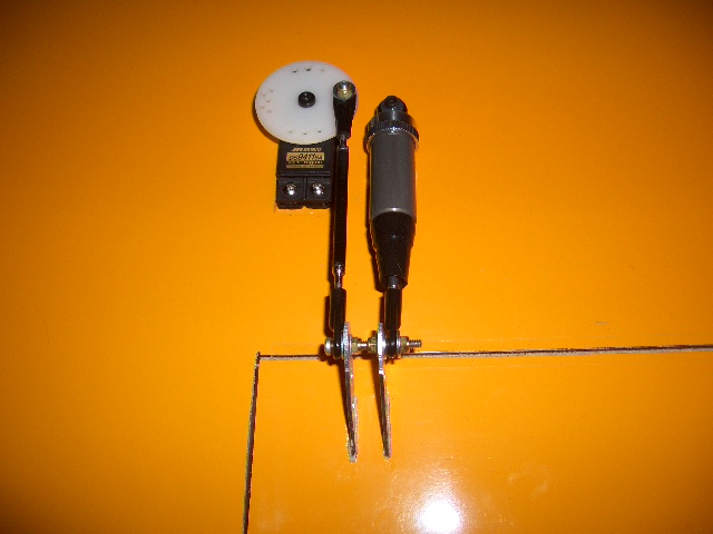

Hi Bob,
... This is the idea, how i imagine the damper-fixture will be installed. The shock in the picture are just a dummy, and will not be used.
I talked to some "car-guys" and they routed me in to a interesting part of this issue . They showed me some high quality shocks, used for special comp-applications that looks promising for this experiment. Basically, you can adjust the dampening caracteristic without disasammble the shock ,and thereby easier find the best basic setup. (4-step adjustment by rotating 1-4 holes in the piston)Then, if the shock don`t work as you want, you replace internal parts and start all over. In other words, there should be some possebilitys to get this work ...
I do not know the weight of this specific shock`s, but similar construction weight about 10gr. ( spring, preload-bracket removed;not needed).So, if i can get a complete installation down to appr 15 gr pr side, it`s acceptable.
Well, there is no guaranty at all, some experiment`s work`s other don`t ... But anyway, i like to do this, part of the game !
Kjell Olav
Kjell Olav

Kjell,
You could attach the damper as shown in your photograph.
An alternative way of doing it, would be to fit the servo with a double sided arm instead of a round wheel. The arm on one side of the servo would attach to the control horn in the usual way. The arm on the other side would be attached to the connecting rod of the damper and the body of the damper could then be attached to a suitable hard point.
Both methods should work OK but the latter may give you a little more room to play with.
I like the idea of a high quality damper. Not only would this be easier to adjust but it should also give better repeatability and be less susceptible to leaks.
I know that the damper that YS use for their YS Mount is a Tamiya Part. If you purchase a replacement set of dampers from Tamiya, they come with a choice of 3 different pistons with 1,2 or 3 bleed holes. The Part No is TA 53155 - see attached link - http://www.fusionhobbies.com/PhotoGa...ctCode=TA53155. I would remove the spring from the damper for the reasons stated in my earlier post i.e. to give a closer approximation to a true 'first order system' and minimise the possibilty of oscillations. ( I think these are very unlikely anyway since the basic transfer system of the servo itself is designed to be critically damped without overshoot.)
You can also buy Tamiya damper oil in different viscosities.
At a guess, I would probably start off with the 3-hole piston and a low viscosity oil. This would minimise the inevitable lag that a separate damper would add to the system. You might even find that you had to drill more holes in the damper piston!
Best of luck
Bob

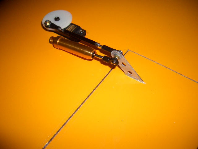

Hi Gent`s
... I thought i had to fullfill the idea , and now the damper fixture is installed and tested on my Integral. So far , everything seems promising ...
After some experiment`s and testing , i found the set-up that work, and now it needs more flight time to see how everything hold up over time ...
In the Pictures you can see it installed in the aileron and rudder.
Kjell Olav

Hi Rune,
Cold this day`s to fly, but i found my winter-suit and the "statoil-coffee-cup", so actually it is ok , if the wind is not too strong ...
Servos;
I have tuned the dampers so they do not restrict the servo-speed, at least not on ground ... I did some different high-speed / high rate snaps without remarks, still the same feeling , so it seems ok. Several pistons/oil viscosity have been tested to achive the best dampening characteristic without restrict the servo-speed. There will be some friction, but not more than a "tightly hinged ailereon".
This is a type of Damper with large piston area to give a dampening effect with little travel, together with small holes with thin oil to assure good flow at lower speeds, but restrict at higher. The oil ( silicon-based) manage temperature variations very well, and the damper was still working after a longer time in the freezer ...
Well, time will show how everything works ... But i hope they keep my new servos allive longer than my previous ones ; They didn`t last more than 100 flights ...
