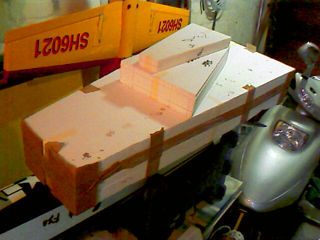

Well this how the wings, stabs and rudder arrived. All nicely wrapped in a brown paper parcel!

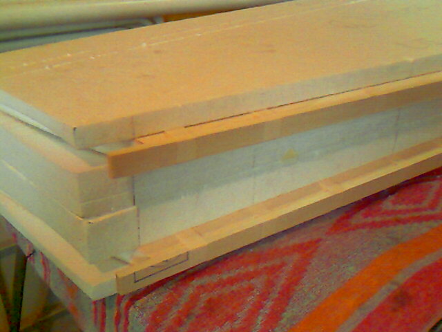

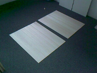

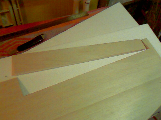

The two completed sheets of balsa. Strips glued edge to edge and sanded. Lots of work but looks better than the picture in real life!!

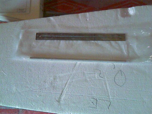

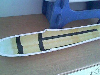

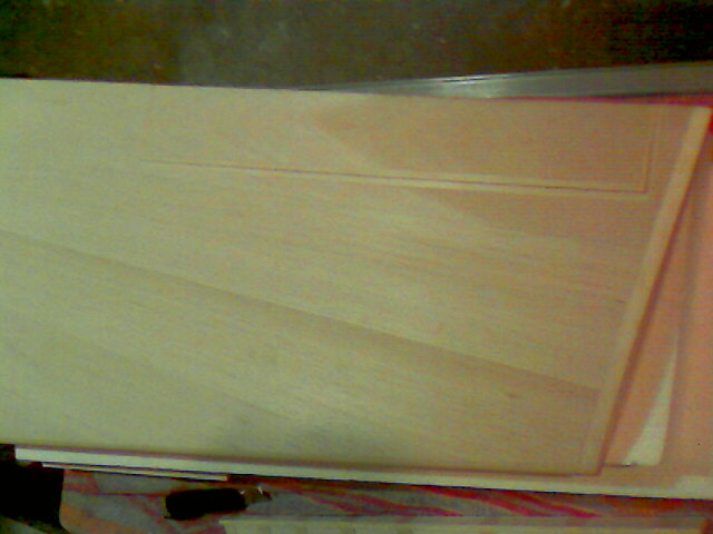

I took some foto's of the newly skinned wing halves. They are still in the unfinished condition. I am very happy with the results so far - all looks fair and straight!!
The trailing edges are quite rigid - reinforcing strip of glass cloth!?! You can just see the bits sticking out (that sounds dirty!!)

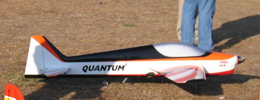

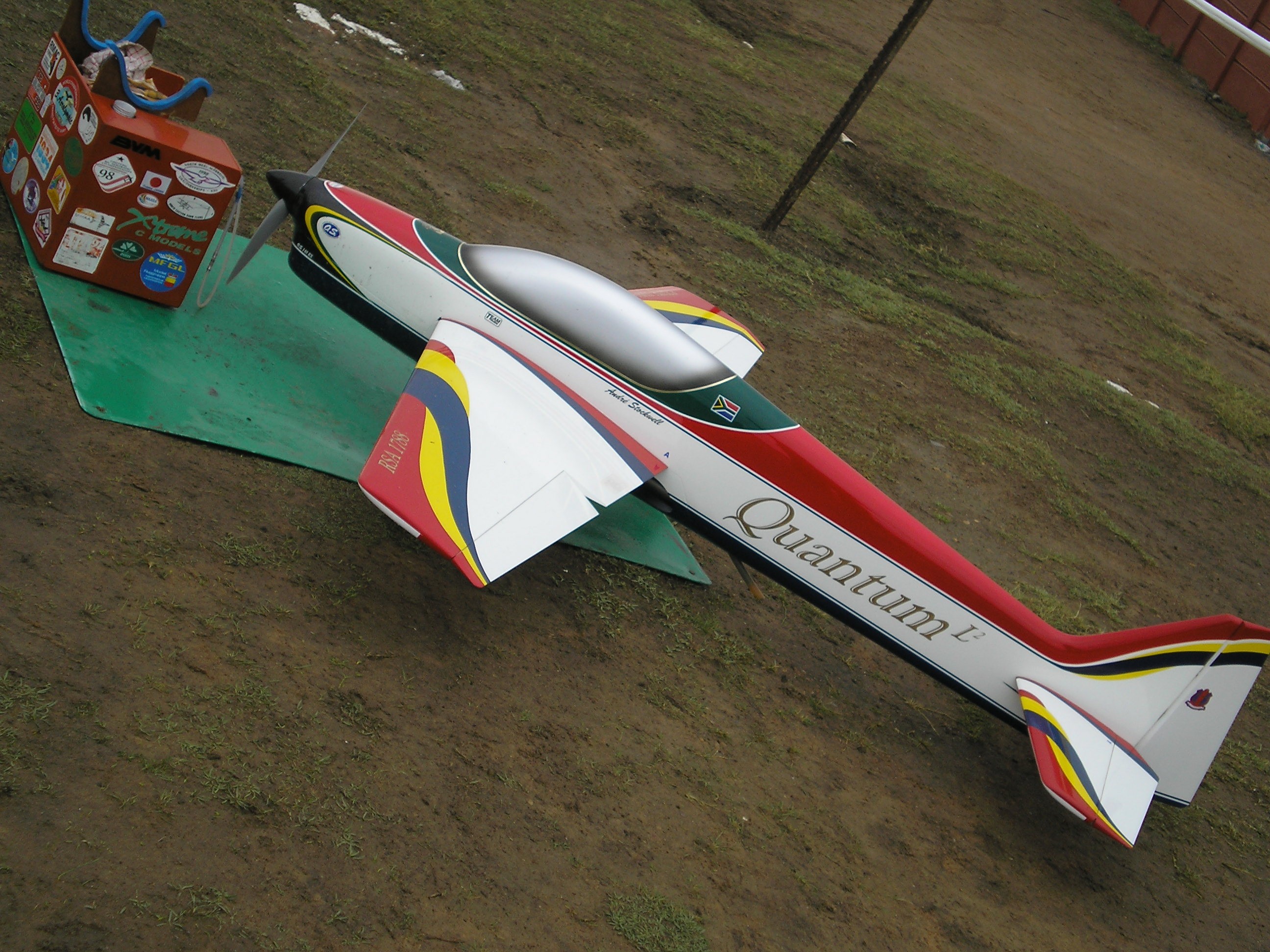

This is the picture of a very well finished Quantum L2. It actually belongs to the manufacturer and the picture was taken at the South African Champs 2007 - where Andre placed 2nd to Marcelo Colombo by a few fractions! Normalising?!?

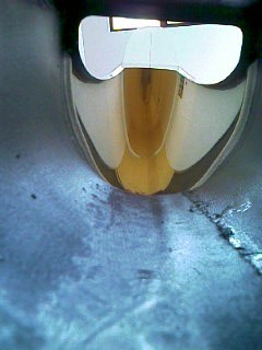

Some pictures of the "bare" insides! The belly pan removed and various shots at various angles. Full composite fuzz. I think it is superbly done and I spent about an hour just looking at the lot!!!

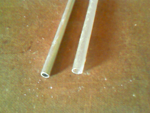

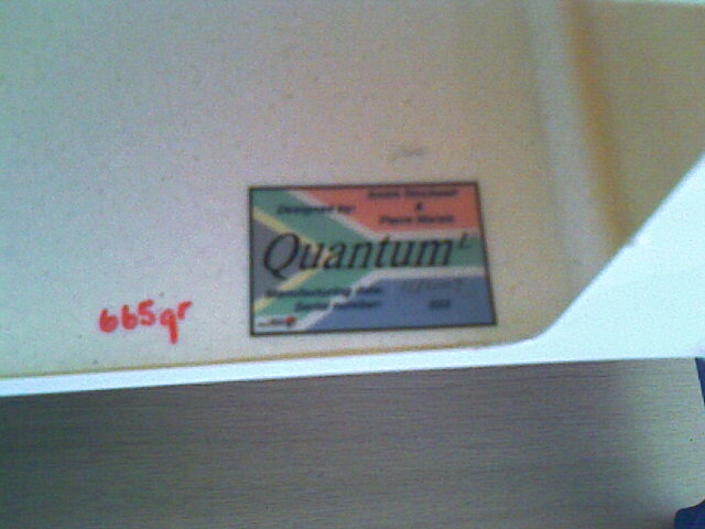

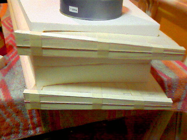

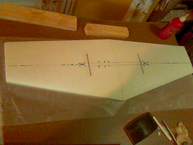

spent some time preparing the horizontal stabs foam cores for the joining tube. The stabs are removable for transport. I am quite pleased with my first efforts in making a sleeve for the wing joiner!! Glasscloth and epoxy resin rolled over the tube. Still need to make the ply supports for the sleeves and slot them into the foam cores prior to sheeting.

Looks like a nice fuse!
I take it that the 665g in the fuse is the weight?
