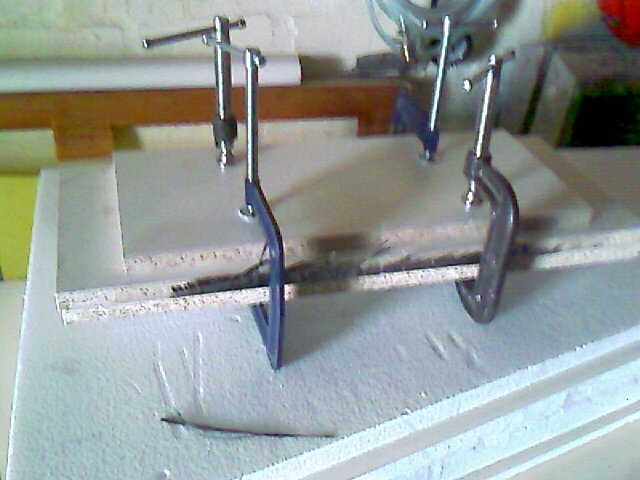

So after completing the stabs joiner tube installation I prepared the sheeting. I applied the trailing edge fibreglass strips for strengthening and expoxied the sheets to the cores. These were then placed in the clamping device.
Then I fitted and shaped the leading edges followed by the laminated tips. I again deviated from the plans by fitting a full chord length ply insert to strengthen the tip. All came out very nice.[8D]

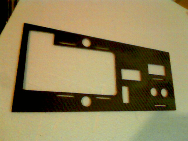

During the clamping time of the stabs I prepared the carbon fibre servo tray. With the guidance of Nazeem again I made my own laminate using the 3mm balsa and carbon fibre cloth/epoxy resin sandwhich. It came out really great and I am well pleased with my newly learnt experiment!!!
Of course the servo tray was completed over a few days!!

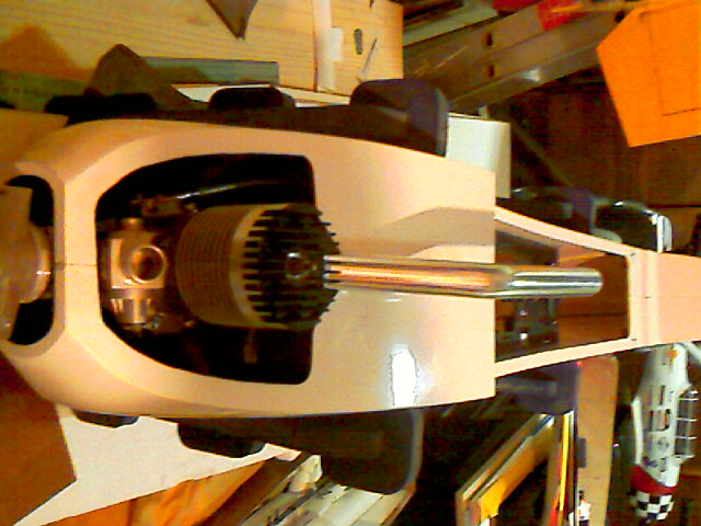

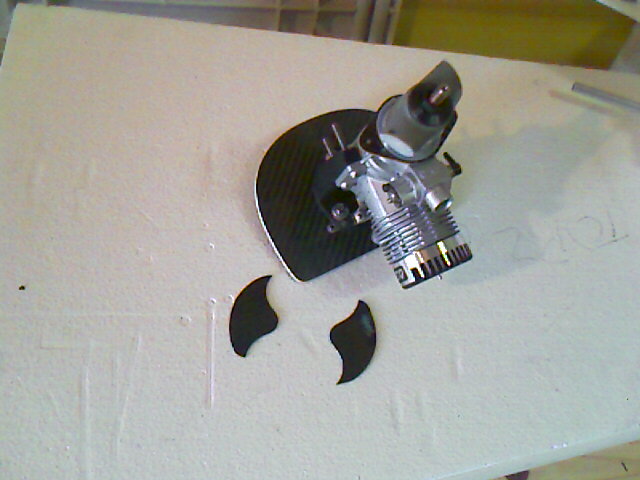

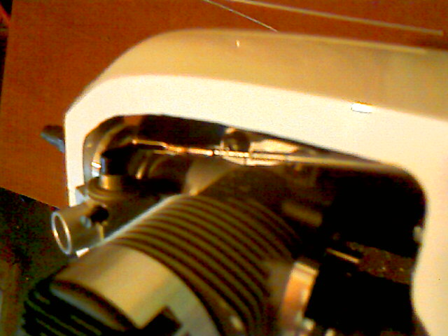

Well pleased with my servo tray efforts I then went on and made the engine firewall using 5mm ply and carbon sandwhich method. This was then shaped to fit with a small clearance inside the fuse.
The engine mounting is then fitted and the engine is temporarily mounted. Using the backplate of the spinner ( I borrowed the spinner backplate from Nazeem) and a 1mm balsa spacer the whole assembly is suspended in the fuse. The fuse is supported standing vertically.
The backplate is aligned with the nose of the aircraft, the firewall is a snug clearance fit in the fuse, the mounting is located on the firewall to have built in down and side thrust as required according to plans.
The fire wall is then "tacked" in place using 30 min epoxy. Once dried the engine and mounting is removed and the whole circumference of the firewall/fuse joint is filled with a mix of 30 min epoxy and cotton flock. This is done on the front and rear of the fire wall. It dries amazingly strong and looks very neat.

The foto of the engine in the previous post includes the laminated ply/carbon nose ring and cheak plates for my installation. Once I finally receive the spinner for my plane, been on order four weeks now [:@], I will double check the engine alignment with the backplate and then install the cheakplates into the fuse to support the nose ring.

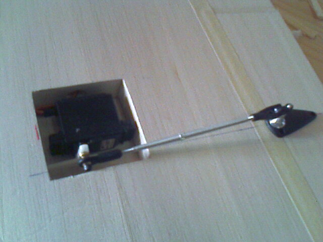

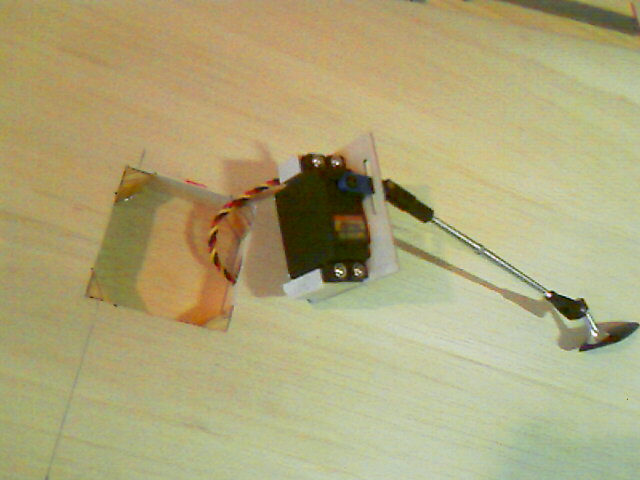

Another couple of hours went flashing by while I was busy installing the aileron servos!!!
I first took great care in the planning of the installation so as to make sure I did a right and a left wing servo bay in the underside of the wings. All measured correctly and checked and so along I went with the blades and dremel router and straight edge.
After completing the servo bay holes I made the awfull discovery that I had measured incorrectly on the one side. I was so mad with myself I felt like stomping all over the wings and starting over!!![:@]
I decided to take my daughter shopping instead for christmas presents!!!!
Anyway after the shopping I was in a better mood and formulated a recovery plan as well. Garments can have "invisible mending" - so why not wings - hahaha.
I filled in the hollowed out foam, replaced a piece of the wing sheeting and remarked and recut and rehollowed out the correct servo bay position!!!!
Then I took the wife to supper and celebrated with a few beers[8D]

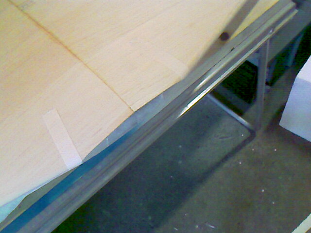

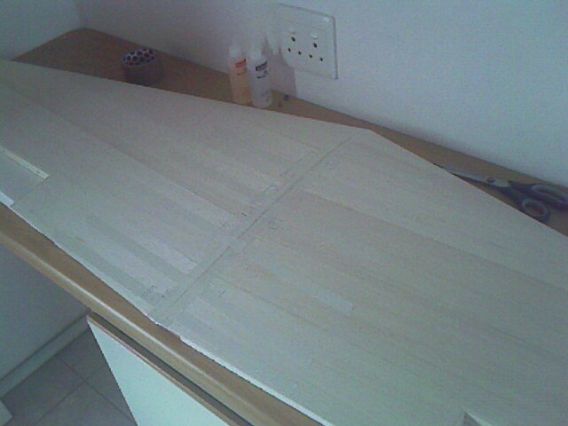

Ok - so now I need to join the two wings together. I need the wing to set up the horizontal stabs joiner tube sleeve that is fitted into the fuse. The wing is required to line up every thing fair ans square!
The wing foam cores are supplied with the dihedral cut into the foam block. This makes it a simple operation to join the wings with the designers correct dihedral built into the wings. With a handy flat level surface available I joined the two foam shucks with packaging tape making sure all is well aligned and square.
I then test fitted the wing panels for accuracy. All seemed well so I proceded to bond the two wing halves using 30 min epoxy along the joint. Then the cores are held together with masking tape and placed in the bottom shucks. After double checking alignment the upper shucks were positioned and some handy weights used to hold all secure. Paving stones left over from the paving recently done at my home!!
The second picture shows where I still need to cut openings for the aileron servo leads. "Tunnels" were made in the foam cores with Nazeems help. A jig was used to pass a heated pipe accurately into the foam cores to the correct depth. You can see the holes in the servo bays in a previous posting.

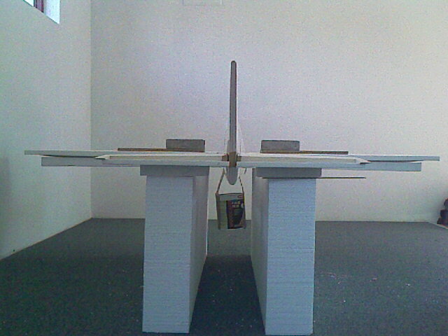

After the wing joint epoxy had completely cured - about two days later - I was busy with my holiday flying routine ok - been having to practice the new advanced schedule for the coming season!!! A big step up from the sportmans schedule that I was used to flying for the past two years.
Anyway after the wing joint had cured I had to shape the wing to fit into the fuse saddle. A little off the front and back please...leading edge and trailing edge surgery was required. I finally had something I was happy with and could proceed with aligning the stab joiner tube.

So once the wing was sorted - fitting well into the fuse saddle I could then align and glue in the sleeve for the stabs. I used a mix of 30 min epoxy and cotton flock to fill the gaps and provides a super strong glue joint. It is very handy having an extra empty room with a nice flat surface to work on instead of my single garage!!!
As you can see the inspector approves the final assembly - job well done!!!

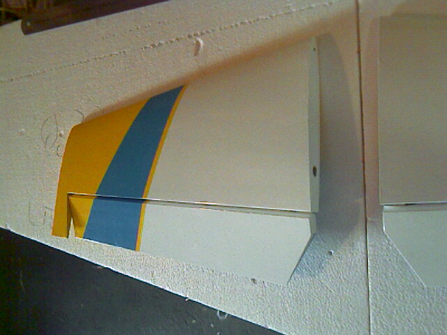

I have been trawling around for ideas on a colour scheme. After looking at lots of planes and different colours I decided on K.I.S.S.
I have opted for a blue/yellow/white combination for the wings and stabs. The same for the fuse but with some black trimmings to bring out the horizontal lines. Here is a completed stab half that I tested my scheme on - I think it looks great and is relatively easy to put on.
The first pic is the top surface and the second the bottom surface.

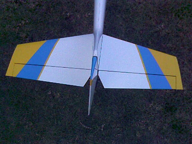

ID:	845571   Click image for larger version

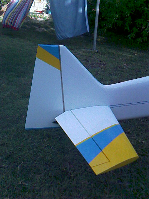

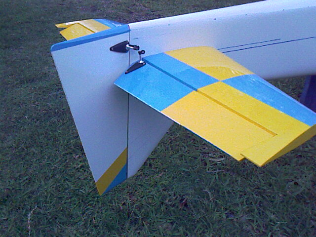

Ok - so I like the colour scheme so I went ahead and finished off the other stab and then the rudder as well. You can aslo see I have been putting the control linkages to the various moving surfaces. It is amazing how time consuming applying the covering actually is! [:'(]

And the rudder!

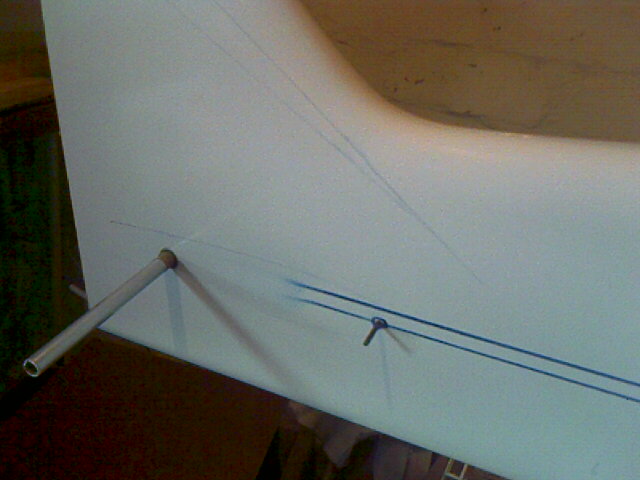

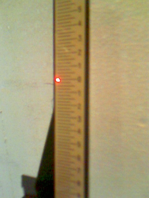

I then completed the stabs incidence locating pins installation. These are carbon fibre pins insterd into the fuse at the correct location and corresponding holes in the individual stabs.
I borrowed another good freind of mines' incidence metre as he has a new one with a lazer pointer on it! I was very pleased with my results and hope it leads to good straight flying - when I am not holding the sticks that is!!!
The pics of the laser pointer is for left and right stab - zero incidence to thrust line.

The wing is fastened to the fuse by means of four nylon bolts. The mounting hard points need to be fitted into the fuse wing saddle and the corresponding hardpoints need to be fitted into the wing before fibreglassing the centre joint.
I used 5mm ply with meranti filling in the fuse. I used 4mm pieces of meranti endgrain for the wing hard points. The wing had to be hollowed out to fit the blocks into. All was glued in place using the now familiar 30 min epoxy and cotton flock mix. The end grain pieces were soaked with CA to make them solidly strong.
I also laminated a piece of carbon fibre cloth beteewn the ply plate and the fuse to spread the load over a larger surface for the rear wing bolts fixing points and I used regular glass cloth pieces for the same purpose on the front wing bolts fixing points. Unfortunately cant get camera in for a looksee.
Got the idea from my engeneering experiences with welding doubler plates on hard points for fixtures on the metal bulkheads and decks of ships!!!

And this is what she looks like all put together. These pics were taken prior to the covering being applied to the tail feathers. As you notice I have not even looked at installing the undercarriage yet. I have opted for fixed gear which is mounted to the fuse just in front of the wing saddle. Anther job still to do....

Doing some prep work on the fuse prior to painting. Here I put strips of masking tape either side of the joint along the top surface. I then made up a thinned down batch of auto primer and painted on a few coats by hand to fill in the joint. The original joint is a very good fit - I am just a wannabe perfectionist
Once fully dried I will pull off the masking tape and water paper the rigde flush with the surface.

I got round to starting the radio gear installation. Started with the engine throttle control. I like the flexible braided cable in sleeve variety for this purpose so I soldered up a pushrod and fitted it last night.

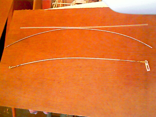

I got stuck into the elevator linkage installation last night.
I very much like the "gold-n-rods" (hope they don't mind the free advertising!) pushrods method so I opted for this method for the elevators. I had an amusing time trying to get the pushrod support brace halfway down the fuselage. It's amazing where a guy tries to stick his head into every now and then - huh!!
Anyway I got it secured in more or less the right place without too much bother. I made slots for the pushrods to pass through the fuse trying to keep the run as straight as possible. I glued the exits with my now preffered 30 min epoxy and cotton flock mix and then shaped the exit wounds!
I have fitted carbon rods inside the sleeves connecting to the linkages and am using a hitec hs5945mg to provide the persuasion[8D]
