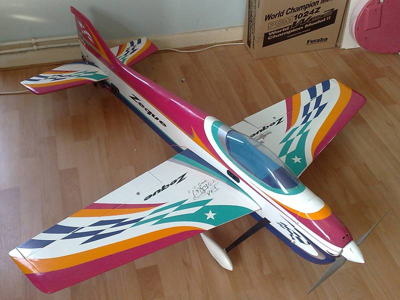

Old 11-25-2007 | 03:17 PM
Joined: May 2005
Posts: 145
From: London, UNITED KINGDOM
Default RE: zeque 70 build
pictures...
You might make out Mr Suzuki's signature on the wing, he was the man who designed the Oxai 2 metre Zeque and who was in the Japanese team at the World champs
