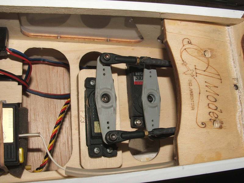

Default RE: Pull pull setup for elevators
Hello Funtana 140. Here's my Epsilon 90 with pull-pull elevatos system.

Thanks Delta Fly they are very good pictures. Would you have a picture of your radio installation in the fuselage?
Thanks Funtana, here are some pictures of my radio installation in the fuselage.
ORIGINAL: DELTA FLY
FWIW, the rubber bands will fail quickly stretched as they are. around the RX. Suggestion....buy yourself some really small silicone rubber cord or tubing (1/32 to 1/16) and tie a length into the rubber band size you need. Silicone rubber has at least a 100x life span over typical rubber in stretched shape
