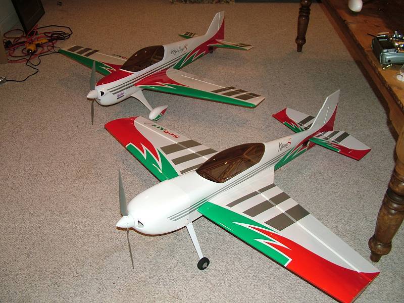

Hey There t and Jeff,<div></div><div>First off . . . here's to hoping I can make a world tour someday and come check out Kuala Lumpur and Australia!</div><div></div><div>But, let me add a little more fun info that I have found while flying my Angel . . .</div><div></div><div></div><div>Without question 6s could be used for great effect in flying an Angel in a more 3D style, but personally I would be horrified to see someone trying to 3D such a beautiful and elegant Pattern Ship. (That's a joke - of course
) I'd much rather someone do what I did and buy the Sebart Katana 50e. I have an A40-10L in mine with a 16x8 APCe once again using 5s5000 batteries. It has ludicrous power and performs 3D maneuvers infinitely better than the Angel ever could. Plus it is the easiest hovering and harriering machine I have ever flown (besides the PA Addiction).</div><div></div><div>As to having to "drive" EP planes over the top in reverse cubans and loops, I have no basis from which to compare to GP because my flying career has been one of pure EP. However, the first time I visited my coach/mentor (UAL767) he pointed out to me that I wasn't "driving over the top" of the loop and needed to add more power on the way up and keep more power for longer on the way down. We also played around with the CG and found that with the first battery position shown below and a CG around 5.5 inches aft of the wing root the Angel tended to hang slightly when inverted whereas with a forward battery and a CG of 5.25 inches the Angel came down off the top more smoothly. The downside for me was that the forward CG made rolls slightly more difficult to keep axial as it required more rudder/elevator input to stabilize the nose attitude. Finally I would add that I have found 5s5000 much preferable in wind vs 5s4000. Heavier is definitely more stable and the Angel takes the added weight with no trouble.</div><div></div><div>Of course none of that is new to you 'ole pros, but I just felt like adding a little of my experience for those beginners like me that might be listening in.</div><div></div><div>Thanks again for all the great advice!</div><div></div><div></div><div>Joe</div>
