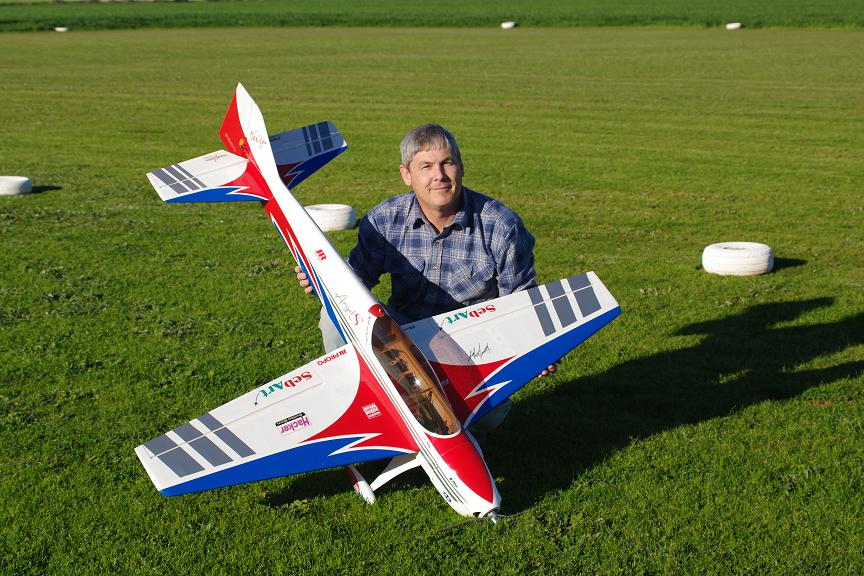

#460
Hello again,
yes Jeff that is a Tracey photo, I got the new model, she got a new camera, a Pentax K7.
I was just looking at the prop I'm running, it is a APC 17x10. This works well, it was the models previous owner who did all of the prop testing, I just copied his set up when I bought the model off him.
