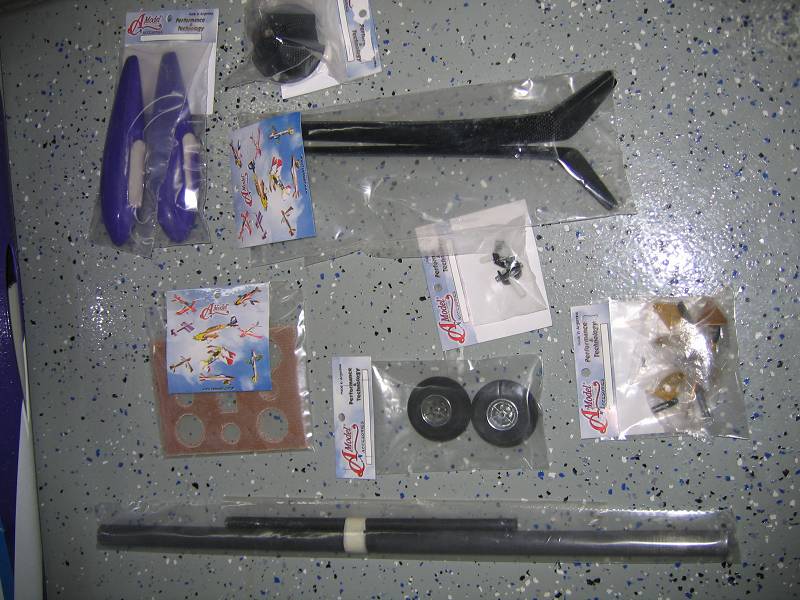

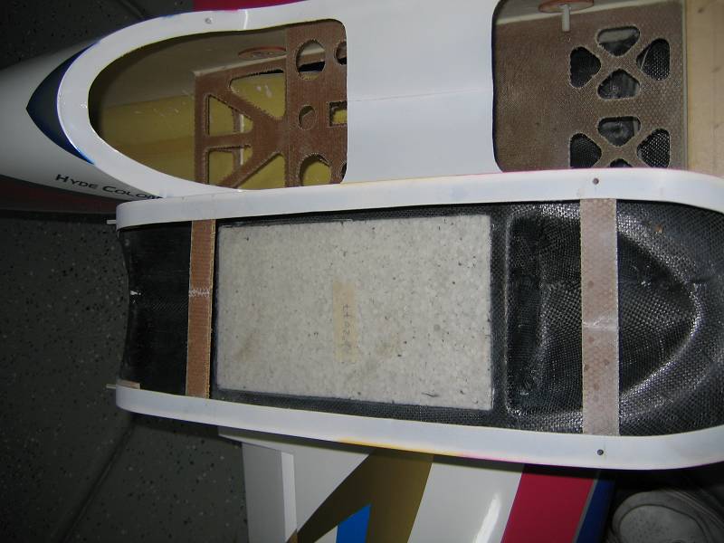

Chip and I will be doing a build on the new Pass-Port ARF from CA Models. Here are pics of Chip's Pass-Port just out of the box.
Just to let everyone know all CA Models are imported into the US by Netboxhobbies. here is the link http://www.netboxhobby.com/main.sc I recieved this from Chip, I will be adding to the thread as I get the info from Chip.
Hi Guys
Since I haven't done a build thread before, and there is not a real rush to get these models in the air, I decided to give it a shot.
This is the new Passport EP. Designed by Marcelo Columbo and myself to be used to compete in all classes of precision aerobatics.
These models are manufactured and sold exclusively through CA Models and their authorized dealers. Since this is the Deluxe ARF version, it comes standard with the following items.
1. CA Models Carbon Gear
2. Carbon Wing Tube/Stab Tube/Anti-Rotation Pin
3. Clear Canopy
4. CA Models Lite Wheels
5. CHP Ball Bearing Horns
6. CA Models Carbon Spinners
7. Incidence Adjuters Wing/ Stab
8. Light Weight Wooden Shipping Boxes
9. Carbon Wheel Pants
10. 2 PC Wing/Stab
11. Carbon/Kevlar/Fiberglass Fuselage
12. 1 PC Foam/Balsa Rudder
13. Nomex Formers/Servo Trays
Optional Extras

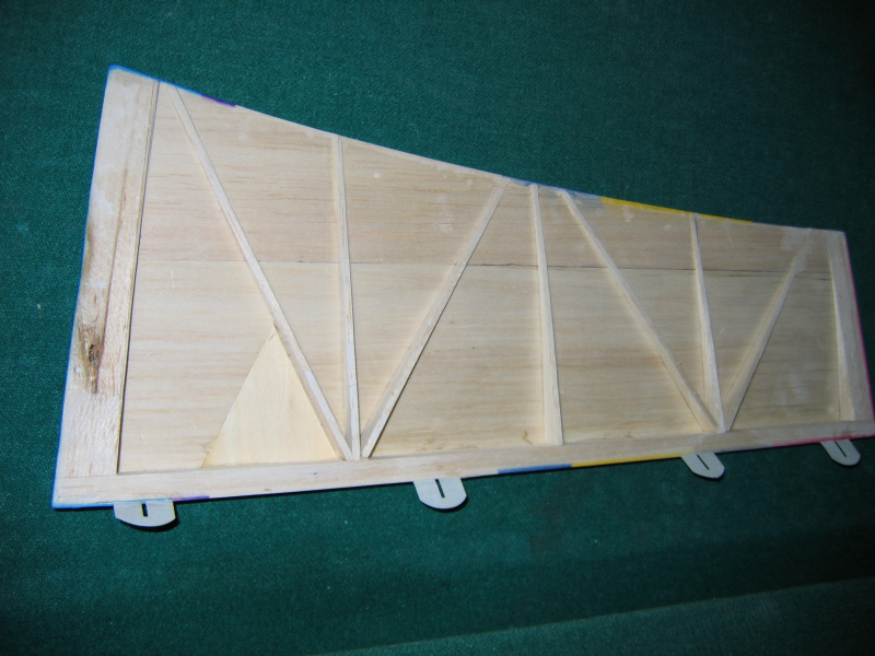

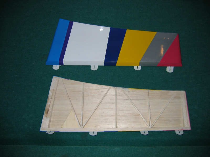

This morning I unpacked both of them and I must say I was very pleased with the quality of these models. The CA guys have really stepped up to the plate from what I have seen. I was a little concerned after getting a couple of planes last year that I really had to struggle with to make weight, and in the end didn't. After the Nationals, Marcelo and I had some long conversations about what its going to take to be able to compete with some of the planes coming from Japan and China. Since then they have made a few changes which will enable them to do just that. Most are in the quality of the raw materials. Everything from the epoxy used to lay up the fuselages, to the type of foam for the wings and stabs. In the end, the models from 6 months ago may look identical to these when setting next to one another, but these will be a few ounces lighter as well as stronger.
After I unpacked both planes, I started the hinging process. Each aileron has 4 CA hinges, while the elevators and each rudder half only use 3. The rudder hinges go into the leading edge of each half at a 45 degree angle and then they meet and each side uses the same slot in the rudder post. Be sure to use something about an inch long to wedge between the two halves when you are ready to CA the hinges in place. If not you will more then likely end up with a built up one piece rudder.
Please remember these will be electric powered planes, and if a glo version is what you decide to go with you will need to add at least
one more hinge per surface.
After the hinges were all set in place and glued I decided to put them both together just to make sure everything fit like I had hoped, which it did.
A good friend of mine was nice enough to open up his shop for this little project, so I can do both at the same time and not have to
worry about running out of space. However, by doing this I have limited my work time a little due to our schedules. He has to be
away traveling for his business tonight and tomorrow, and I leave Thurs. for the NASCAR race in Vegas. So from now until Monday there will not be much added. I do however plan to fly them before the following weekend so next week will be a blur. BTW Todd Blose will have his 2 Passports within the next week, so he will be able to answer any questions about these Planes as well.
I also forgot to mention it earlier, if anyone knows a way of doing something better or easier, please don't hesitate to chime in. I am
always open to trying a new technique or trick that will make this process as painless as possible.

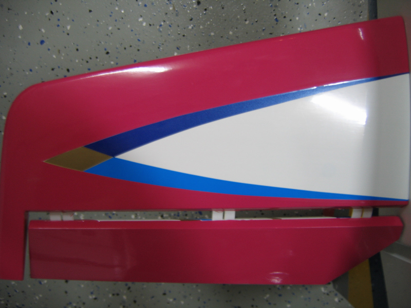

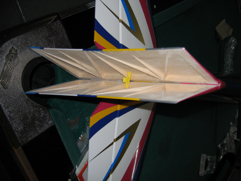

Here are a couple of pic's of the split rudder. We are using ca hinges and what we do is hinge each rudder in the same place then put both sets into the rudder post works great.

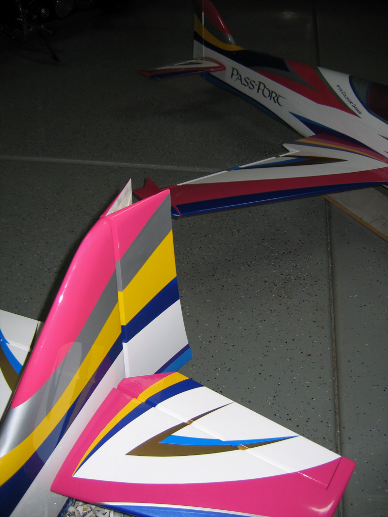

Here is the rudder attached to the fuse

1 more of the rudder, just added the stab and wing hinged

Why is the rudder split?
Mark, the rudder is split to help on knife edge. we only use on side and leave to other rudder straight to give the fuse more side area. We will use both rudders in stall turns and snaps.

Here are some pic's of the Pass-Port with all surfaces hinged. we will start on mounting the motor,radio
and control horns next.

Two rudders mean two separate servos per rudder? So you will have three conditions for the rudder which means two for left and right KE and one for normal flight? Have you tested the split rudder on knife edge? How does it work really? How does the moving rudder produce lift in KE if there is not airflow under it due to the non moving rudder??
Also can you use the two rudders deflected at equal angle in the downlines for break?
Nickolas,
yes wew are running 2 servos on the rudder. the conditions ,are we use one side for knife edge and the other condition is for snaps and stall turns. we have a third condition that will split the rudder, but in the test on down lines it's just not effective. as for the knife edgewhen using one side of the rudder and the SFG's on the wind the Pass-Port kinfe edges with very little rudder and does not dip the tail.

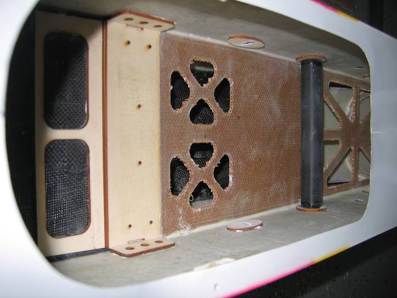

Having purchased a CA model Eclipse from Aeroworks a few years ago I hope their quality does improve. It would be a better option for me as I like to build.
I do have a question regarding your talk with Marcelo and the improved raw materials used
"Marcelo and I had some long conversations about what its going to take to be able to compete with some of the planes coming from Japan and China. Since then they have made a few changes which will enable them to do just that. Most are in the quality of the raw materials. Everything from the epoxy used to lay up the fuselages, to the type of foam for the wings and stabs. In the end, the models from 6 months ago may look identical to these when setting next to one another, but these will be a few ounces lighter as well as stronger.
Since you brought it up and then showed us a photo of the quality wood used. Is this the quality standard we should expect?

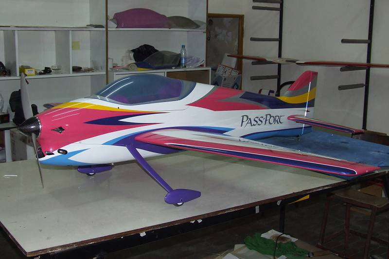

your question was how the Pass-Port was holding up to the 4 stroke motors.
I know that one of Marcelo's Pass-ports has the YS 170 in it. I have not heard of any problems. I hope
that he will see this and let us know how it is doing. Here is a pic of the YS 170 Pass-Port

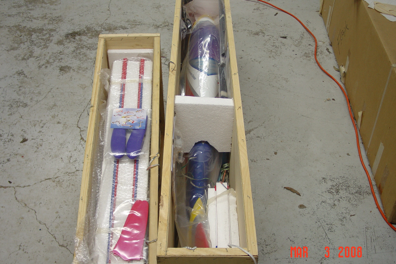

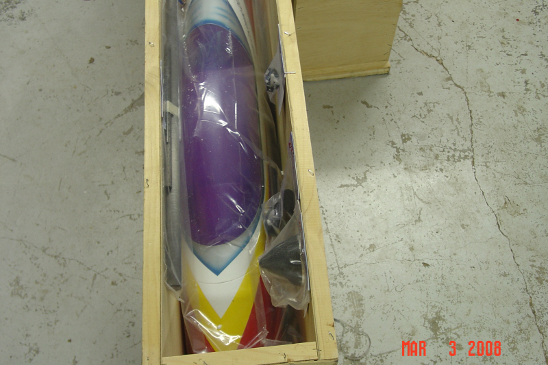

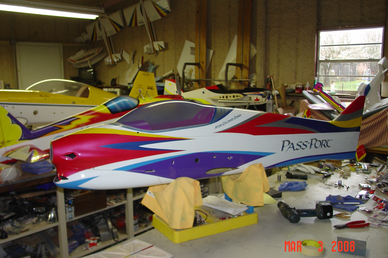

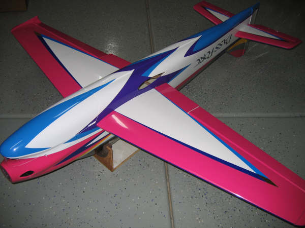

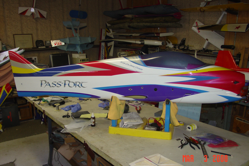

Ok so all pic's so far have been of Chip's Pass-Port. Mine just got here today so here it is, the scheme is the same except I have pearl red instead if pink. here is how the plane comes from CA Models

Default RE: CA Models Pass-Port Build
couple more just out of the crate. I will start putting it all together tomorrow
ID:	894385   Click image for larger version
ID:	894386   Click image for larger version

ORIGINAL: Fast Freddie
Chip,
first of all I really like the look of the new model.
I have to agree that ideally that peice of wood should not of been used. At least its a light peice.
Chip
