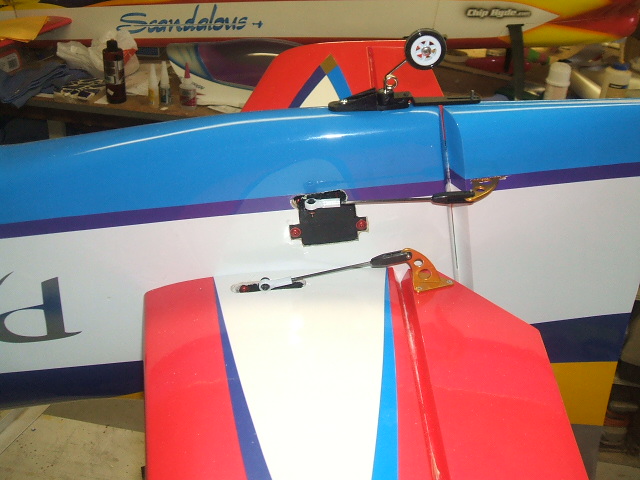

Is the split rudder a proven concept or will it be tested for the first time?
The 1st Pass-Port last year had the split rudder and it worked very well

Yes the split rudder is a proven concept and has been around for many years as a type of airbreak. However that was not why I chose to split the rudder on the passport. I did so to help deaden the rudders effectiveness around the center. Basically when a rudder input is given only half the rudder moves the other half stays straight. It is that way accept for stall turns, then both halves move together. By doing that for normal flight it has allowed the use of the wing tip fins in order to be able to have the same charecteristics in yaw that a bipe has. I was very pleased with the proto-type in every way, and the only changes we made to these was one more degree anhedral in the stab and a little more dihedral in the wing. Looking forward to the test flight in the next day or so.

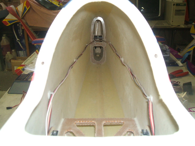

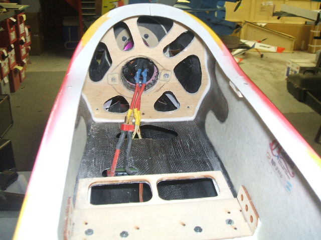

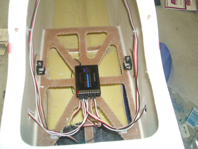

Some pic's of the install and how I am getting airflow through the firewall, I should have it in the air by mid week.

Old 03-09-2008 | 07:42 PM
  #57
My Feedback: (8)
Joined: Dec 2002
Posts: 1,211
From: Tucson, AZ
Default RE: CA Models Pass-Port Build
ORIGINAL: Ryan Smith
Chip,
Silly question. What is the purpose behind the curved trailing edge on the rudder? Looks, or does it serve a purpose? Was it to take a little area out of the rudder to further deaden it? I saw that airplane on display at the WC in Argentina and was VERY impressed with it. I can't wait to see one actually fly, or to fly one for that much.
Ryan,
The curved TE on the rudder is strictly cosmetic. If you haven't flown one by Nats time look me up and I will let you get some time on one of mine.
Chip

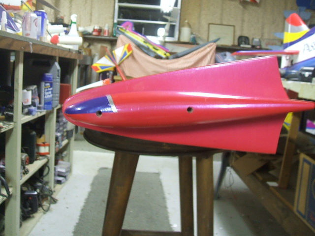

here you have some pictures of the last Pass-Port that I received.

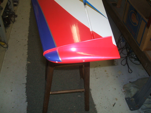

Todd or Chip,
Could you guys please show the detail on the attachment of the SFG's and enlighten me as to how they are constructed?

Ryan,
The SFG's are made out of balsa and covered. The tips are held on by 2 4-40 bolts with blind nuts in the tip of the wing. We just take the tip off and run the bolts through the SFG and screw to the end of the wing. I will get some pic's this afternoon.
Old 03-13-2008 | 11:59 AM

Ryan, here are the pic's of the SFG's mounting. The SFG's are made out of balsa and covered,the wingtip
helps with the strength so nothing special is done to them.
Mike,
Here is Chip's explantion of the SFG's
We use wing tip fins to be able to have the same charecteristics in yaw that a bipe has.
