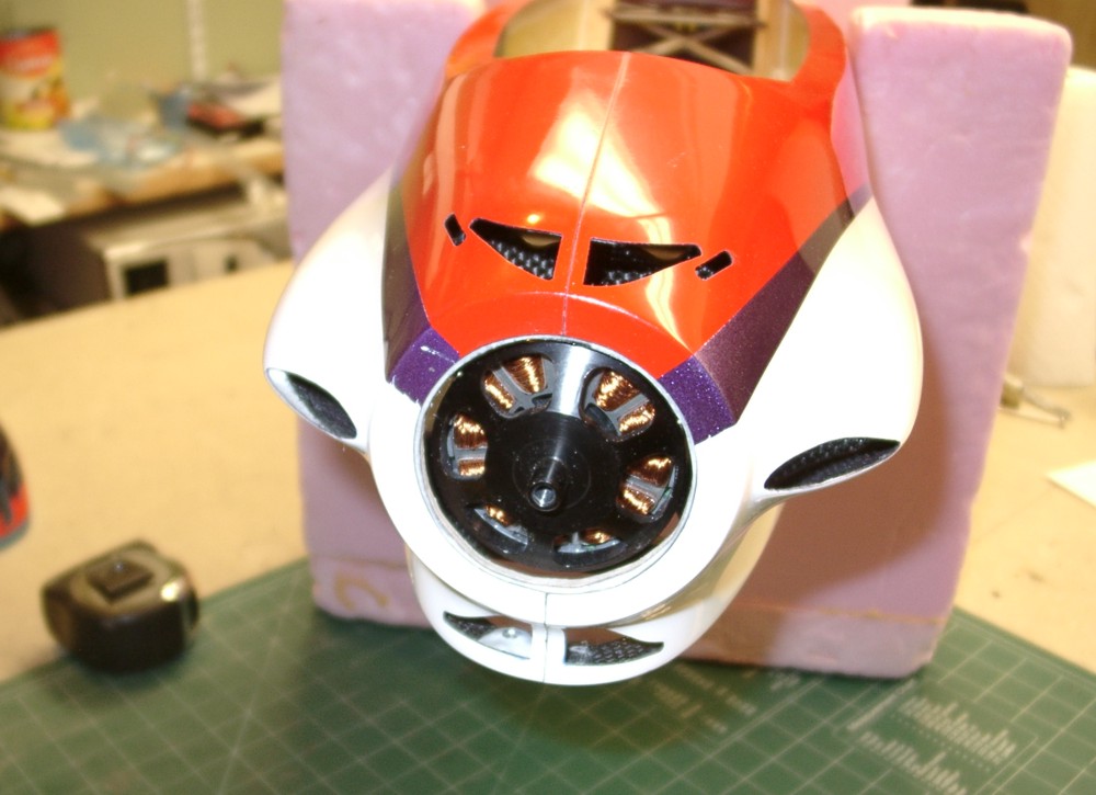

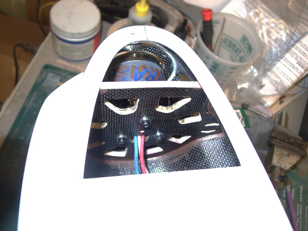

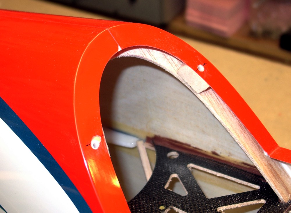

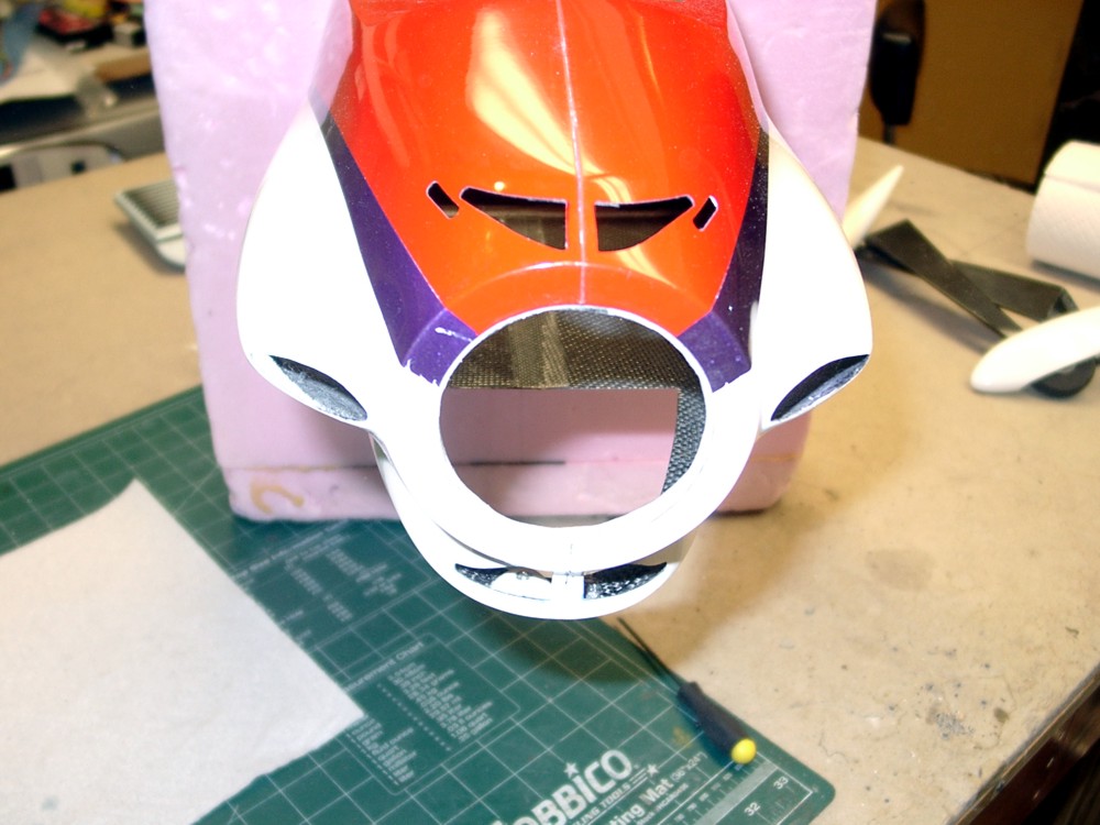

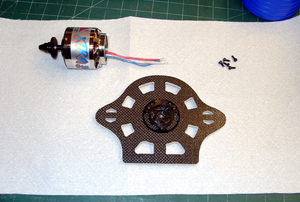

The firewall is next. First step is to mount the motor. I am using a Plettenberg Evo. The firewall has a hole near center but offset to one side. I took a chance and thought that this should be the center of the motor axis, shifted to the left a bit to make up for the right thrust. The mount for the Evo has 3 threaded holes (4mm) on a 20 mm radius from the center of the motor. I used a ruler and protractor to mark all three holes. After I realized that the rear mount comes off the motor and could have been used as a template to mark the holes. The 4mm screws have to be short or cut so that they do not interfere with the motor spinning.
The first time I inserted the firewall motor combination into the plane it came about 1/2" short of where it needed to be. In addition I realized that the motor could only go in and out through the nose ring once the firewall was in place. The wooden nose ring would have to be cut back to allow this. Get ready to make a lot of sawdust. See the before and after picture of the nosering.
Next is to size the firewall to fit a bit more foward. I use a spinner back plate to keep centering the motor and sand down edges that are coming in contact with the fuse. There will be a space around much of the firewall, I just sand the areas that hit and eventually it fits better. Again get ready to make some dust and take some time gettting this to fit properly. Each trial fit should bring it a little closer to where you want it. I use a 1/16" spacer between the spinner back plate and nose ring. I like the firewall to go just a little further than I need it and push it back slightly. This way I am usually not deforming any part of the fuse. Again 30 min epoxy and microballoons were used to glue the firewall in place. Spinner taped tight to the fuse. This is drying right now. After it dries I will add glue/microballon filets tot he front and back of the firewall where needed.
Between cutting down the firewall to fit and opening up the air flow holes a bit the final weight of the firewall before gluing it in was 34 gms. It started at 41 gms.

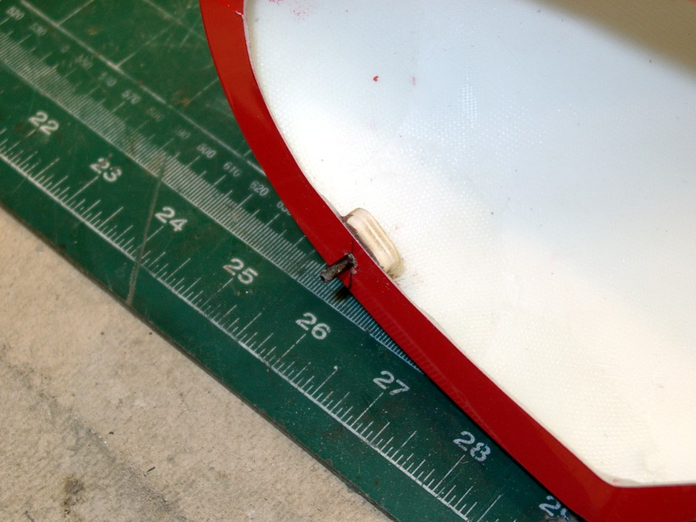

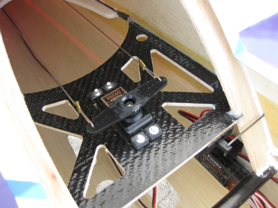

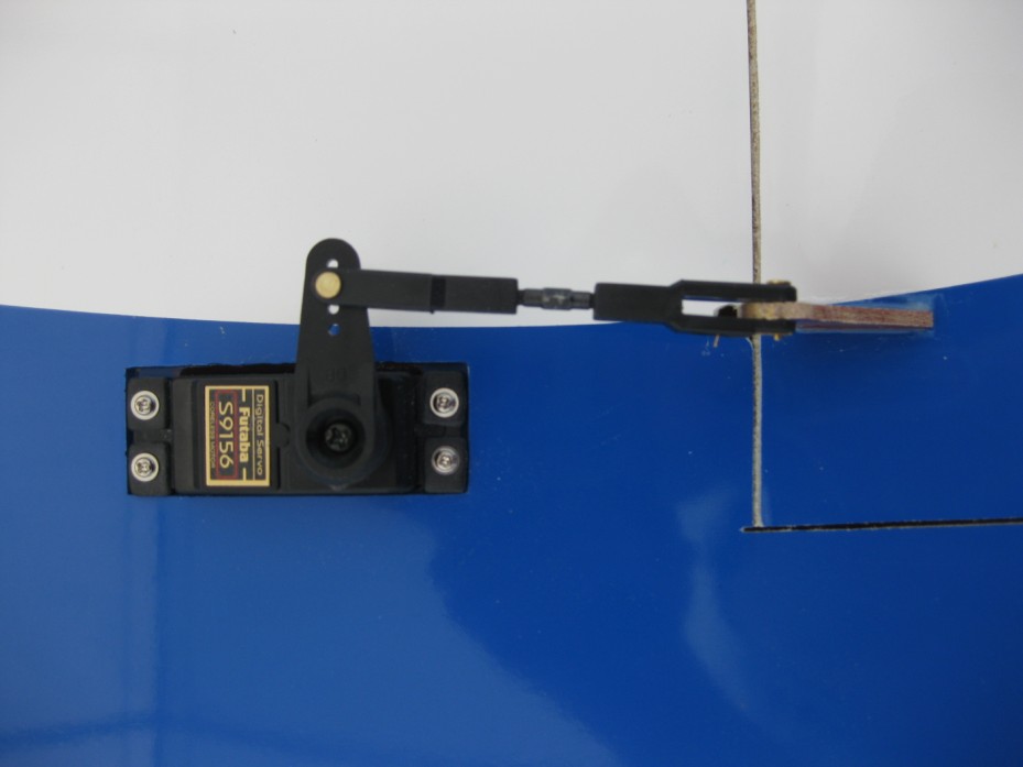

Servo mounts are installed. Wing servo openings are 36.5mm x 21.0mm. Elevator servos mount in the stabs with openings of 27mm x 16.7mm.
Anyone have a guess at the function of the copper-clad steel rod?

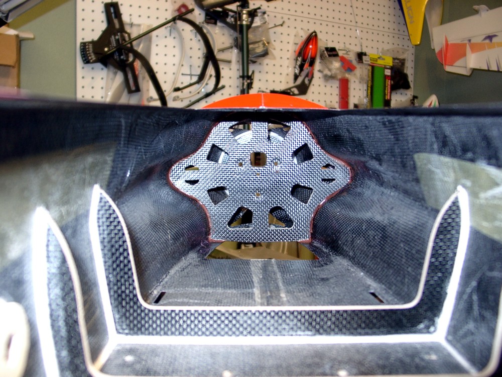

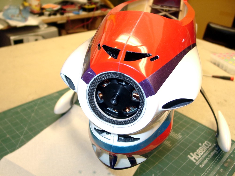

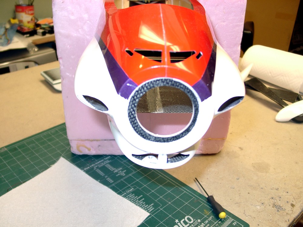

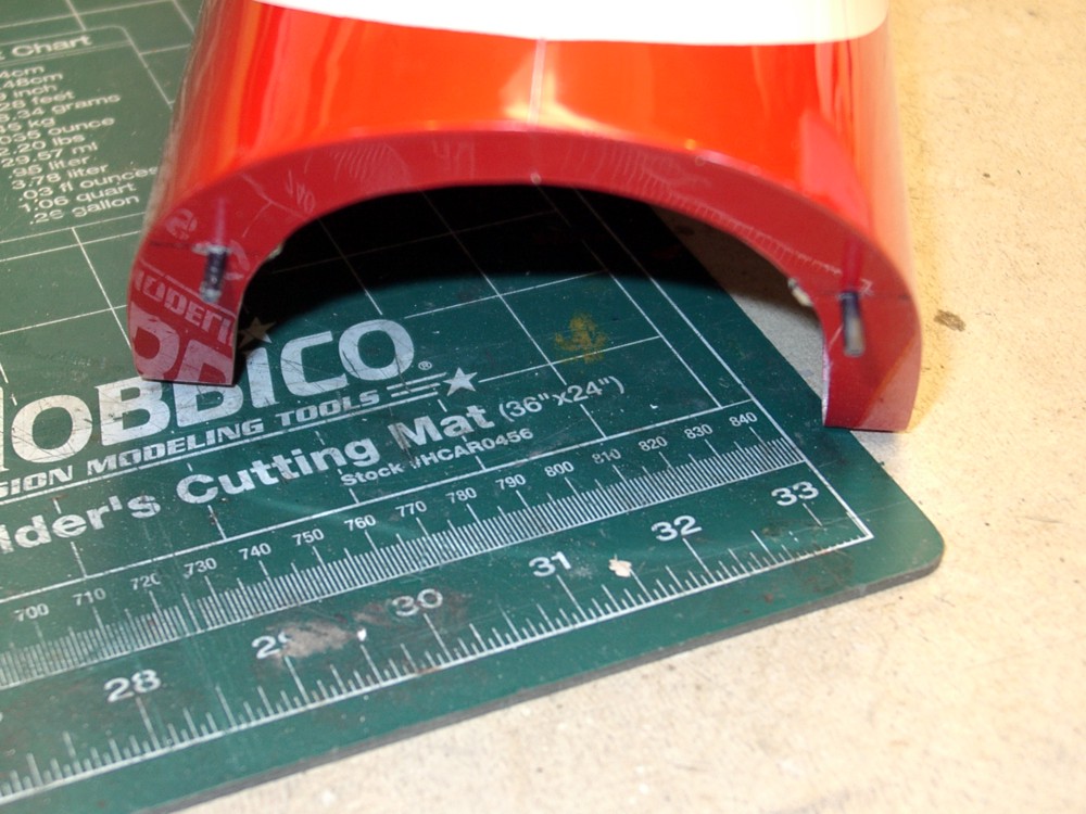

OK first big question. Does anyone think the front-end and nose-ring mount is strong enough to mount up an out-runner? Maybe stick in a very lightened "firewall" to stiffen the front-end a bit more (functioning as a former), but not attach the motor to it.
A friend did that with his Shinden, and hasn't had a failure in 2 years. I also did that with my Shinden, then backed out and installed a classic firewall after reading on RCU of failed front ends on other models.
This Valiant's front end is pretty beefy, and the CF should really make it strong.
Opinions?
Opinions?

It seems plenty strong for an inrunner like the Hacker. Just make sure to add the rear support. If you haven't mounted one before just search this forum for lots of examples. I did a Pinnacle build hear that shows one.
If you put in a Hacker you do not need either firewall so you can save weight there. The rear support will be lighter than the firewall.
The wire is to mount the rudder. The additional wood wrapped with teh wire. I have no clue yet

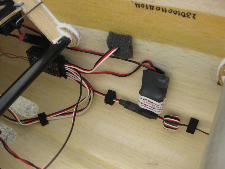

The Valiants will be close on weight when built as electric. You will have to pay attention to what you stick in the planes. Here's some of the stuff I did on mine.
Servos: 9650 for elevators, BL551 for ailerons and BL352 for Rud (replacing the 9156's I put in for test flight)
8ch Fasst Rx, SA 6V reg, small Futaba switch and 730 TP Rx batt
I used a .9 meter SA quad-wire extension back to the elevators which eliminated 2 wires going to the back (.9M works if the Rx is mounted at the back of the hatch area)
Rx, Rx Batt, Reg and controller are velcro'd to the side of fuselage with small pieces
The velcro straps for the main battery will be 1/2" instead of 1"

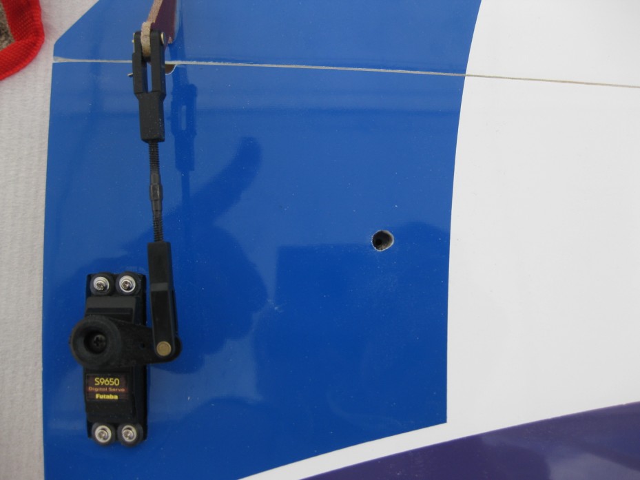

The Valiant is already set-up to Bryan's specs for wing and stab settings.
ORIGINAL: sgsterling
Anyone figure out how to get stab adjusters in? Hard to do Hebert's trimming method without adjustable stabs. Putting in wing adjusters is simple.

I believe that it is Bryan's design on the Valiant that both the wing, and stab incidence are set at the factory, and not adjustable. You only need to move the CG, and trim the elevator to end up with a zero mix plane.

I don't know if the nose would be strong enough for an outrunner mounted to the nose ring. I could guess that if there was a rear support used it might hold up just fine. If it was only mounted to the front, I would say no. With the canopy reaching so far forward and the chin removable, I don't see there being enough nose, even all carbon, holding up over time to just a front mounted outrunner.

Of course, Composite Arf didn't build the Shinden so it isn't fair to compare them.

Firewall is finished. Motor goes in through nose ring. Easier to attach screws through firewall when the chin cowl is removed and looking in from the bottom.
Weight of the fuse so far with firewall, rudder tray and added former is 803 gms.
The plane calls for a 3 1/4" spinner. I like the Great planes spinners for electrics. Fairly light with a lightened aluminum backplate. (CF may be lighter) cheap $12.95 and looks good as long as you don't take a starter to it. Weight is 60 gms.

OK its been a few days since I have been able to do any work. First off the APC 20.5 x 14 weighs about 100 gms. That is a 30 gm savings over the 22 x 12 (over 1 ounce)

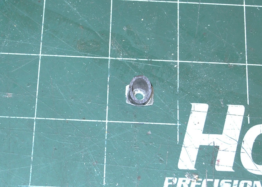

The canopy attachment is next. There are multiple ways to attach a canopy and many will work. Jason showed pictures of Bryan's setup. My preference is pins at the rear of the canopy and 1 or 2 screws at the front. If the canopy was a perfect fit then 1 screw at the front center would work fine. My canopy fits pretty well but needs to be pushed into place a bit, so I will go with 2 screws up front. The kit comes with some phenolic pieces to be used for alignment tabs. It also comes with a piece of 6mm CF rod and 4 CF sleeves. The only use I can find for this is alignment pins for the canopy. I think the inclusion of this is a carry over from prior pattern planes where these pieces were used for the belly pan mounting (Impact). In reality 6mm CF rod is a little overkill. I used a couple of short pieces of 1/8" cf tube supported by a couple of pieces of 1/8" light ply. The CF tube was inserted perpendicular to the rear canopy surface.
Mating sockets in the rear of the canopy mounting area were made from 1/4" teflon tube (1/8" ID). The teflon tube was used to make the pins slide in easily and resist wear. The teflon tubing was glued into a piece of balsa balsa which was sized to be a slight friction fit between the back of the canopy area and the former behind it. The holes in the fiberglass fuse are a little oversized to allow the pins to position the balsa holding the sleeve in the right place while the glue was drying. I used a little 5 min epoxy and held the canopy in position while it hardened.
#50

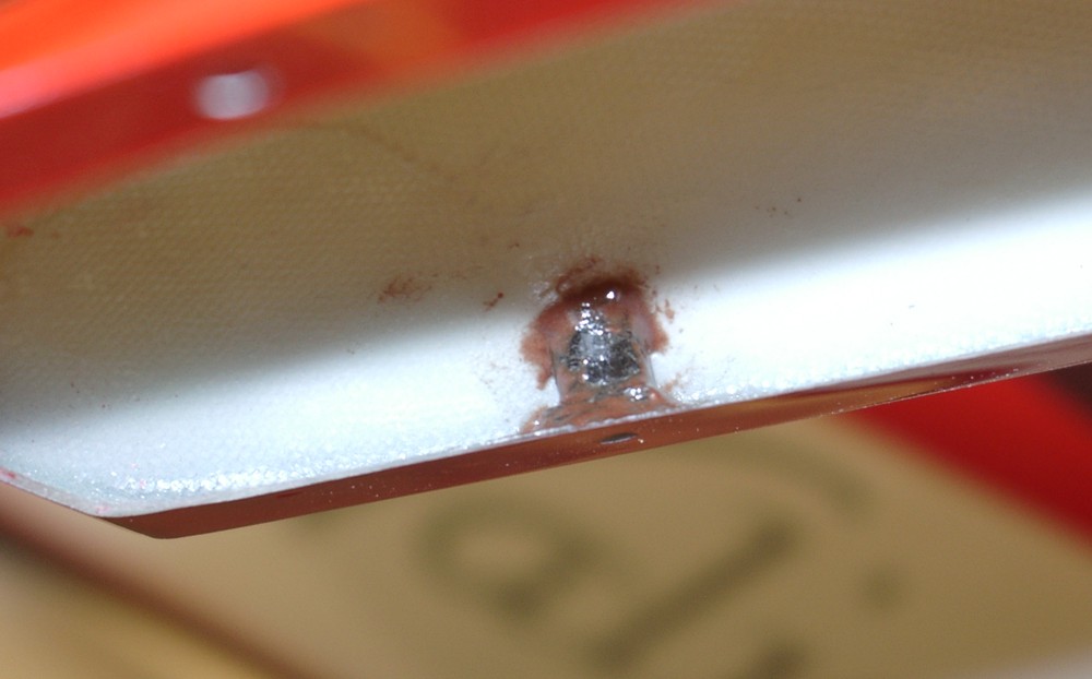

The front of the canopy will be held down by 2 3mm socket head screws (12 mm). First job was to make a sleeve for the screw to slide into. One of the sleeves for the 6mm CF rod worked well for this. Starting with a 9mm piece it was shaped to fit in the front of the canopy between the inner top and inner lower lip. A piece of thin fiberglass sheet (used for hatch covers) was glued to the bottom of the carbon tube to provide a solid surface for the screw to pull down on. This was tacked in place with a small amount of 5 min epoxy and the reinforced with epoxy/microballoon mixture.
