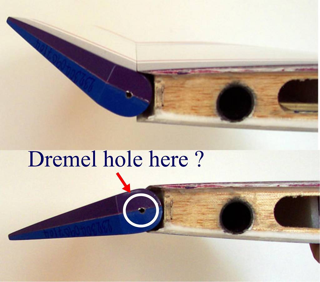

My Valiant arrived to me. Unfortunately on the left stab, the elevator movement is restricted to downward.
I could observe that an epoxy remnant causes this and it is impossible to clean it without disassemble the stab system.
To do it , I have to make a port on the bottom side of the elevator and grasp the wire axis to push it out.
Is there any idea ?

Personally, I would ask for another stab half to be sent . .
Otherwise (not having seen one), can you dremel a hole in the end of the elevator to grab the hinge wire with needle point pliers ?? It would be difficult to see that you did it once assembled . .
Cheers, JB
Cheers, JB

Thank you.
The other part of stab works very well. The elevator moves to both sides equally.
As seen in the picture, there is a small hole. It is enough to see inside with a
+3.00 telescopic lens under bright transillimunation. Unfortunately there is not any head of wire to hold. It is perfectly aligned with the hinge.
I tried to hit the stab on the side of the hole gently ,expecting the shifting of the wire but noting happened.
Also I drilled a hole other side of the elevator by using transillimunation to push the axe wire with a 1 mm wire. I knew that the probability of to do it was very low. I could not reach to the axe wire but the hinge.
I don't know internal structure of the elevator exactly. Only I can guess it comparing to the rudder. So to make a minimal damage on a very well painted and finished model, I have to chose a correct
place for entrance. Any knowledge is important for me.

erylidirim, greetings! Just an outside observation on my part, but this particular problem you are having should have been caught by the Quality
Control Inspector prior to shipment to you. That being said, Jeff Boyd 2 gave you, what I believe, to be the best advice to start with. I would want
to avoid any cutting/surgery to the actual flying surface if at all possible. Have you contacted the Company you pruchased the plane from and made them aware of your situation? Whatever you decide to do, give it careful thought and if possible, find an experienced builder in your area for some additonal imput. I build my own planes and am keenly aware of how something like this can easily become a nightmare with unintended
consequences. Best of Luck & Happy New Year__Everette

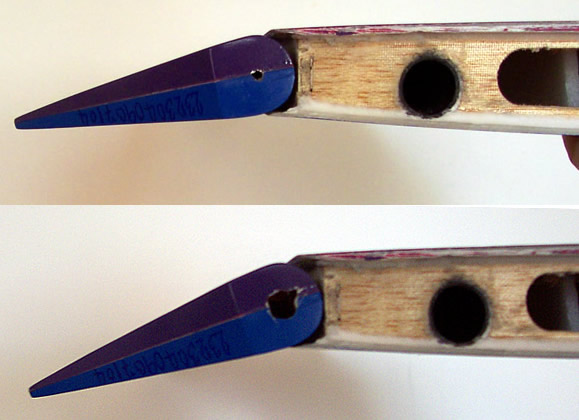

I drilled a hole in the end of the elevator to see how the internal structure was.
There is not a wire axe like rudder. There are 3 hinges (like Robat 310 hinge) and it is impossible to disassemble elevator-stab system.
Then I bended a 2 mm wire and sharpened its bended tip and reached to the epoxy residues through the hole in the elevator internally and,
through the gab between stab and elevator. I took two days to clean them !
Now elevator can go 25-26 mm downward. I hope it will be enough for snap and spin.
Also I wrote to Comp ARF.
