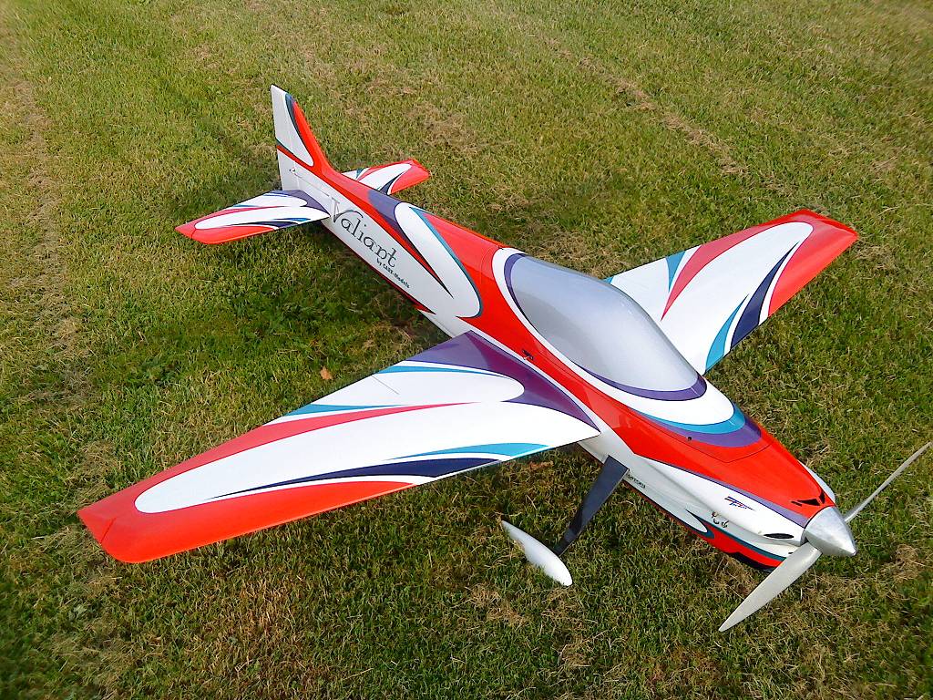

Here are pictures of my new Valiant after it's maiden flight a few days ago. I had the CG just aft of the center of the wing tube yet it needed 10 clicks of up to maintain straight and level flight. Therefore needed more down than usual on inverted. I had only one flight and am breaking in a new YS170DZ with an 18.1x10W APC. Not much time yet on it but a few more checks were done:
Hardly any aileron trim needed
Pulls straight up without any deviation, no pitch or yaw
Down line will need slight down trim with idle as advertised in the manual
Knife edges seemed good both ways without any significant pitch or roll though need more time to evaluate
Should I move the CG even more aft? That is what my experience tells me though it is contrary to the manual and where Hebert says the CG should be. My next try will be with a slightly more aft CG and go from there.
Gorgeous bird and it looks like it will fly very well overall.

I ran my CG on the centre of the wing tube, but increased the main wing incidence slightly. The elevator was then flush with the stab. This plane likes to have a forward CG, and you will need to push a fair bit when inverted.
I'd suggest you PM Bryan Herbest (you'll find one of his earlier posts) and ask him for his latest recommendation on setup with this plane. I know he has made some refinements on CG and incidence. Try his latest settings and let us know how it works out.

Had a few more flight attempts but my new YS is acting up, all deadsticks after a few minutes. I did move the CG aft by moving the battery aft of the wing tube on the vertical tank support, lightened spinner backplate, and 1 oz weight in the tail, so CG is probably just aft of the wing tube aft edge. Needed less down in inverted and all the tracking including up and KE still great. Maybe this will affect my spins/snaps? Too soon to tell. I PM's Bryan Hebert but no feedback yet.

One thing Hebert will tell you is you don't move the CG just to make elevator "feel" right for inverted flight. That's what God invented exponential for. Moving the CG too far aft on an Hebert design can cause some very bad spin and snap characteristics, and the rolls won't be near as pretty. He's actually in the process of re-trimming the prototype (since he was kind enough to lend me the airplane he was originally going to fly this year), so his mind is definitely on this plane at this time, and he will probably chime in here. I know he added tail weight to his this past weekend, but most of his radio gear is right at or in front of the wing tube with the exception of the elevator servos.

Bryan Hebert did PM me and assured me to move the CG back fwd which I did and I will see what that does. He also mentioned using positive expo on down elevator. Never done that before and I will see if that suits me.

OK you all I moved the CG back to the center of the wing tube and it is much better overall now. I have zero expo on down elevator. Great flying bird. Still dialing it in but I can see that it flies good already. Point and shoot, great knife edges, that anhedral seems to help like the Curare in the old days. It also looks better than most ships out there. I fly near sea level (60 ft) in the Seattle area.
