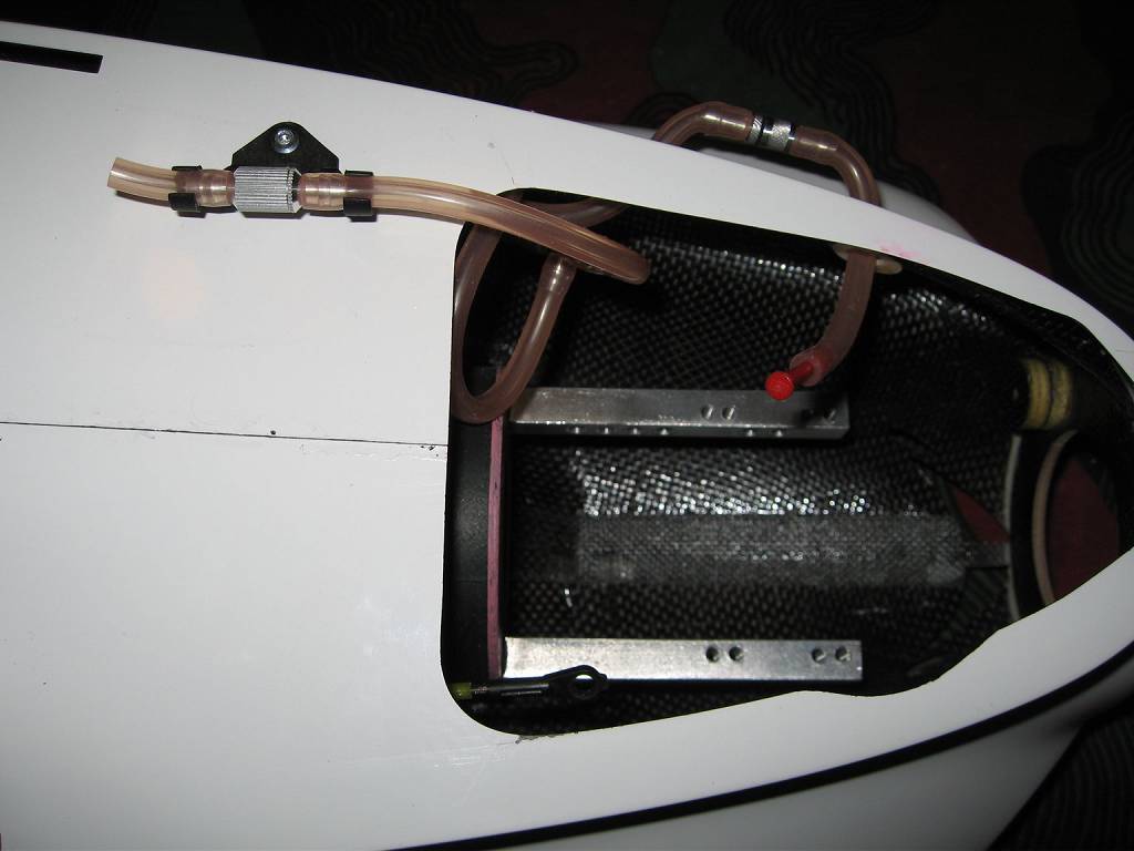

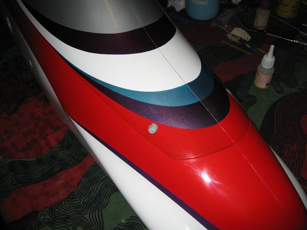

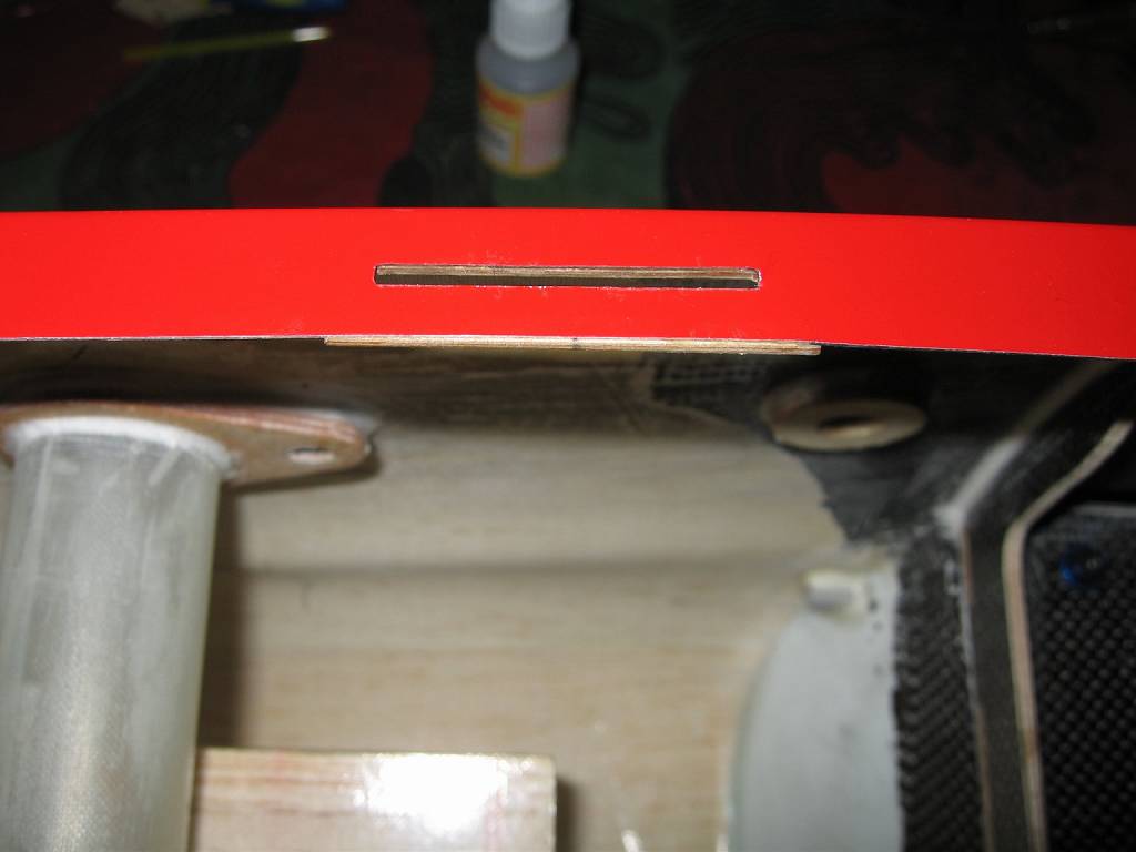

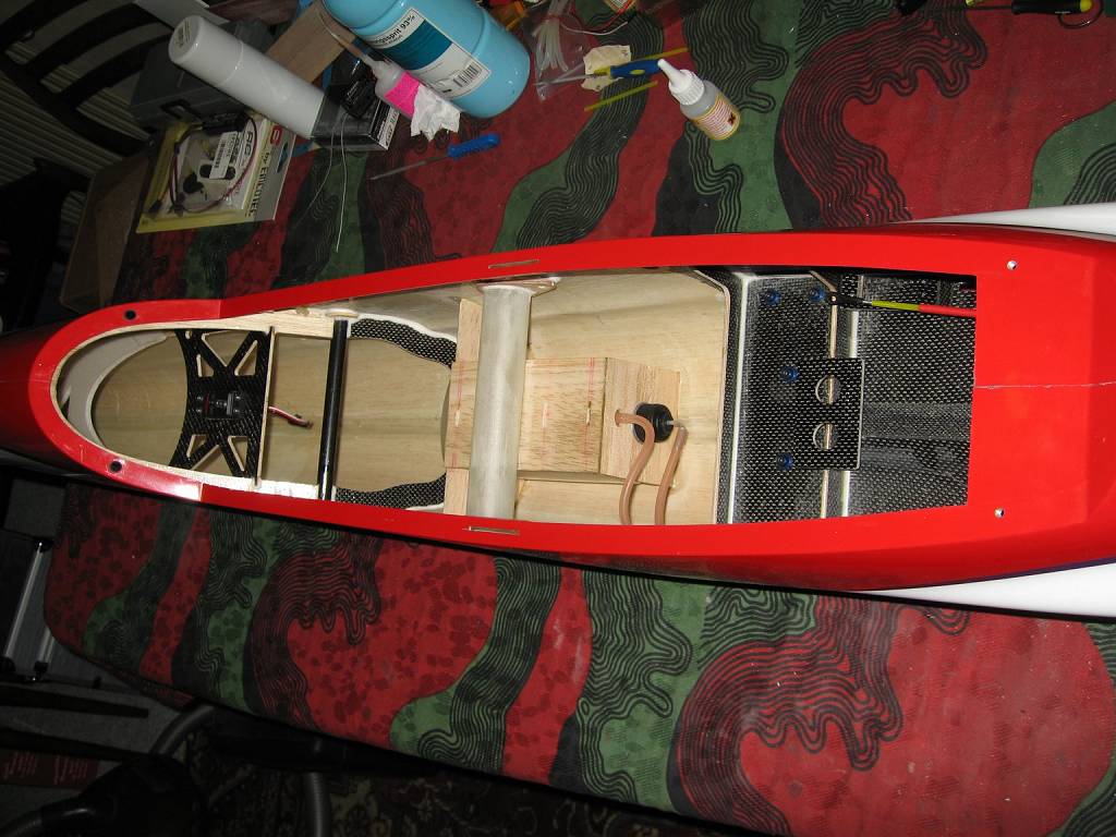

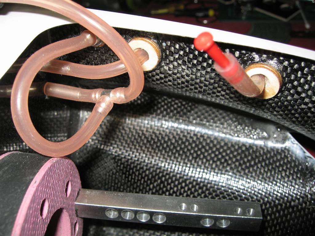

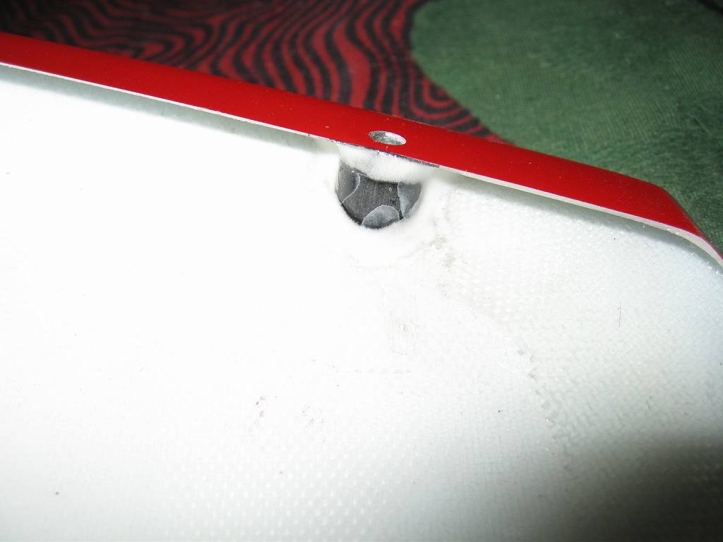

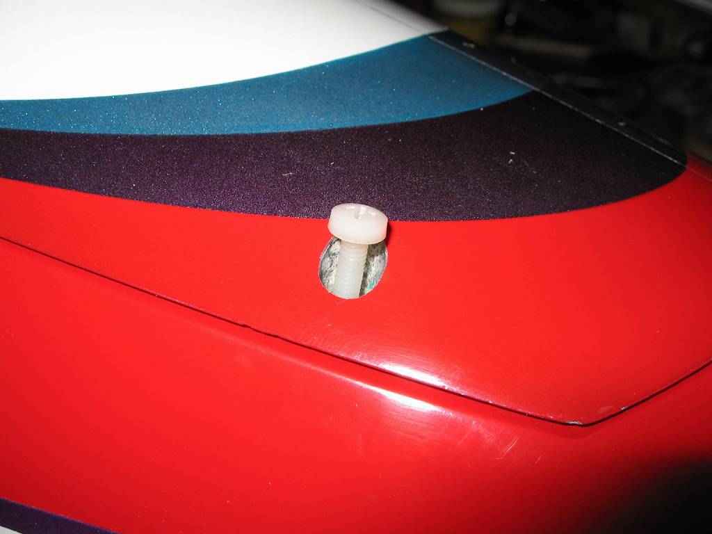

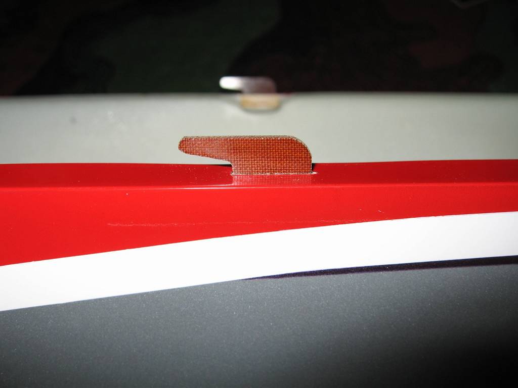

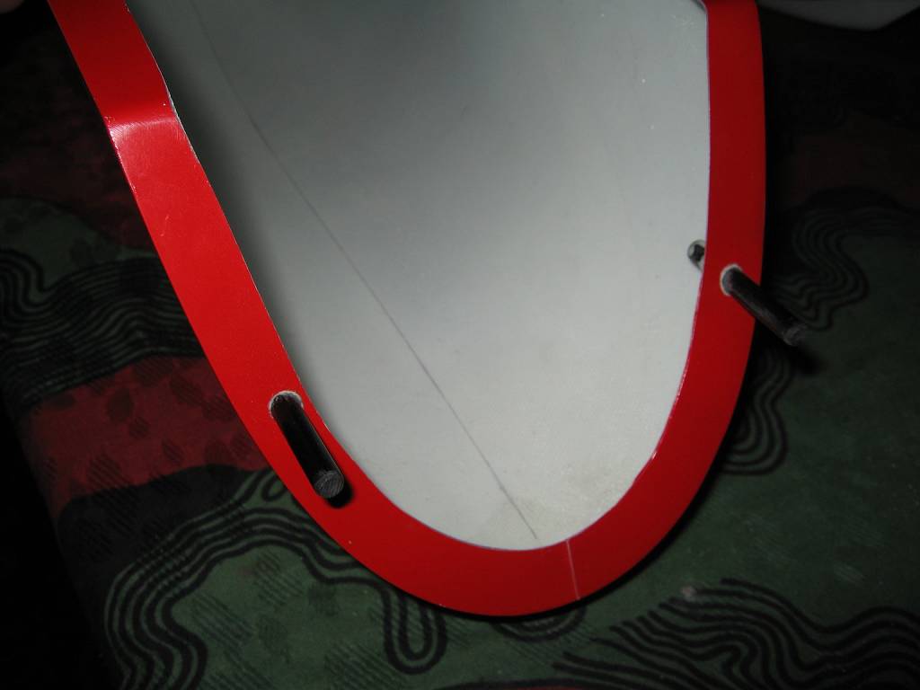

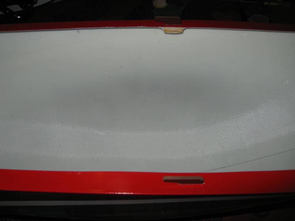

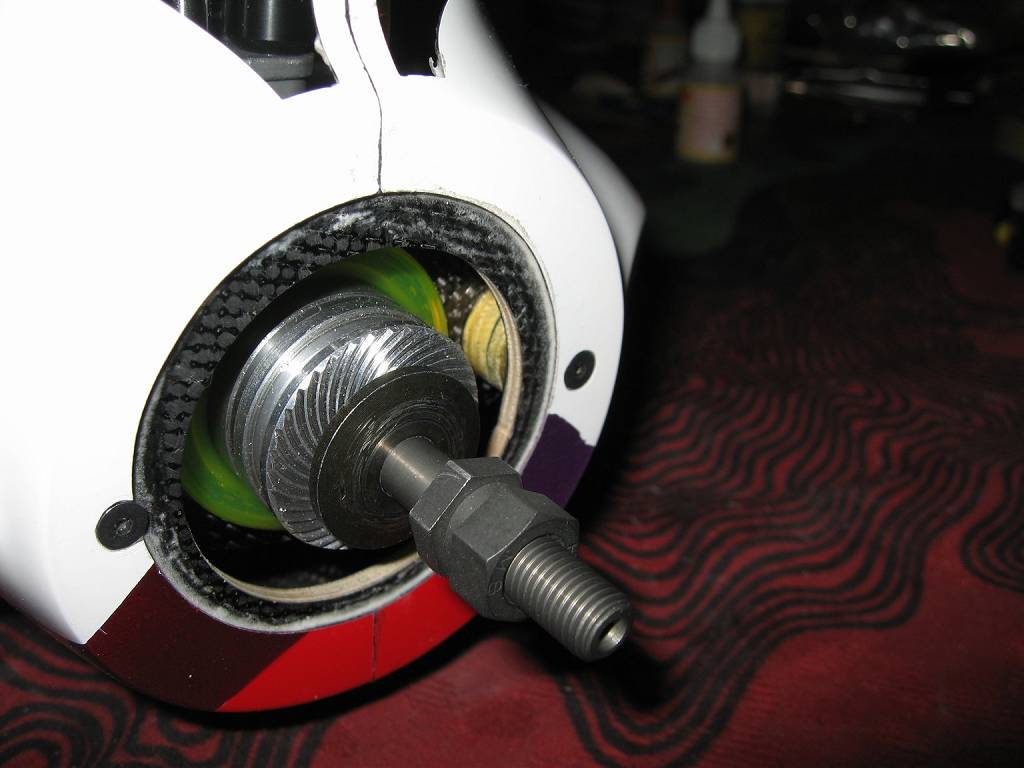

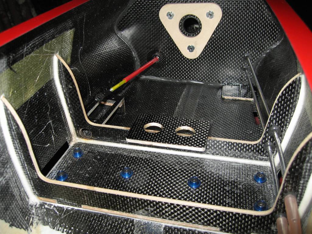

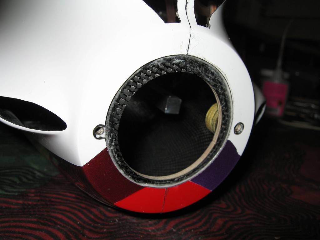

I'm building a Valiant as well right now, and I have attached a few photos of the installation FYI.
Notes about the plumbing: I was originally planning on using the CH 45° fuel fittings and have a clamp on the fuel line outside of the plane, however I drilled the holes to far down on the fuselage causing the fuel line to get kinked against the engine. Therefore I went back to an old school design instead with a fuel filter outside without the 45° fittings. If you place the 45° fuel fittings higher on the fuse side they should work as well giving an even cleaner/more pro look...

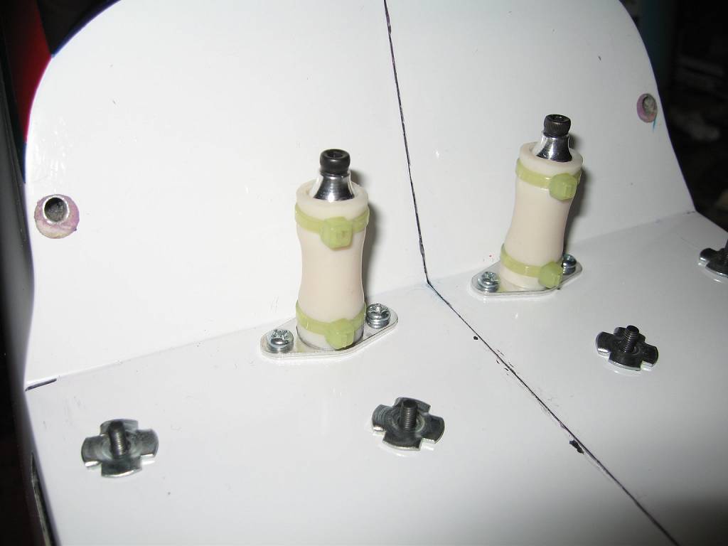

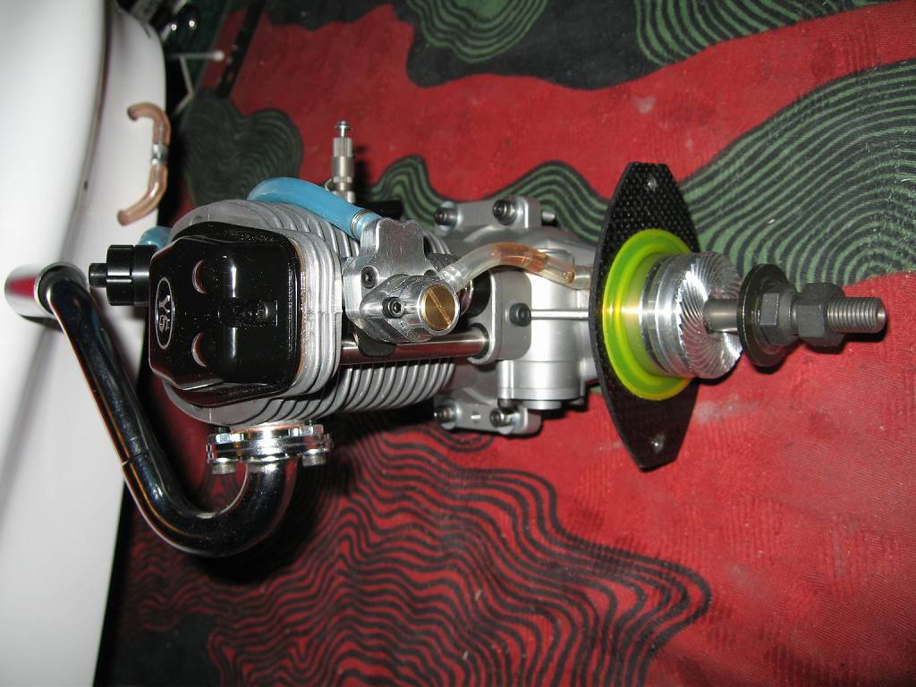

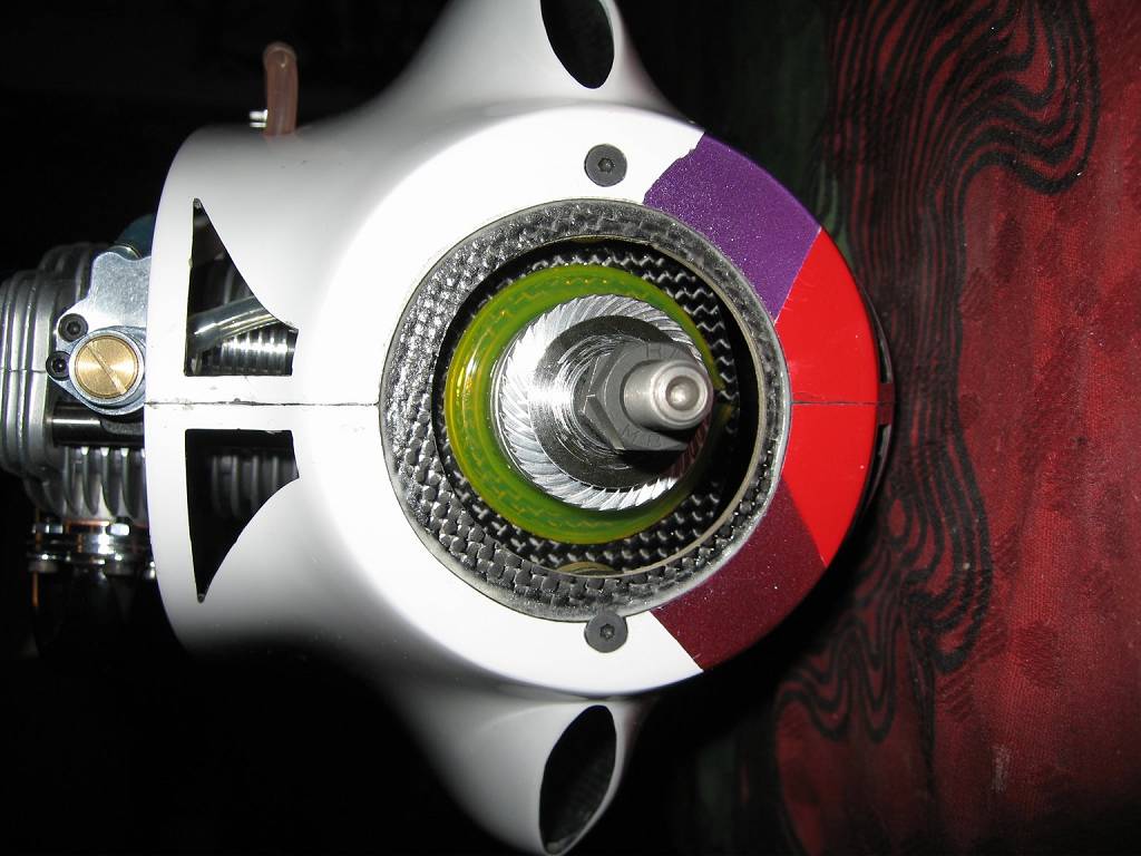

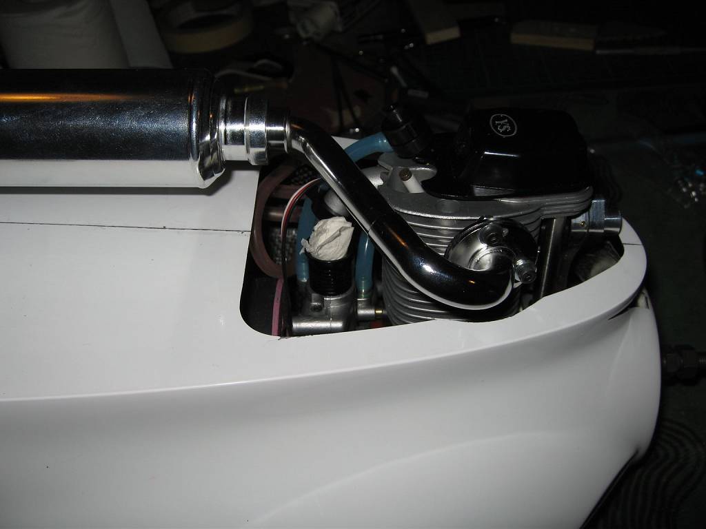

Notes about the engine installation: I would recommend tilting the engine slightly clockwise (seen from the front) in order to make the header clear the under cowling better. The cowling has a bulge in it to give better room for the header however.

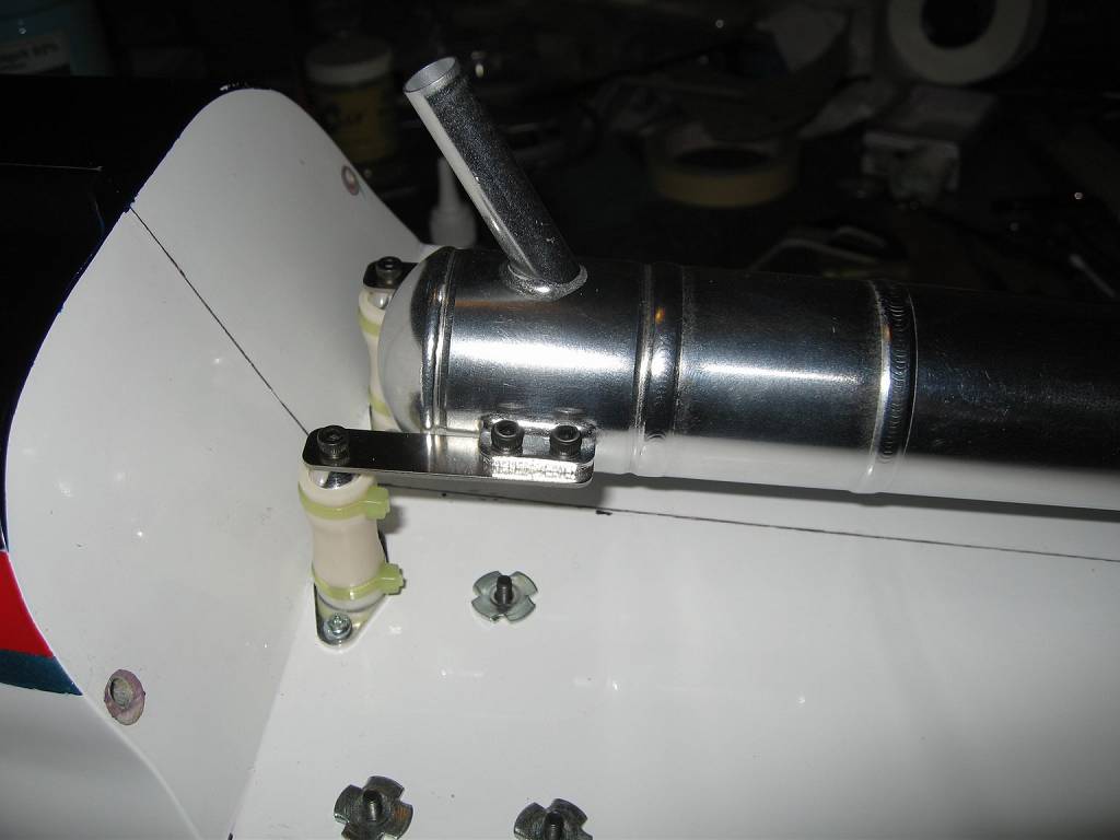

Notes about exhaust muffler: I have used the standard Hatori mounting hardware included with the muffler. I have reversed the mounting and screwed the self tapping mounting screws into the gear plate, should save a few grams since you will then not have to glue a support plate inside the fuse to attach the pipe mount to. You will have to use longer silicone tubing to get the pipe low enough. The original silicone tube is clear, but I had some white silicone tube in the right dimension and made two new supports out of it.
Notes about exhaust header: To avoid the header unscrewing from the engine I used an old trick I once saw on a Japanese web-site. They replace one of the 3mm bolts with a longer one that has been ground down to fit in between two cooling ribs. Should avoid a loose header when it hurts the most (during a competition....)

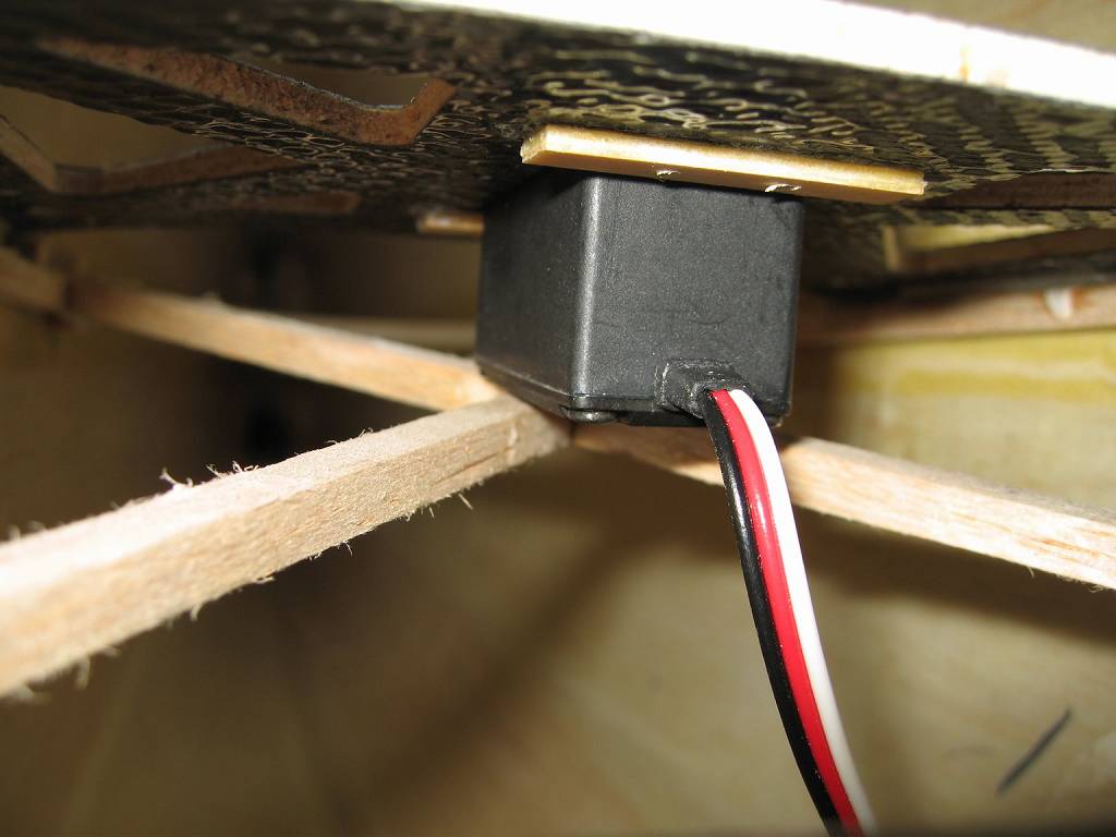

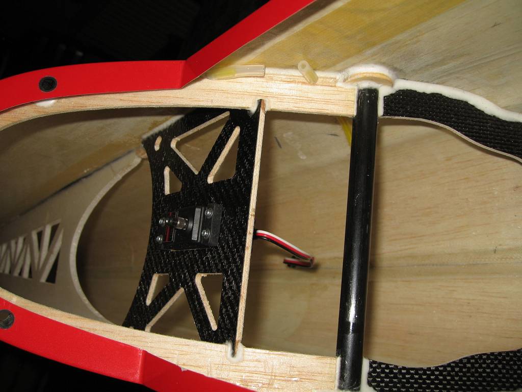

Notes about the rudder servo: In my installation at least the rudder servo would hit the cross brace installed below the servo plate, hence I removed it. Not sure that it is really needed on the Valiant since it is basically right underneath the servo plate. On the Integral it is behind the servo plate and highly needed in my experience.

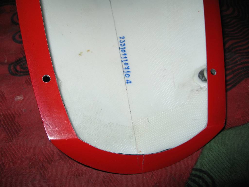

Notes about general installation: I have used a K&S 600ml tank, since I had one and they are very light. I used some of the included balsa fiberglass laminate plate included in the kit to make a tank support. I will be placing the dual LiPo batteries on the top shelf. I used two aluminium tubes to lead the fuel/air between the tank and the engine compartment, primarily to save a little weight compared to just running fuel tubing all the way, it also looks cleaner...

Hi Arch,
I like to have a closed system that won't leak during transport, storage etc.. I previously used the same type of plumbing system on my Zeque and Aries and liked it. Looks nice as well, but that is subjective naturally....
I'm sure your system works nicely as well, I'm just used to this system.

#110
Nice Shots Mola ,thanks,
Arch, I never defuel My airplane, I fly till dark mostly and can`t see when it`s time to pick up,
I also I carry my airplanes in my XC90 Volvo, They rest on a carpet backed folded seat setup so,
I don`t wan`t to have any leakage,dripping from the tank, vent lines EXC My wife would not like smelling cool power air freshener
If you have a just a vent ,it leaks a little all the time during flying, at rest from carrying the airplane ECT,you have to worry everytime about rolling the airplane over to check the engine ,roll back drip ,drip, ,ECT but with the check valve setup,I rarely have to clean the engine compartment. it stays clean.
Also if you have a two stage paint job like in Japan the paint is not fuel proof so any leaking from this area will crawl under the exit,,painting area ,and ruin the paint,, thats why guys are so carfull about this set up.
All of the paint in mold composite fuse paints will discolor a little with 30% nitro.as well if not cleaned ASAP.
A professional, leak free ,fuel setup makes a engine compartment tunnel area leak free ,and there is no chance for a ruined paint job
If done right you can eat off of the pipe mount,engine compartment area after 20 flights
It`s Just like if the engine is tuned correctly you can fly 10 flights and have almost nothing to wipe off the bottom of the airplane ,,,and pick up fuel economy to boot..so it`s about perfectionism really!
The only down side is you have to be carfull in the heat ,, a little clamp is all you need or remove your fuel dot from the exit in the vent line and put it in the fuel line while the airplane sets on the line ,,,then it`s vented like your system.
It`s the way I set all my airplanes up But,your way works ok too.
