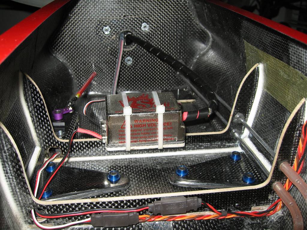

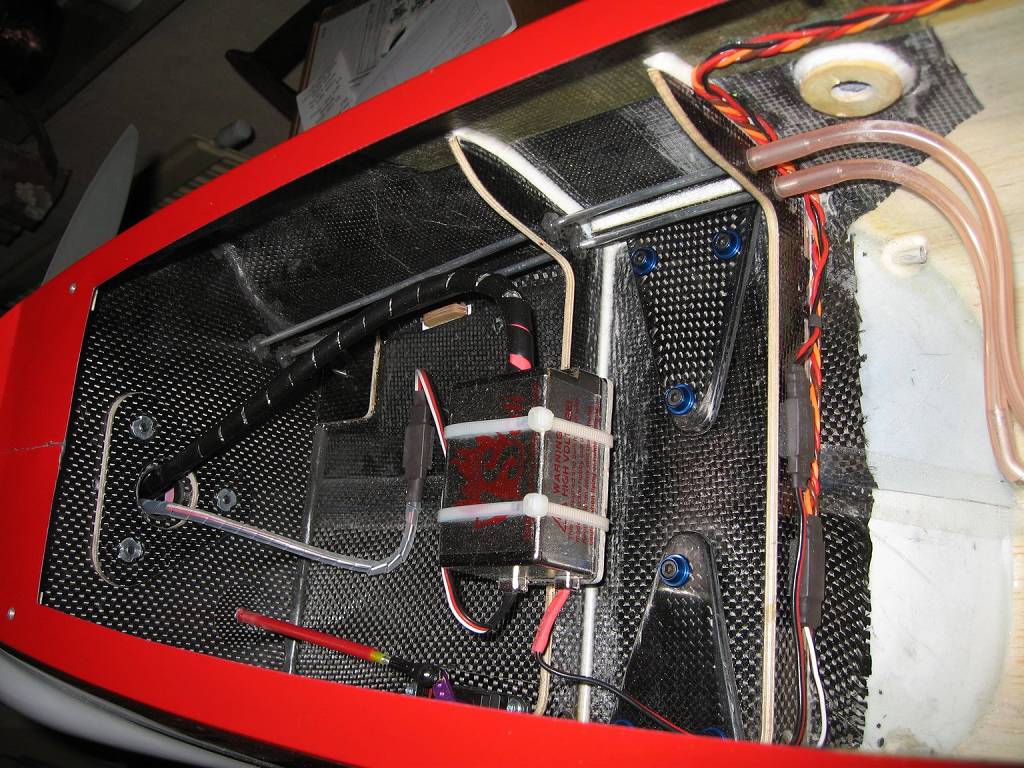

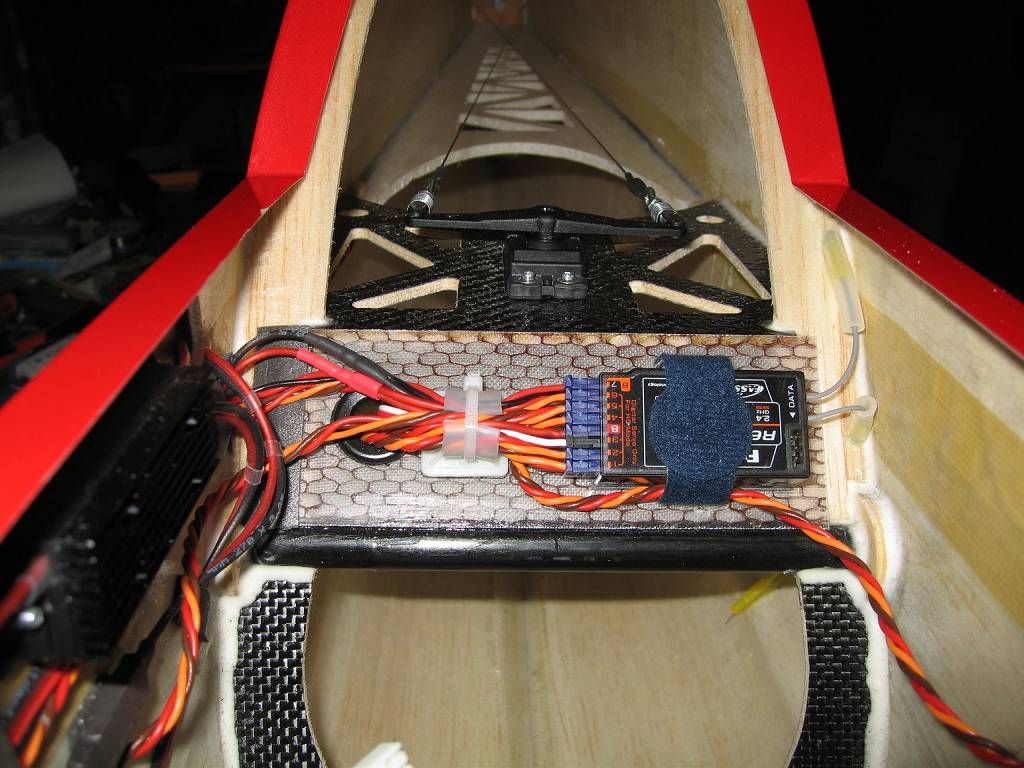

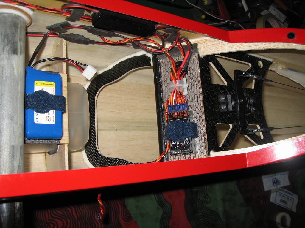

Now my Valiant is finally ready for the maiden I thought I would post some photos of the finished product.
The total weight is 4852 grams as shown in the photos, so there is no problem making weight with a glow engine, even a YS-170 CDI.
A few comments:
I have used Hayes Wing Saddle foam tape on the fuselage where the wing root will touch to avoid rattling. Actually the Hayes tape is two thin pieces of tape on top of each other, so if you separate the two pieces the foam will only be half as thick, which is ideal in this application.
The switch is an Emcotec DPSI Micro, and I have two 1100mAh LiPo's connected to it. CDI power is taken directly from the RX supply.
I made a new rudder horn out of fibreglass plate since the included horn will not fit properly.
The other horns are the standard phenolic horns but stiffened using 92 gram CF cloth epoxied to both sides. Has worked fine on my Integrals using the same ball-link setup without incident.
The aileron throw on my model is limited to about 20 degrees, will see if this is enough for crisp snap rolls.

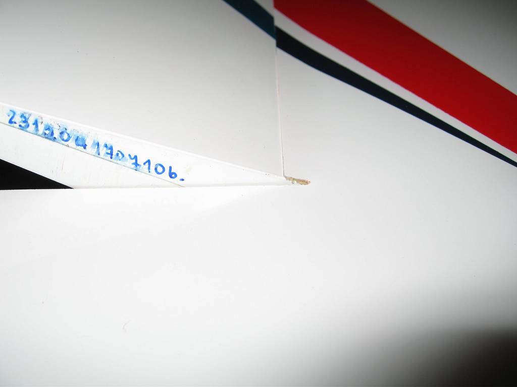

Yes the curve in the rudder hinge line looks cool but you do have to sand too much away. I would have preferred a straight rudder hinge line or one with a counter balance like the stab and ailerons. To me the rudder is super efective requiring a lot of expo. I think the counterbalance would soften it up like the stab and aileron. They require very little expo.

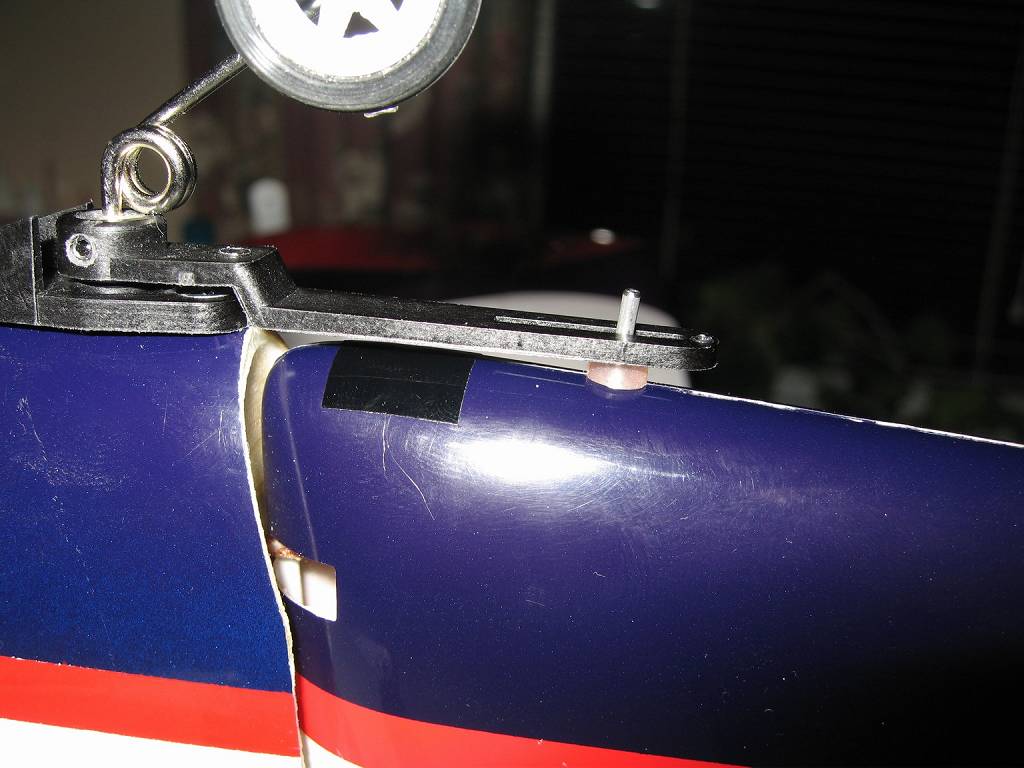

As Stuart says the wing skins are limiting the throw both up and down. When at approx. 20 degrees the wing-skin is being deformed quite much by the aileron and this causes binding. I was thinking about cutting a slightly longer slit at the inboard edge to allow the wing skins to flex a little more... The skins also limit the elevator throw a little, however I think I can get more than enough elevator throw.

Hey Guys I have either built or handled 7 of these airplanes and never had a problem with too much restriction on the skins,although on the last 3 I have seen they have been cut back slightly.
The only one specificly bult for me was the first one, and it`s the same as the rest.
It`s no problem if the skin rubs a little on the aileron ,or even deforms the skin surface it`s made to work that way there is flex material laminated in the skins there.But, I usually take a piece of 320 sand paper and turn the smooth side down, slip it bewteen the skins and the le of the ailerons and work it some to give clearance so they dotn rub and wear the paint off over time.
Trust me 20 deg is a lot of aileron throw on this airplane But I like it a little faster
The rudder Well ,that set up is not the Best But ,it don`t bother me much once it`s in the air.
You will never need more than 18 deg of throw either way on the elevators. My set up is 14 deg up and 18 deg down elev. max throw

Hi Morton
looking at your pictures it looks like your down aileron throw is being limited by your control horn installation this can be a problem,
and is why I did not use the kit control arms ,I sunk a dowel and tapped it for a 6/32 rod.
I would cut a relief there to allow the aileron horn to slip in .

The aileron horn is actually not touching the skin, even though it looks like it in the photo, however after closer inspection I could see that the red paint had already rubbed off the aileron on the outer corner of the skins indicating a lot of rubbing. I have now tried sanding the skins as you recommended, especially at the outer section, and this has worked some. Also I have lengthened the inboard slit slightly to let the skin flex a little more in this area, and the result is that I can now get approx. 25 degrees of throw each way, although with a little servo buzzing... Should work OK now.
BTW this was only a problem on the left wing panel, the right panel had significantly less resistance, and actually the skins flex less on the right wing panel at the same aileron deflection.
