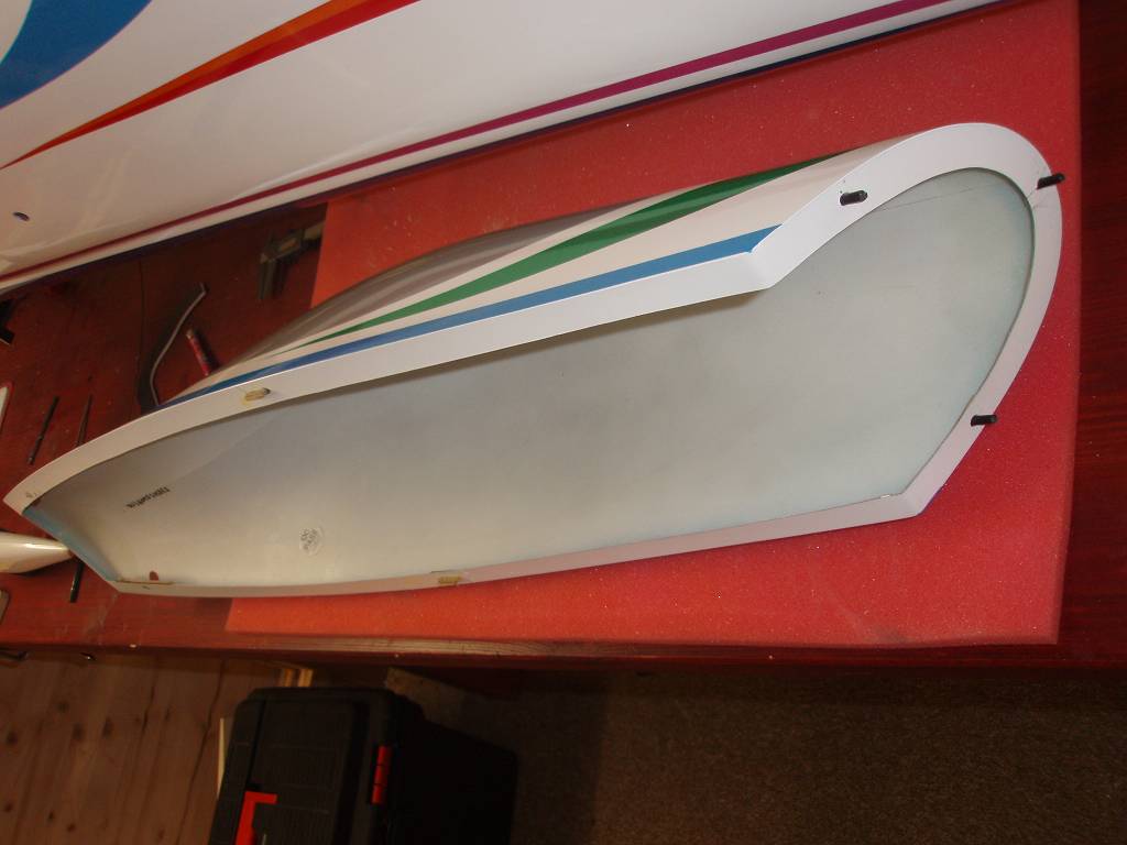

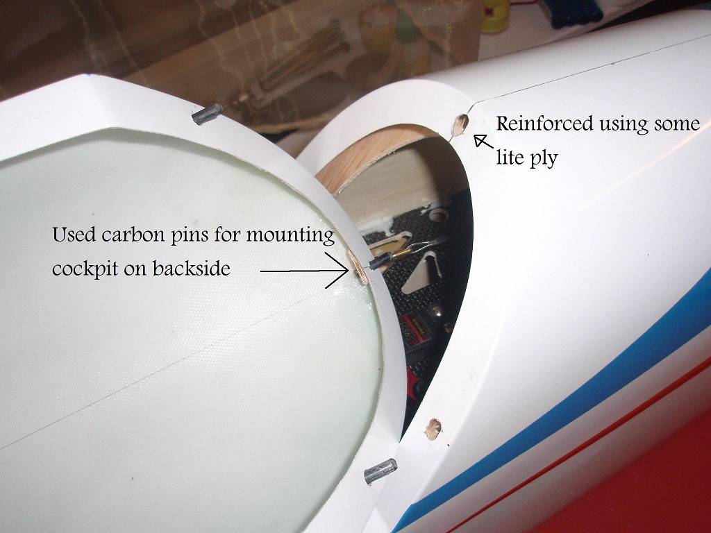

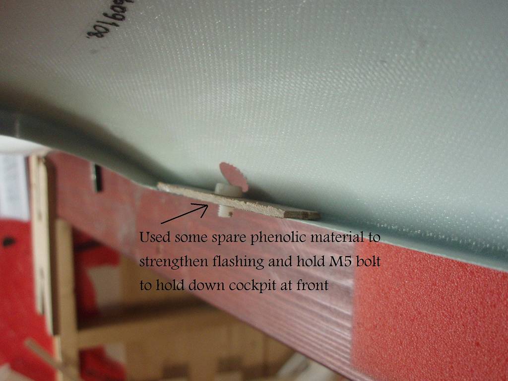

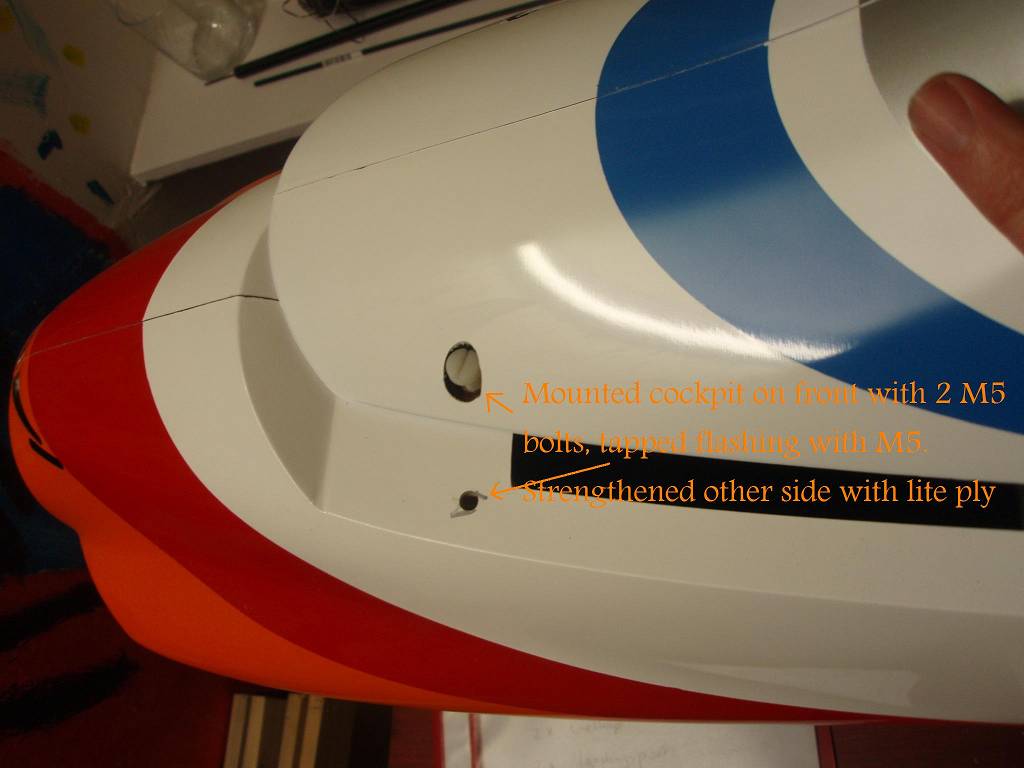

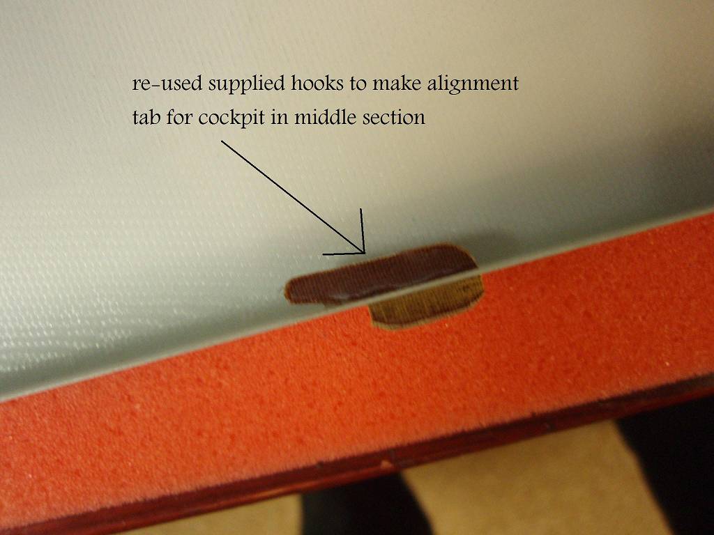

You want pictures, you get pictures!!
Here we go:
1. mounting cockpit. About the only part of the build where you have to think yourself....
ID:	1536414   Click image for larger version

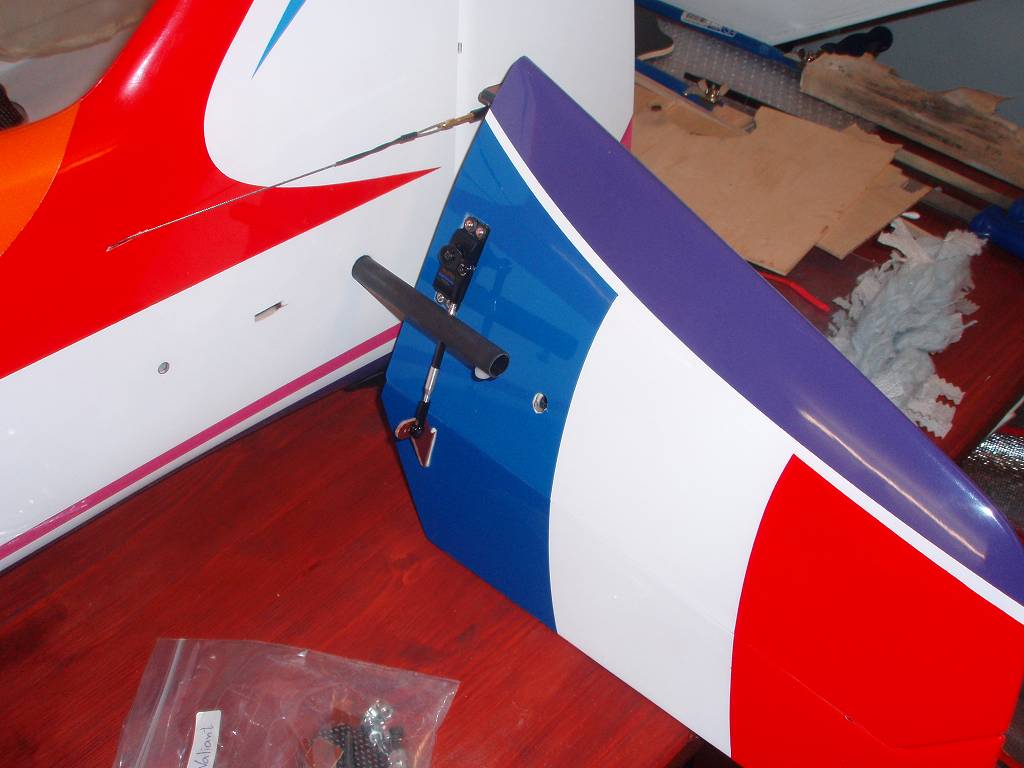

details on wings and stabilisers. I used the same methods for the linkages.

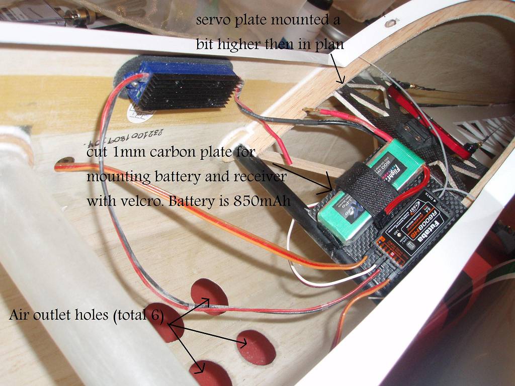

This is really hard work! I can only upload one picture at the time!
Here some others, I wrote the details in the pictures:

Equipment used:
Futuba 6008 HS receiver
JR9411 2x for ailerons
Futaba 9351 for rudder + SWG extention for extra throw
Futaba BLS153 2x for elevators
850mAh battery
Emcotech Single bat switch. I always remove the charge wire and 2nd receiver feed wire (saves 6 grams)
Volkert

ORIGINAL: wagen017
Volkert check the tightness of the connector. They can be a bit loose. A backup feedline is not bad in that respect.

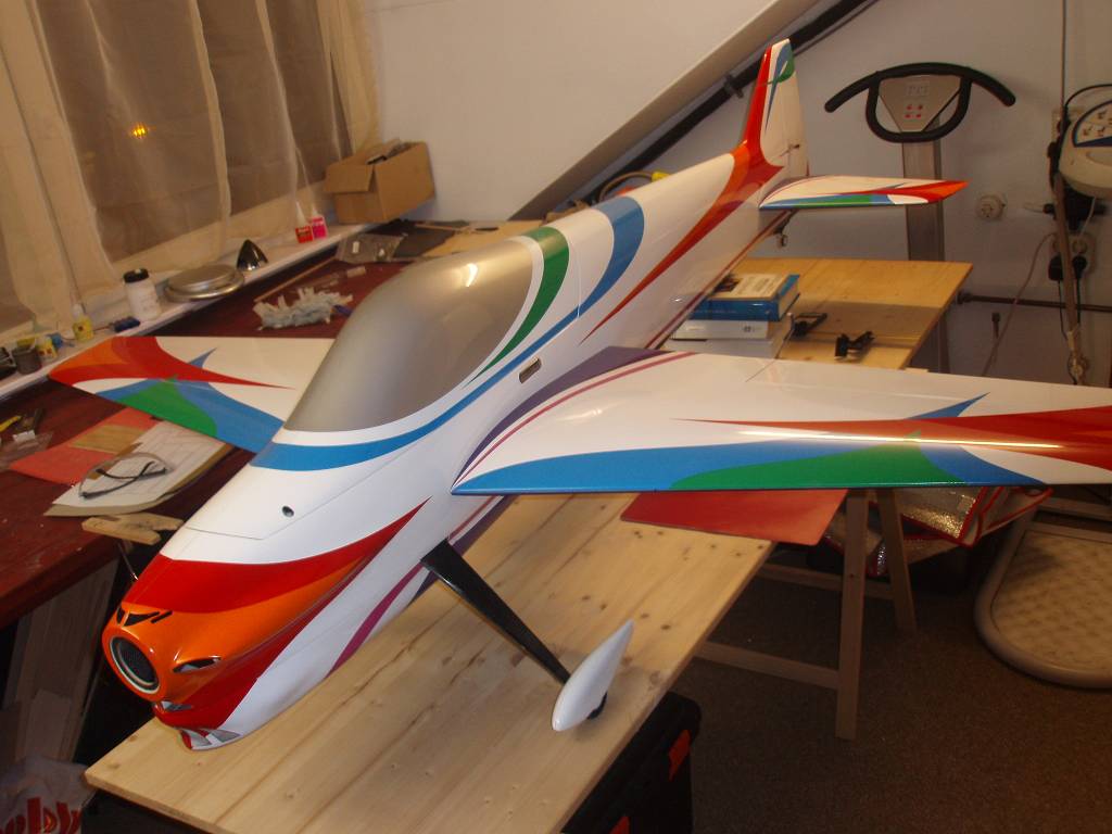

today put my Valiant together to check alignments and work on the throws. This is a great plane and I love how it looks!!!! Also the build quality is great. For those of you that like the Jason Schulman scheme, they are still available even if it is not mentioned on the website so get one while you can!!
If I take the cockpit railing as my zero the plane actually came out quite flat. A little incidence on the wing (0.2 degrees) and no incidence (0) on the elevator halves.
I wonder about the incidence measurements, anybody did measure them?
Another question on the throws. In the manual the throws are mentioned for the snaps (23 degrees aileron, elevator 14 up, 18 degrees down, rudder 20 degrees). I wonder what the normal throws are.
Volkert

Here with the picture, couldn't upload it yesterday!
Volkert
