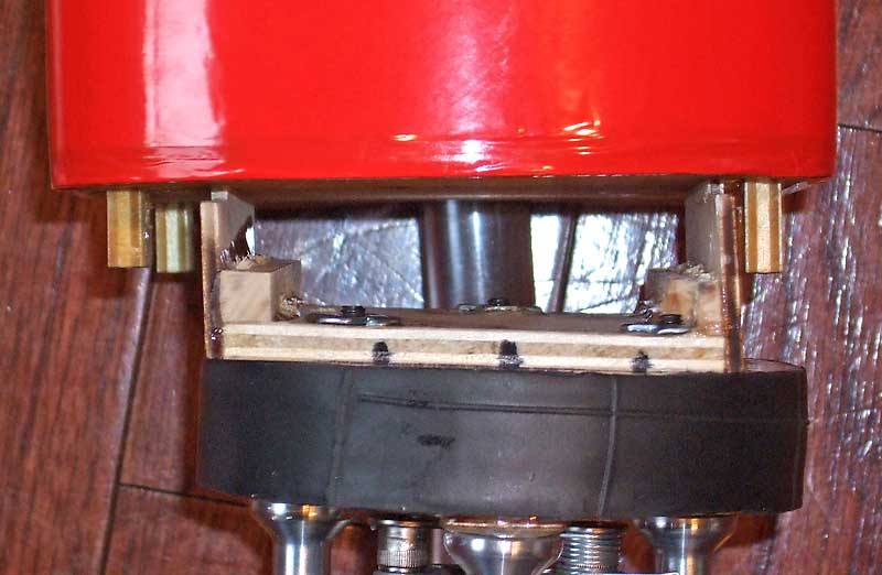

Just obtained a custom vibration isolation mount for the Syssa. Actually it was plywood, and balsa yesterday morning. Made mostly from scraps I had laying around. I had to purchase a tube at a mower shop but it was only $11. I did two layers of rubber and it mad a really stiff mount. Instead of end grain balsa, I used 1/4 inch dense balsa sheet and cut the spacers. I put 8 bumper pieces between the disks to stiffen it up at idle. The only thing of concern is that the way I assembled the back plate I will need to watch the length of the firewall bolts. Guys, thanks for the motivation.

Looks great! Did you make sure and wash the rubber really well with soap and water first and with rubbing alcohol second? The release agent used on the rubber has to be removed completely in order for the rubber to stick long term

FlyEng, Looking Good, MAN!!
It took me a minute to see how you did the firewall mount for the back ring, but then I saw what you meant by having to watch the bolt length since they will be coming from behind the firewall. It will be a little tricky to align and install, but it's something you have to do only one time. Once you're happy with the position, perhaps use red Loctite and you won't have to touch it again.
When you have a chance, it would be nice to see some pictures of how you did your spacer rings. I have been thinking of alternate ways to do that.
Good job!

Matt and Bob,
I used rubbing alcohol and scrubbed the tube with a cloth. Then I roughend the end by sanding and then cleaned with alcohol again. The many little cuts in my fingers from splinters etc. really showed up when dowsed in alcohol. My day job keeps me at a desk so the skin takes a pounding when wood working and such. Especially when I'm being stupid and holding parts instead of clamping them when sanding and cutting. Fortunately it's been some time since I stuck an exacto blade through a finger. Scar is still there though.
I may still drill through the front and install bolts in the back. Is there a down side to this? Bottom line was that I didn't have the proper bolts with domed heads to add them and I got in a hurry wanting to finish. It defintely will be tough to mount in the Focus if I leave it like it is.
I didn't take any progress photos mostly cause I didn't think it would turn out anywhere near as good as it did. I did buy a circle cutter at ACE for about $10. It made the second and third disks much faster. Oh yeh, I cut three. The first which took forever to make was cut from 1/8" aircraft ply. I decided it wasn't thick enough. And, after cutting and sanding and sanding and sanding to get it round, I had to find a better way. Thank you circle cutter. I'm sure it will be of use in the future. Oh, and it made cutting the balsa spacers a piece of cake. The only issue with the dense balsa spacers was that the CA didn't wick completely through. I thought about drilling small holes all over both disks to perforate the depth but I chose not to do that. I hope it will be okay.
Cutting the rubber with a single edge razor blade on a plastic cutting board worked really good. I have a part of a cutting board left over from cutting firewall backers for flat bat combat planes. I finally found a use for it. That thing was stuck behind a box and will get used a bunch more for cutting balsa etc. DUH. Never thougth of that before. You know, cutting board means preparing vegitables, fruit, and meat. It doesn't usually come to mind to cut balsa, rubber, covering, etc. But using the cutting board with a stiff straight edge after a couple of practice cuts, I was able to make the final inside band with one cut. The outter band I trimmed in place once it was glued.
Looking forward to pointers on the engine. I'm going to start with the Xoar props mostly cause of the weight. Man are they are nice lookign, too. Balanced it by spraying clear gloss on the lite blade. Didn't take much either. Very nice props.

ORIGINAL: FlyEng
There is no down side I can think of, unless you don't have fairly easy access to the back of the firewall to install blind nuts....then it could be a pain. BTW, 3 or 4 4-40 bolts is all you need to mount the soft mount to the firewall, but 6-32 is probably easier to work with.
These mounts are a little stiffer than the commercial units (assuming you can even buy a commercial unit for the SAP engine) but the nose ring is not necessarily a must. I've done multiple snaps with my test bed and the mount damps very quickly. The stiffness has not hurt my servos in many hundreds of flight. In my primary plane I am still using original servos with a similar mount up front
I've seen commercial units allow engine flop all over the place on the ground when the engine's nose wasn't supported, simply by revving the engine up and down.
Another BTW, 1/8 A/C ply is okay to use. I use 3/32" or 1/8" normally. On the spacer, if it's firm balsa you're fine.

I don't have nearly the depth of experience on this as Matt, but the photo below shows about how much room there is to work with - not much!! None of our custom mounts are the same thickness, but I would imagine they fall within a 1/8" range. Depending upon which stand-offs you use (6.25" Syssa standard?) you could even end up with 1/4" less space than I did with my spliced stand-off arrangement which was right at 6" for the soft mount-to-thrust-washer distance.
In short, I think it will be a lot easier if you use Matt's method to tunnel in from the front.
BTW, After this photo was made I epoxied triangle stock into the corners where the motor box and firewall meet. It is very rigid and does not need cap pieces of ply for the top and bottom of the motor box. That sucker ain't goin' nowhere, especially with the soft mount taking out the sting.
