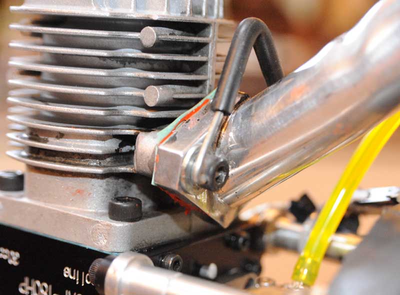

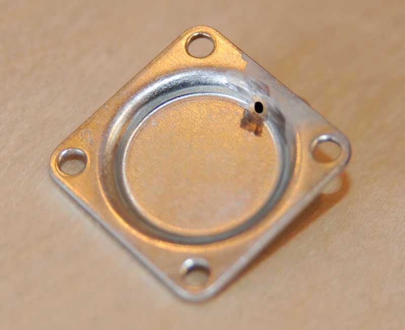

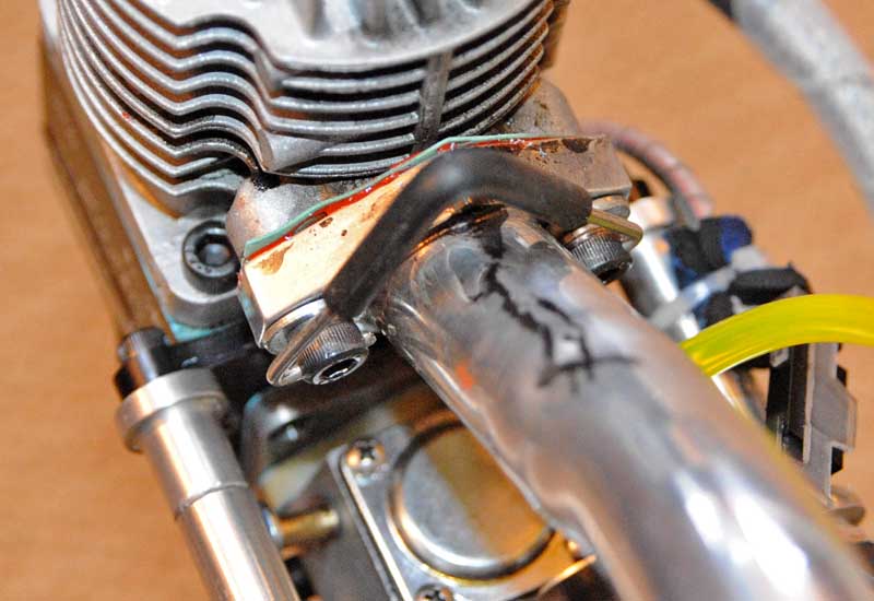

Matt,
Something else I did - which concerns the issue of erratic running/sagging when doing an outside loop - is to put a "static line" (if that is the right term) on the little ambient pressue plate (if THAT is the right term) to counter the pressure changes in the cowl that I suspect cause the erratic running. This worked before when similar issues were encountered with aerobatic models.
Depending on conditions tomorrow, if it isn't too windy and one of the fields where I fly is clear of snow, I will try to get in some more flights. At the very least I'll run the engine some more.
My soldering isn't the best (use one of those little butane torches from Radio Shack) but it is solid and clean.
Also I noticed that the header bolts were loosening up, so I drilled through the bolt heads and made a little "clip" from 5/64" piano. Don't know if this will work either, but it's winter and I am trying to do this since I'm not flying much!

Matt,
Something else I did - which concerns the issue of erratic running/sagging when doing an outside loop - is to put a ''static line'' (if that is the right term) on the little ambient pressue plate (if THAT is the right term) to counter the pressure changes in the cowl that I suspect cause the erratic running. This worked before when similar issues were encountered with aerobatic models.
Also I noticed that the header bolts were loosening up, so I drilled through the bolt heads and made a little ''clip'' from 5/64'' piano. Don't know if this will work either, but it's winter and I am trying to do this since I'm not flying much!
OKAY THEN!!! That time it worked

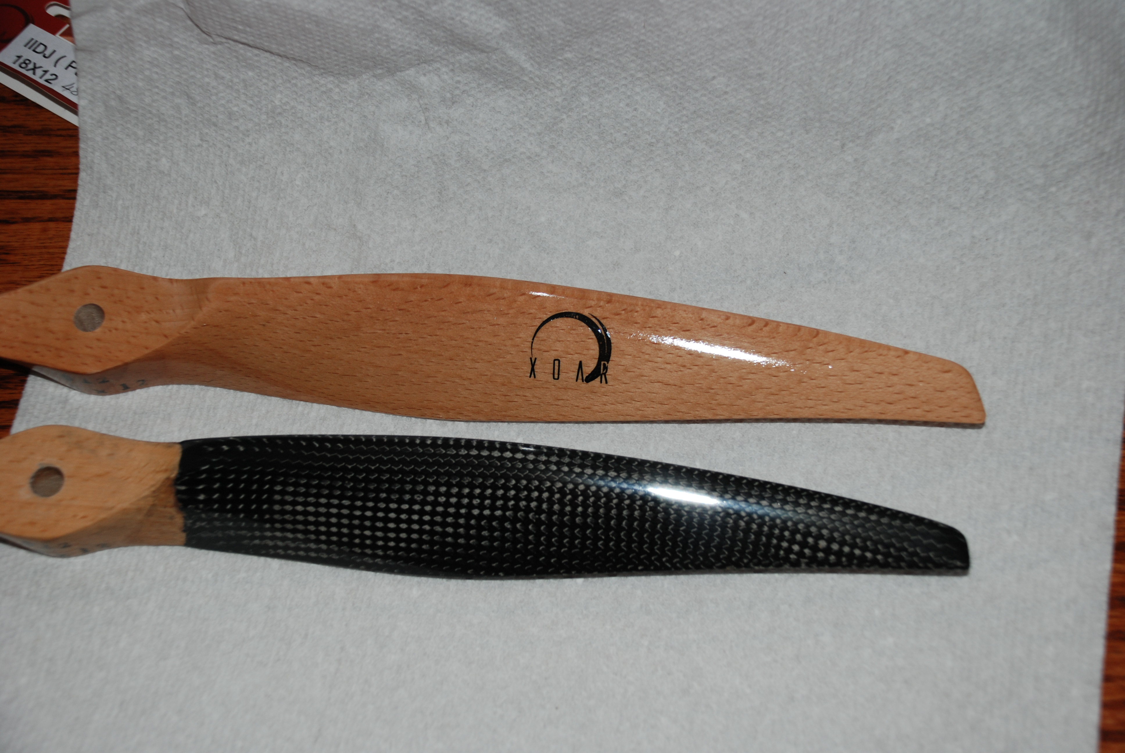

Anyway, planning to do some bench running today on the 18x12. Here're a couple photos

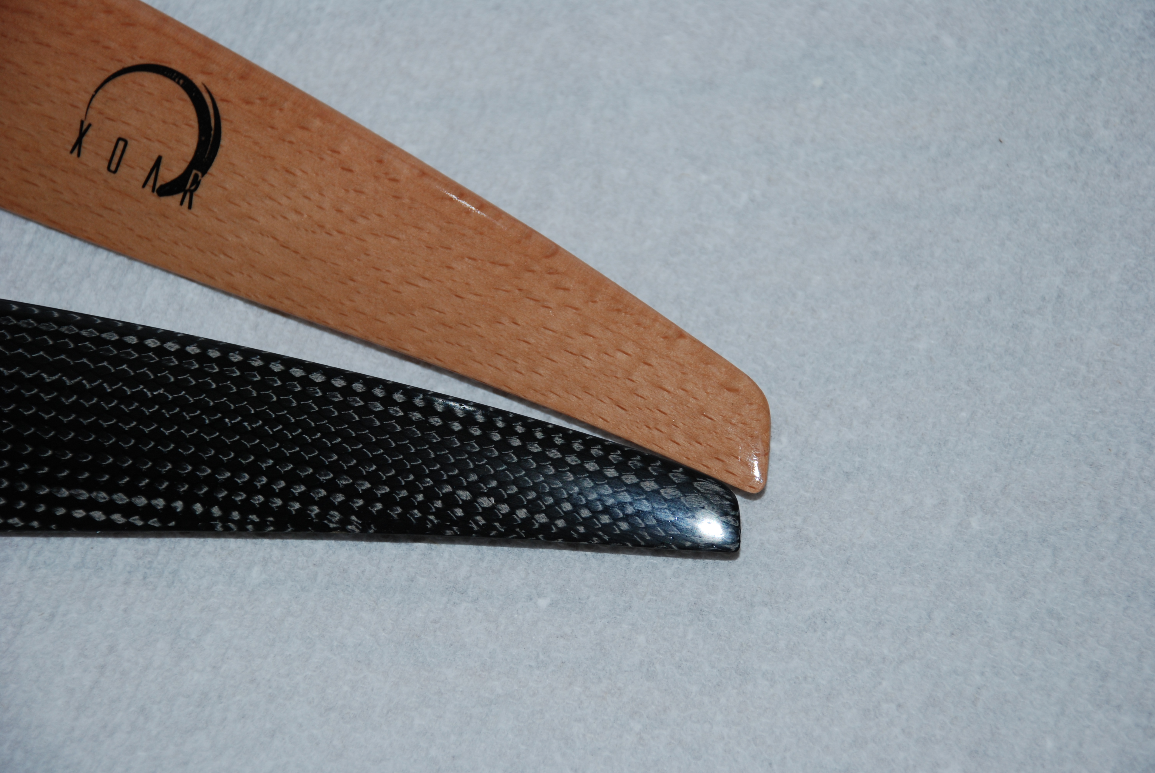

And one more; this one shows the stock wood tip and the modified, carbon covered tip. Having that much area at the tips loads the engine down unnecessarily. Much of the work is lost to tip vortex (drag) and noise

ORIGINAL: can773
DAMN! That is a nice looking prop Matt!
I hope you described how you did that somewhere
I am preparing an article for MA on how I do it. Of course it isn't the only way to do the carbon cladding but it's the way that works for me the best. I don't have the verbiage written fully yet but do have the photos. PM me if interested

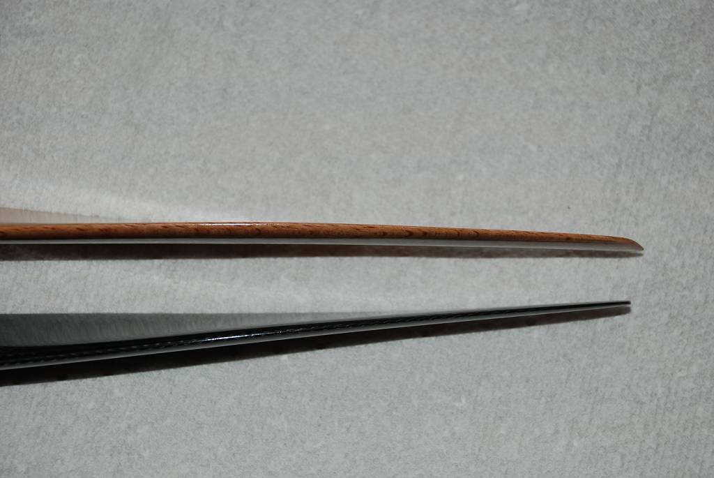

Neither did my first one. The prop in the photo has an epoxy paint clear coat on it. A little polishing (Finnesse It) and that's the end result. Final weight is 52.5 grams
Matt
PS- this photo shows how thin the tips really are and the fact that the hybrid's tips have been de-pitched

In that case, I may try 27-1/4''.
Out of town for work this week. Won't be able to get back to it again until next Monday, if then. Having some remodeling done in the house after that as well, so it will have to take a back burner for a while.
You are right, we don't want to run shorter than 27 1/8'' plug to baffle. Longer is okay (don't know yet how much longer is tolerable).
Determined that the low needle was slightly rich. Leaned it about 1/16 turn and now the LOW needle is just under 1 1/2 turns open. The HI needle was not touched and still is at 2 1/8-2 3/16 open. Stretched the pipe by 3/8" and that, combined with leaner low end, eliminated the jumpiness at 1/3 throttle.
Making the pipe length measurement more convenient for myself, the distance from the plug CL to the end of the pipe (not including the stinger) is 33 1/2" straight line. That's approximately 27 1/2" plug to baffle.
Top end rpm is higher than my ear perceived originally...I tached it at 8200 after the changes. Pretty terrific!! Throttle response is now about as linear as anything I've played with before and with the amount of output available from this powerplant, the 10 pound Aesthesis will fly in style.
