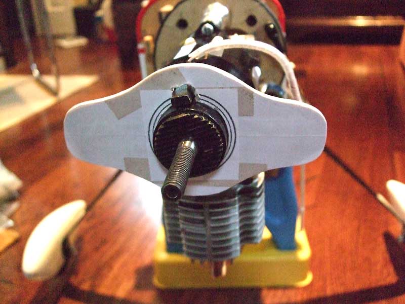

Here are the photos of my work in progress. Lots on work still to do. I still need to reinforce the boxmount connections with small dowels or screws, fuel proofing, throttle and choke controls, lengthening the pipe tunnel and reshaping the formers, fuel plumbing,andfixing out of square wing tube. Yep, it's off almost a 1/2 cm from side to side measured at the ends of the wing tube. Thatputsthe adjustment at about 3mm for each end. Does anyone know a good way to loosen up the glue at the wing tube brackets inside the fuselage?Would heat do it? Obviously with the ARC version the covering isn't an issue at least notyet.
I decided to leave the box extending through the former inside the fuselage. I think this will make a good place to mount the ignition components. Besides, if i don't like it or don't use it, I can cut it out later.
Any suggestions are welcome.

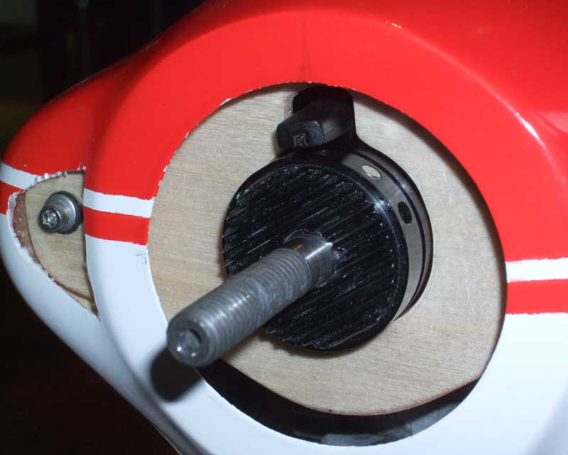

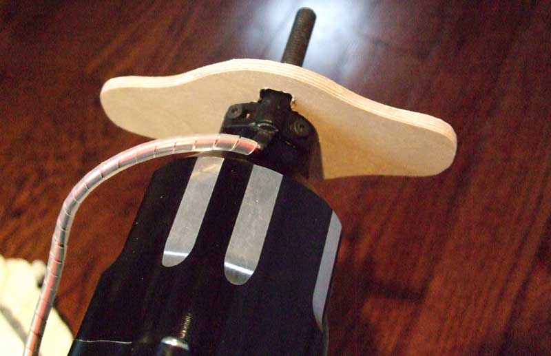

Nose ring
OK, here is mine, such as it is.
It is probably a bit bulkier and uses more material than necessary, bit I figure it is always easier to remove excess than to have to go back in and beef it up.
The nose ring itself is made of 4 sheets of 1/32" birch ply laminated together to make a 1/8" 12-ply - very rigid. As can be seen, I didn't line the inside of the ring with anything, just tried to get a very close fit between the hole and the crankcase so that there is no slop.
I got in 4 long flights last Saturday and it held up fine, with sound levels the same as before and no knocking or other unusual noises. The spinner moved around very little before, but now there is virtually zero movement. The only adverse effect is that one of the cowl screws loosened a bit.
The cowl was weighed before and after the modification and the difference was 26.5 grams. After the various mods I've done with the coupler, canopy, nose ring and fuel tank, the plane's current AUW is 10lb 11.7oz. I put in a 16-oz tank but I think I will go back to the 12-oz tank eventually.

Nicely done! If you want to recover some of the additional mass, you could cut off the chunk of aluminum on the carb that is normally used for the idle screw, and 1/2 of the steel throttle plate that is near there as well.
