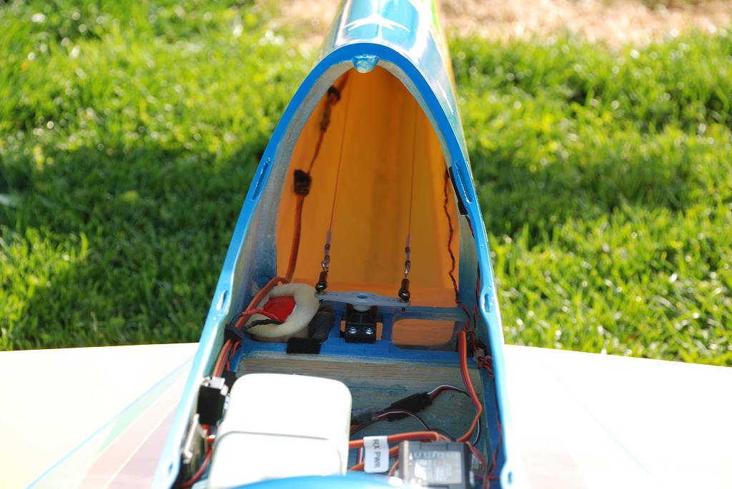

Bob,
I carved and fitted a ring from lite ply. I epoxied it in the fuse nose, not the cowl. Ground the excess with a Dremmel drum.
The ring is a piece of 1/16" aircraft ply, laminated with glass cloth. 2 oz cloth 2 layers, ca'd in place, but epoxy would work the same.
Then a slit piece of neoprene tube was fitted inside it. The neoprene tube is not tight against the ring....the hole in the ply piece is oversized. This way the neoprene tube serves as shock absorber, even though there is little shock at that point; mostly rotation motion. I ca'd the neoprene tube to the nose ring.
Nose ring (the part that fits the engine) weighed around 5 grams. Nose ring mount (ring epoxied in the fuse) weighed maybe 10 grams including epoxy and blind nuts.
Old 10-25-2010 | 10:49 PM
  #1354
MTK
Joined: May 2004
Posts: 5,386
From: Whippany, NJ
Default RE: SAP 180 (Syssa Performance)
The plane to this point is missing pipe installation, landing gear, rudder servo, Rx and battery and IBEC. Can't hardly wait to get it DUNN.
Weight is under 8 pounds to this point, so my estimate of around or just over 10 Lbs, finished, should be very close.

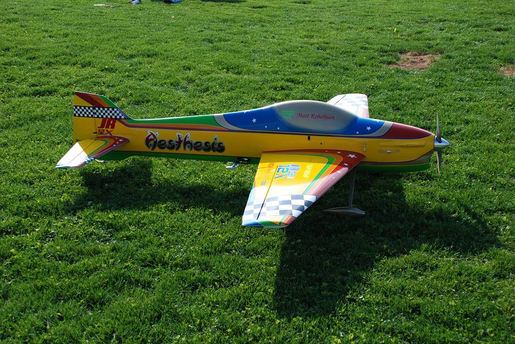

Aesthesis flew her maiden today. The SAP 180 HP is just too danged light....Aesthesis is a tad tail heavy. Originally intended for the ZDZ40, she was set-up accordingly. Need figure out how to put nose weight in and not add any extra weight.
Anyway, she came in at 9 lbs 24 ozs on the nose. The SAP has no problem hauling this bird around.
Have a little trimming to do which is normal, but first feel is very positive. I am pleased! A little disappointed at her tail heaviness but pleased overall. Here are a few photos from the too windy session this morning

Steve and all,
Thank you. I have a 3000ma lipo that I will place right behind the firewall. It adds about 2 ozs to the weight of the current set-up. That will enable me to fly all weekend on one charge. At least it won't be dead weight.
Not much I can do to lighten the tail....stab is about as light as I can build. I may have a little more latitude with rudder, making it smaller. But won't know whether a smaller rudder is feasible until I get some more flying under her wings.
