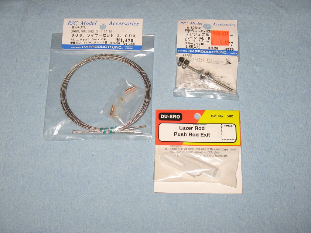

Rudder cable installation is pretty straight forward, and Jet Legend did provide us with cables. However, I have been using the IM rudder cable for the past two years with good results, it's a bit easier to set up than the Du-Bro 4/40 kit. Again, factory has pre-installed two ny rod inside the fuse for the cable, making installation a snap.

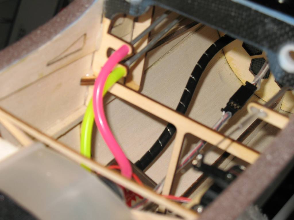

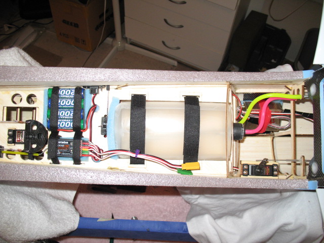

Wiring are pretty much done. Nothing really tough, just needed to plan ahead of time on placement of each wire. I used to install the rx on/ off switch on the outside of the fuselage. However, ever since I accidentally turn the sliding switch on during transportation a few years ago, I have since placed the switch inside the fuse with an IM switch extension.
Next step is the tank installation. For some reason, Jet Legend only installed two sets of velcro strips for securing the tank, but decided not to have any catch/ blocking in front of the tank to prevent it from sliding forward. Originally, I was thinking of either gluing two pieces of velcro – male & female – on the bottom of the tank. Or, gluing a piece of light ply in front of the tank to prevent it from sliding. However, my buddy – Don Atwood – custom designed a piece of wood block for me on his home made CNC machine which enables me to have a professionally look installation. Thanks again Don.

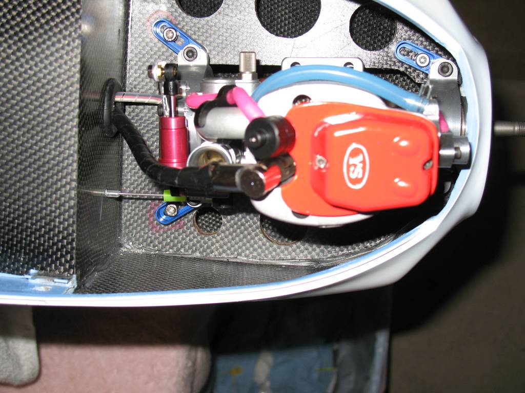

Even though, I have been using the YS engine mount for quite some time, however, I do not have any experience on using the mount with a YS nose ring & mount spacer. I have always used a customized bracket for attaching the mount to the firewall, and also some after market nose rings. These spacers are specially designed for the rail/ platform type construction in the engine compartment. Since I have had no prior experience on the set up, I decided to use the spacers supplied by Jet Legend. Later on, I may switch to the YS brand to find out whether there are any differences in terms of noise & vibration.
I first installed the front spacer with the nose ring, and align it with the nose of the plane. Then, follow by the two in the back before dropping the engine onto the spacer. It took a bit of an adjustment at first to get the spinner back plate to align with the nose, since you have four separate adjustment point. However, once you've get used to it, it's a very simple process. In addition, it is also very simple to change the thrust line. After the initial installation, I have noticed a very slight up thrust, and cured it by using washers to shim both sides of the nose ring. Jet Legend has also supplied us with throttle cable. However, I'm sticking to my Nishioka one.
Plumbing is almost done. Instead of using all fuel lines for both carrying & overflowing fuel, I have been using light weight aluminum tubing for the past few years with good results. Next step is to hook up the fuel lines in the engine compartment with fuel dot/ T, filter, check valve & angled outlets. After installing a wooden platform to house the cdi unit, I will install the landing gear and pants. My last step will be to tackle the release mechanism on the bellypan, which even though is not necessary, but will give me much satisfaction if I can pull it off.
More to follow ...
More to follow ...

For the header & pipe, I wasn't quite able to get them to line up properly at first. I've tried all different combinations – 822 & 823 header with 29 & 37 mm Nishioka pipe mount. Finally, I settled on the 822 header with the 37 mm mount. However, I still have to prop the pipe mount with two pieces of 1/8 wood block to get the correct angle. If you install the header & pipe correctly, you will not see any oil residue on the pipe deck and the bellypan, unless the engine is not tuned correctly. In addition, the pipe's O ring will last much longer. I have had planes for over 200 flights with the same O ring.

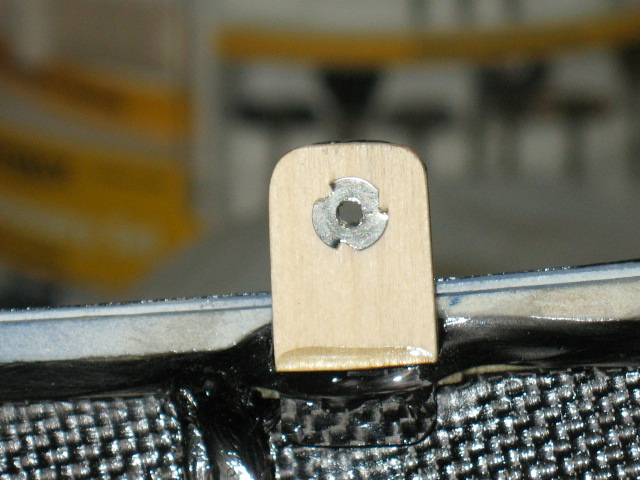

The first thing is to install a platform for the cdi box. Normally, I would install the platform further forward closer to the back of the firewall, for easy connection between the two short sensor wire. However, because of a cross brace limiting access to the bulkhead area, I had to install the platform right in front of the tank. In addition, a short extension wire has to be added between the male & the female plug.

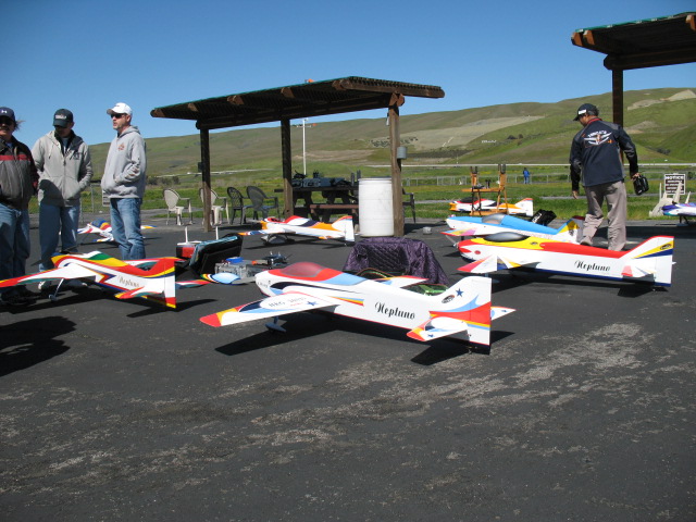

A few pilots from Nor Cal braved the cold weather - by our standard anyway - for a Neptuno introduction party at the Morgan Hill flying site this morning. Derek Koopowitz's glow & E version, accompanied by my 170 cdi version were on display. Derek was even gracious enough to allow any interested party - except yous truly - to test flown his e machine. When asked why I was not allow to fly his plane, Derek cited some compatibility issue between mode 1 & 2. And I thought these computer radio will fly the plane automatically by just turning on the switch, guess not ...
Anyway, those who took part in the test flight was quite impress with the plane's capability.
