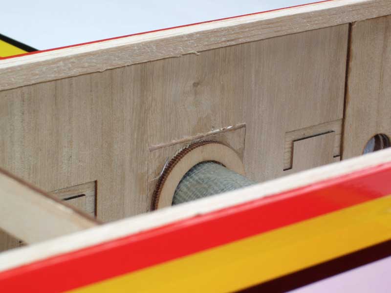

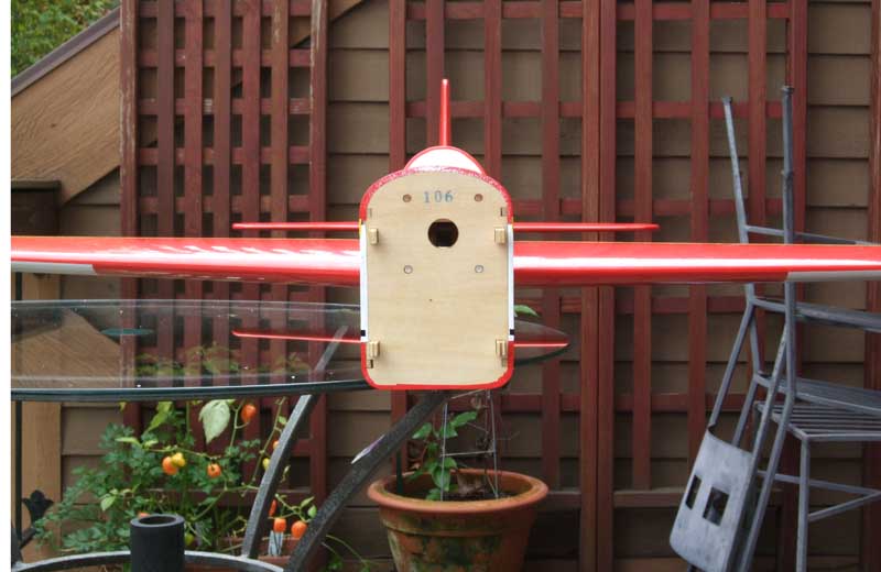

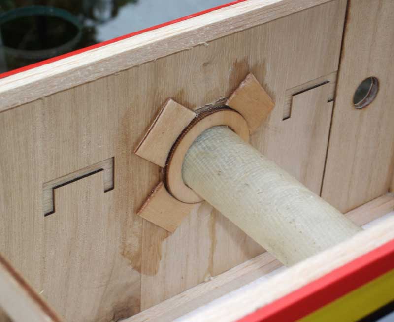

I'm really enjoying the Focus Sport with a YS 1.10, having lost my Venus II w/OS 1.20 FS-E (non-pumped) in a mid-air last June.
It's not really a fair comparison because the OS had lots less giddy-up than the YS, but overall I'd have to give the advantage to the Focus Sport because it flies more crisply and precisely. Rolls stop quickly, snap rolls don't "wallow" like they did with the Venus II, and the Focus Sport tracks much better in tight-radius pulling and pushing maneuvers such as shark's tooth and square loops. On those same kinds of maneuvers, the Venus II would kind of mush a bit before the stab would come around.
That said, the Venus II was MUCH easier to assemble because it had none of the quality-control problems the Focus Sport has. With the Focus Sport you had better know how to build, because there are lots of things - mostly small and annoying but some big problems, such as the crooked wing tube - that will require substantial building skills to correct. When reading through Troy Newman's build thread I wondered why he seemed to put such heroic effort into assembling an ARF, and having done it I now know why.
But if you hang in there and work your way through the issues, you will be rewarded with a very nice flying model.

Building, or perhaps re-engineering.[] I think I've still got a dent in my forehead from banging the wall.
Well, I must have gotten over it (or maybe I'm a glutton for punishment) because soon I will be assembling a Focus II with the Syssa 30cc gasser and ES pipe.
None of this is to say that the Venus II is by any means a crappy plane. Far from it; I had several hundred flights on it and learned many new skills such as slow rolls, clean stall turns, knife edge, and so forth... and it was very low maintenance, because of the robust design that you mentioned earlier.
Crooked wing tube? Seriously????? Wow, now that sux! I wonder if you got a bad one or if this is a trend.

I don't know how many of them are like this, but if you search RCU/web I think you will find mine was not the only one.
I'll post a couple of pics - and my fix - later when I get back to my home computer.
Definitely not for the beginner, the faint of heart or the easily deterred.[&o]

I guess I got hold of one made on a Friday after a 9-mimosa lunch.
When I got home, there was a big box containing a Focus II, so I hold no grudge against Piedmont!
After this I will bow out because I have nothing else to contribute toward the topic at hand, but the pics show the wing tube thing, and the fix. Self-explanatory, I think.

Those pictures do tell the story. Production errors are common with ARFs. That is why I prefer to build my own from a kit. You and I would never let that happen in the first place. You can also pick through the wood supplied in a kit to make sure it is straight and the correct density for the intended purpose. A quick trip to the LHS and you can substitute at will.
