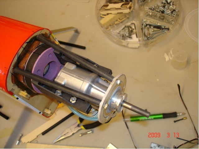

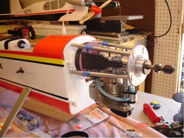

Bob - Thanks for the suggestion, and I may get what you advised asap, take a look in a minute. I purchased the Hatori Pipe, for tunnel, etc., then decided not to do it. They made that mod also. I talked to the guy's at Piedmont, they suggested the NR, with the Hyde mount. I saw a nose ring set up on I think, "Ed's Pattern Page", from SPA site. I did that, not exact, but close. I have taken some ribbing about it, but running with the cowl off, spool up, it seems to work, and a little bracing on the side's may be in order. Picture enclosed. I was concerned about the NR connected to the cowl, maybe too much flex at the cowl front?
Keep you posted on initial flight's, etc.
Vince

Now that truly is a nose ring Vince. Wow, good work. I will use an OS120AX on my FS if and when I get one. I don't think the 2 cycle engines, (and that 120AX is a very smooth one), need soft mounts or nose rings, at least I have never seen those things on any engines except 4 cycle ones. Would any of you guys use a Hyde mount and the nose ring if you were using an OS120AX??

Now THAT is a nose ring![8D]
Yes, I am very dubious about the cowl-mounted ring and how long it will be before engine vibrations shred the cowl. Likely I will end up with something like yours, using CF tubes and 1/8" 5-ply beech.
Same thoughts here concerning the Hatori... considering the weight/complexity/cost/necessity... just ain't there.

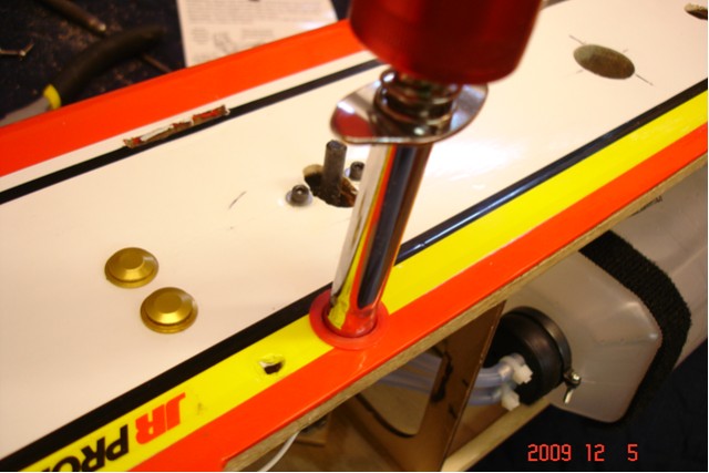

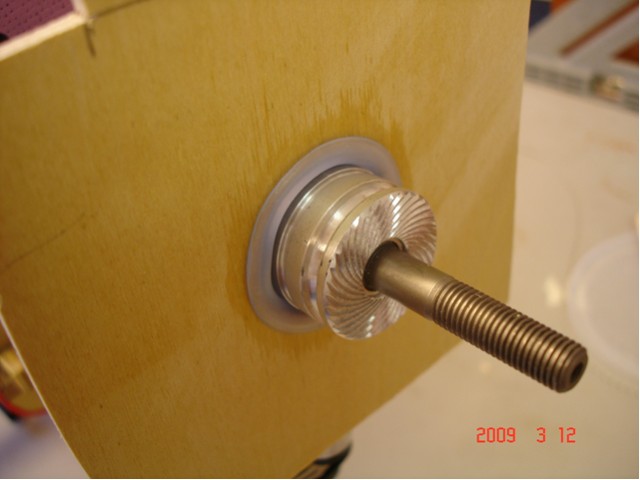

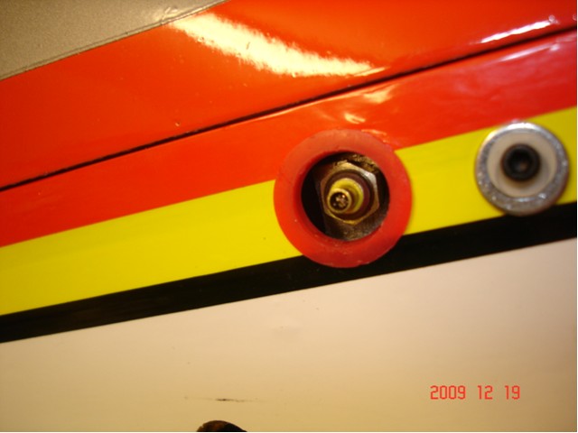

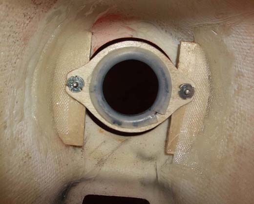

Couple more picture's. Ply cut for fit, then glassed with 2 oz. cloth. CF tube's, sink 440 female's in firewall, aluminum 632 females on front of tube's, then aluminum males to fit from outer NR. Picture also, side mounted glow lighter, sullivan has the best I can find. Very tight fit, clearance around glow plug, no problem. Keeps hands from under the cowl.
Vince

Wow, even better!.... I thought it was all aluminum from the first pic.
I'm filing this away for future reference. Likely I will need it.
I like the remote glow, but I didn't put one on because of weight and because I thought the vibrations would flex the wire to death in short order. It'll be interesting to hear from you if it holds up.
