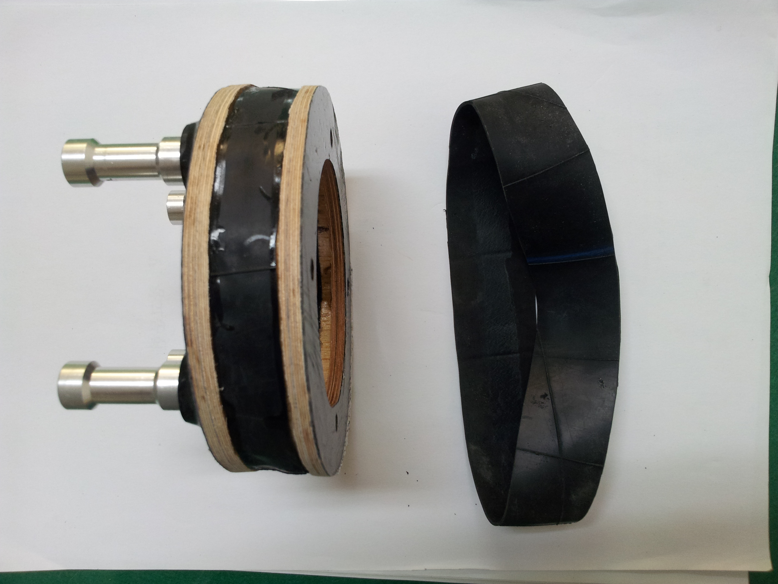

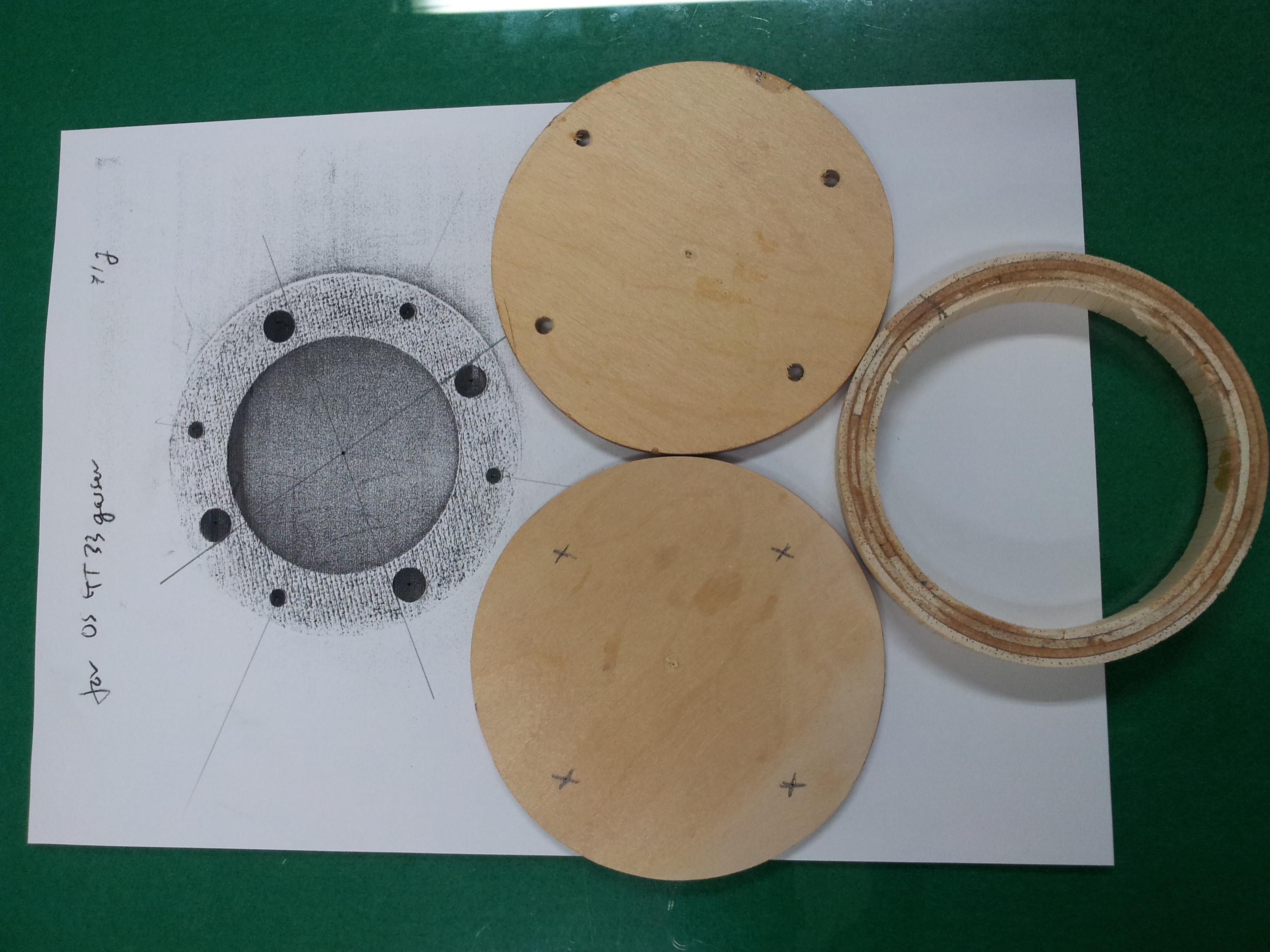

Originally Posted by choihjin (Post 11621792)

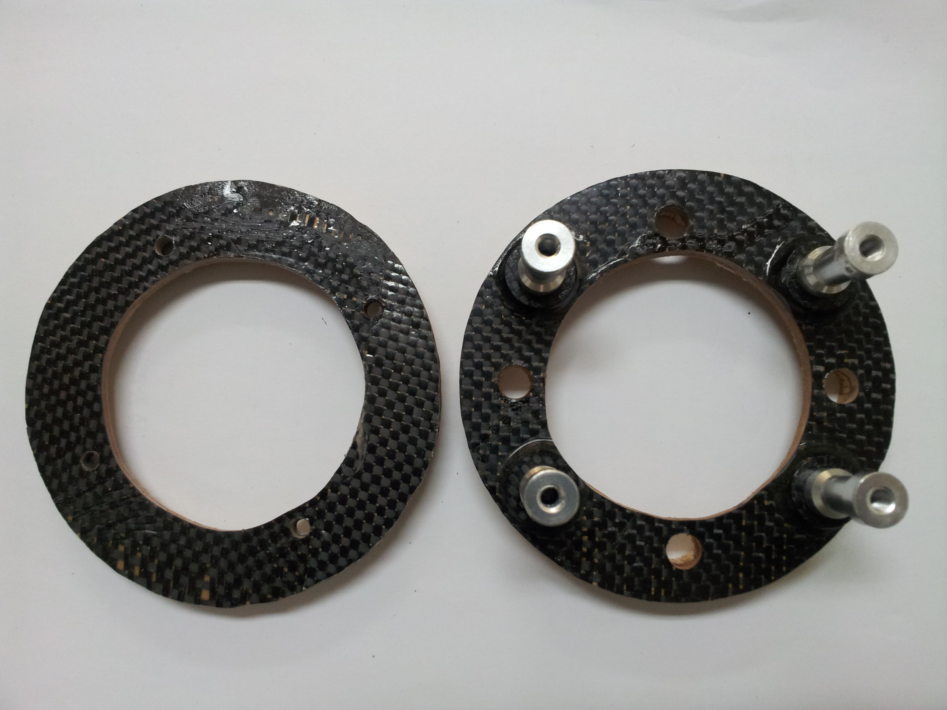

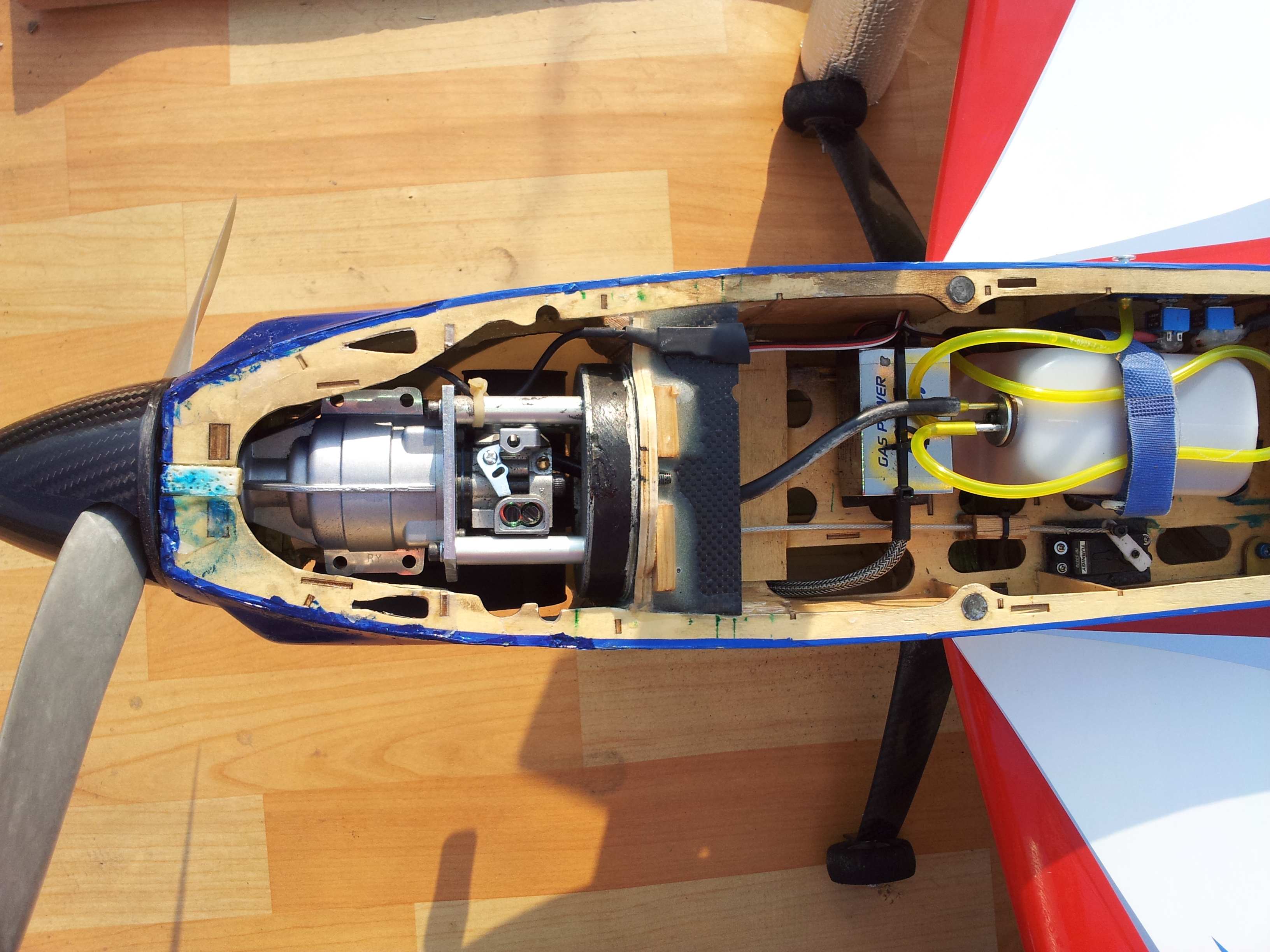

Dear Matt;
I just made a ring, front plate and back plate.
Diameter of the ring are 88 mm inner diameter and 107 mm, so 9.5 mm thickness.
Thickness of Front plate is 5.5 mm (2x3/32'' +GF), and that of back plate is 4.5 mm (2/32"+1/16" +GF). Diameter are both 111 mm.
Four holes in the front plate (in the picture) are for engine mount of OS GT33.
However, I can not find proper inner tube. One that I have is from a small plow trackter with a circumference of 34 cm, which just fit on the ring without stretch.
I am considering to cut the rubber, and make a tight rubber ring by overlapping two ends pasting with gorilla super glue.
Please, suggest any comment. Thanks Matt.
http://www.rcuniverse.com/forum/atta...mentid=1924037http://www.rcuniverse.com/forum/atta...mentid=1924040
It's a great start Choihjin. If the tractor rubber is all you have, try it but don't cut it. Hopefully it is a snug fit and not sloppy. You want to make sure it is very clean with all of the anti stick material, usually soap, is removed. You want to make sure that the rubber is sanded well with 80 grit or 120 grit in the area that will be glued onto the wood. You want to expose fresh rubber and deglaze the surface of the rubber before using ca.
How thick is the rubber? I use 2 layers of 1.3 mm thick rubber and that is working out well. The first layer is glued on the edge of the rubber onto the inside lip of the ply faces. The balsa spacer is undersized about 1.5mm on the radius, all around, compared to the ply faces. The second layer is glued on the edges of the plywood rings, overlapping the first layer. Only the edges are glued. The mid section of the rubber is allowed to move free to snub out the vibrations
For mounting stand offs off the front face, I use flat headed screws. I add a small ply piece about 6mm thick behind the screw holes, I drill and tap the backing and then use a chamfering tool which makes sure the flat head screw screws in flat. I think your machinist friend should have all the tools you need...
Good luck, you have a great start

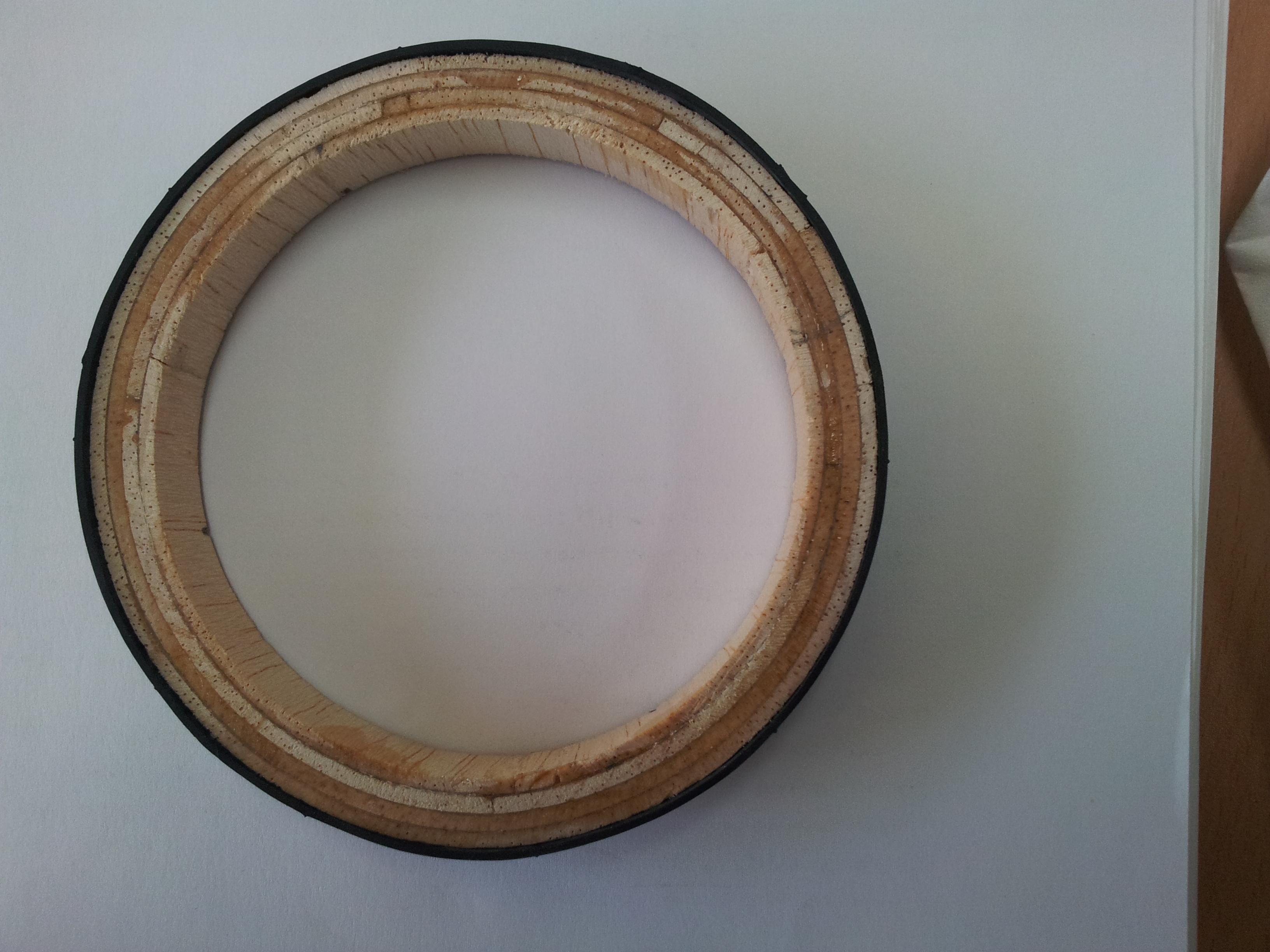

tele1974 09-22-2013 07:50 PM
Is the inner ring laminated? Can you describe the building of the ring?

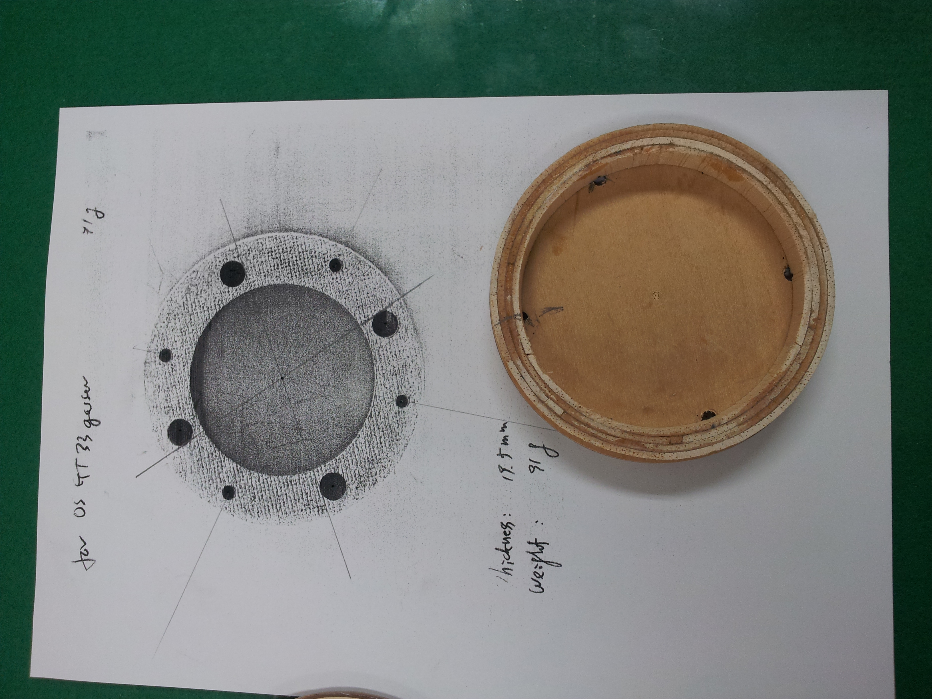

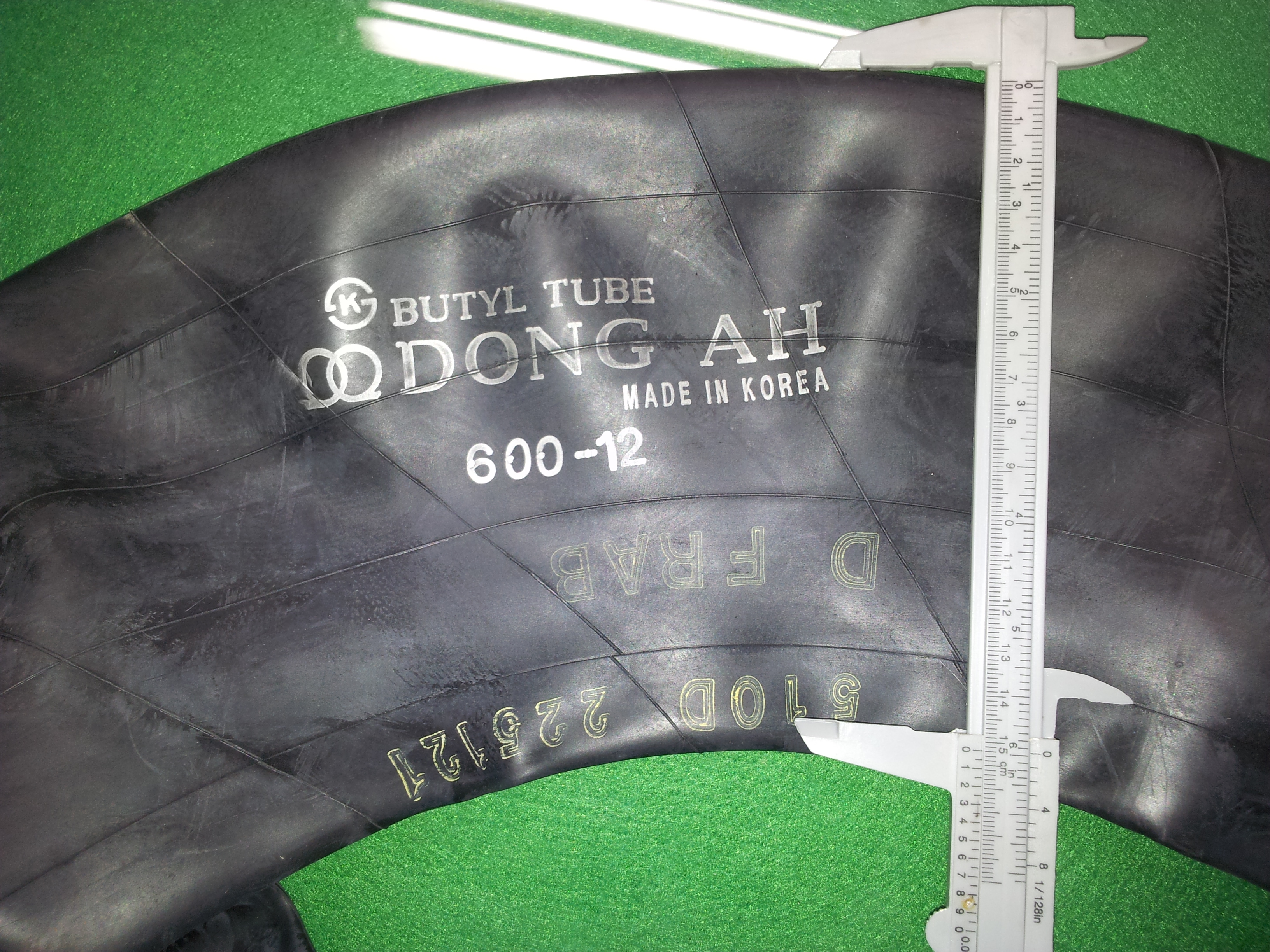

choihjin 09-22-2013 10:55 PM
2 Attachment(s)
Dear Matt:
Thanks for your prompt reply.
The thickness of the rubber is 1.0-1.1 mm, which just snug fit on the balsa space (width 15 mm).
You recommend not to cut it, just glue it on the ring. Thanks it make me clear.
I have organized all your posting about soft mount in RU, which is 21 pages. I already figure it out in my brain.
Mine is also undersized 1.5-2 mm on the radius to the ply faces. I will remove some by grinding off on sandpaper.
Yes, I will use normal M5 with sockethead cap screws, or I have to order some flathead screws.
BTW did you made the standoff mount by yourself? One I have is bought from Hobby King (M5 both end threaded, 6.0 cm long)
It is too long (60 mm) and the thickness of soft mount will become 25-26 mm, so I will use it without ply pieces (6 mm thick), but I will strengthen the front plate with a carbon fiber. Do you think it will be fine?
Tele1974, please reference it which is the original Matt's posting in RU.
http://www.rcuniverse.com/forum/m_62...tm.htm#6285026
http://www.rcuniverse.com/forum/atta...mentid=1924116http://www.rcuniverse.com/forum/atta...mentid=1924117

That fit looks pretty good. The mount will be a little softer but that's okay. On the mounting screws, if the faces are thick enough, say 6mm or so, the extra plywood pieces that support the back of the screws are not really necessary. The screws are epoxied in place and will not come apart. Stand offs are standard hex aluminum stock purchased from one local Industrial Supply source, McMasterCarr. For the GT33 I use 5/16" (about 7.5mm) outside diameter X 1 1/4" (about 31 mm) long stand offs. I use 8-32 hardware in my soft mounts (closer to M4 instead of M5....it is a lot lighter). The DLE55 is also held on with 8-32 hardware so strength is a non-issue
I use thin ca glue to glue down the rubber edges directly onto the ply wood. I first fit the rubber and then apply the ca, hold it until it kicks off and proceed to the next section. I work on one face at a time, gluing the edge completely all around before moving to the second face.
I then install the second facing loosely. I turn the assembly so that the facing to be glued to the rubber is on a hard, sturdy surface. Then with a flat screwdriver blade I push the rubber down to meet the plywood, and apply thin ca. Usually the rubber needs a little stretch to get snug against the plywood face. I hold each section until ca kicks off and proceed all around
Once the first rubber layer has been installed, I sand the plywood edges flush with the rubber surface, making the plywood ready for the second rubber layer. Fresh wood and freshly exposed rubber adhere great to one another. If some glue has gotten on the plywood somehow, I sand that area well to expose fresh wood.
The second layer is longer than necessary and fits over the whole mount. I usually work on one edge at a time. I roll the rubber back and apply medium ca to the ply ring. The rubber is flipped over the ca and allowed to kick off while holding the rubber firm against the ply ring. Then the second rubber end is rolled back and the same treatment is done to the second ring.
Then, with a sharp razor, the rubber is trimmed flush to the faces.
Carbon cloth may be applied now to each ply face or much earlier before final assembly is started. In my mounts I tend to apply the carbon first before assembly. It is easier to apply without screws in the way.
The final treatment is to remove the center section of plywood leaving a hole in the middle of the mount, and fuel proofing the exposed wood. The hole removes unnecessary weight and tends to house the front section of the carburetor and the stand offs I use are just long enough to clear the mixture screws on the walbro. That's it. The completed mounted usually weighs around 2 1/2 ounces (65 to 70 grams), but that depends alot on the hardware and plywood thickness used. The plywood I use is 3mm a/c birch (1/8") at least 5 ply and Usually 7 ply.
I also cut a hole in the firewall further reducing weight. The FW hole corresponds roughly with the hole in the mount...
MTK 09-23-2013 06:17 AM
The balsa spacer Patrick? There are a couple ways to do that. Lamination from 3/32" wet stock is one way. I have also cut the spacer for cross grained balsa. Either method works fine. I have never tried to use the balsa flat; always cross grained for better support. But flat might also work well.....
The thickness should be around 0.600 but I have built mounts with spacer thickness as thick as 1 1/2". They all work well to snub out the high freq vibes. Only a low frequency shake remains which is not really destructive to the airframes.
A practical balsa spacer thickness is 0.6" to 0.8", in other words.

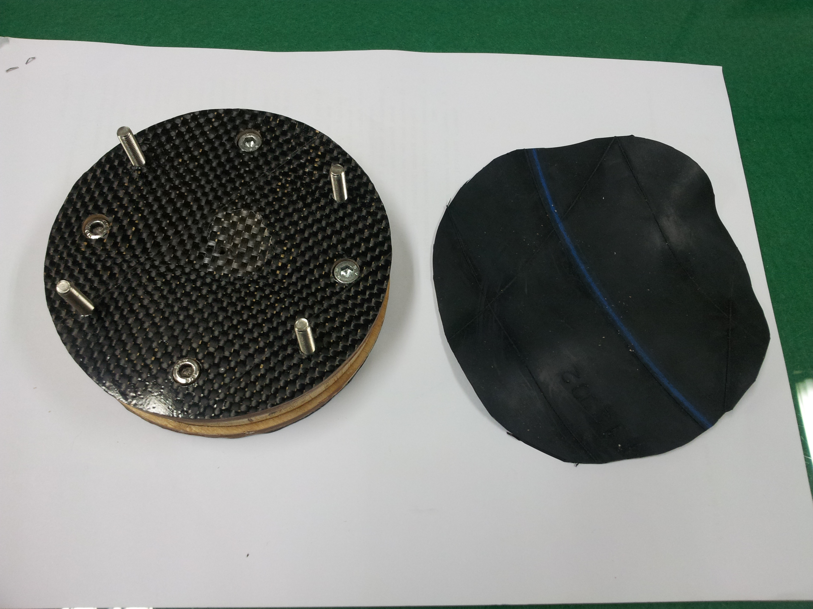

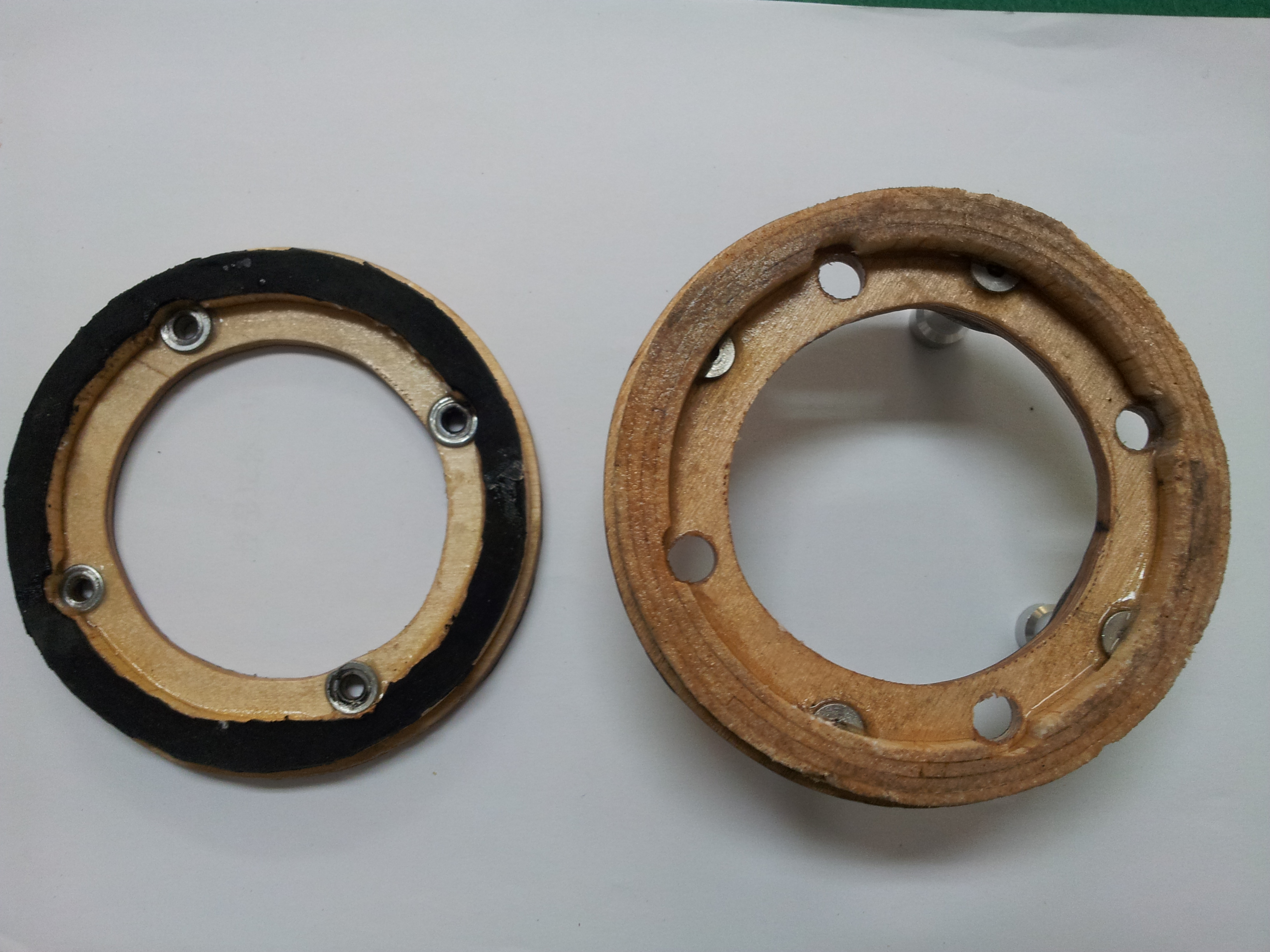

choihjin 09-24-2013 04:07 PM
2 Attachment(s)
Dear Matt;
I am learning a lot from you, Thanks a lot.
I got some knowledge from Google, but your descriptions are much valuable for me practically.
Still waiting for stand-off mount, I am almost ready to the final.
As you mentioned on fastening the flat-heat bolts on the front plate with carbon washer, I drilled the front plate and milled with a count sink, which I found and have in my BOSCH drill sets.
I just put all bolts in the plates to make sure them in right place, and pre-assembled.
The rubber piece (from same inner tube) will be used for the back-half balsa ring after glued together and divided.
After I got the carbon washer, I will glue it on the front-side of the front plate, and tighten with the flat-head bolts through hole from the wooden side, with some epoxy.
Thanks a lot.
http://www.rcuniverse.com/forum/atta...mentid=1924596http://www.rcuniverse.com/forum/atta...mentid=1924597
MTK 09-25-2013 05:50 AM
Choihjin,
I think you got the essential parts pretty well. The next mount will be much easier to build.
I'm not sure if you have a balsa spacer for the front facing. I don't see it shown in the photo. It isn't absolutely necessary to have a spacer for the front facing tho, so you should be fine. You should try and keep the bolt heads from hitting the balsa spacer on the back facing. When the engine is idling, the mount allows a lot of shake and the bolt heads could do some damage if allowed to hit anywhere.
Looks to me that you are just about ready to install the rubber rings. Excellent job!
You may want to reduce the length of the flat head bolts. I usually expose about 7-8 threads; I use a drop of blue loctite (the removable type) and the stand offs don't move until I move them.
Once you remove the center area of the mount you would be surprised at how light it is. My mounts for the 33 usually weigh about 65 grams, but mine are a little smaller than yours. Still, yours should be well below 100 grams

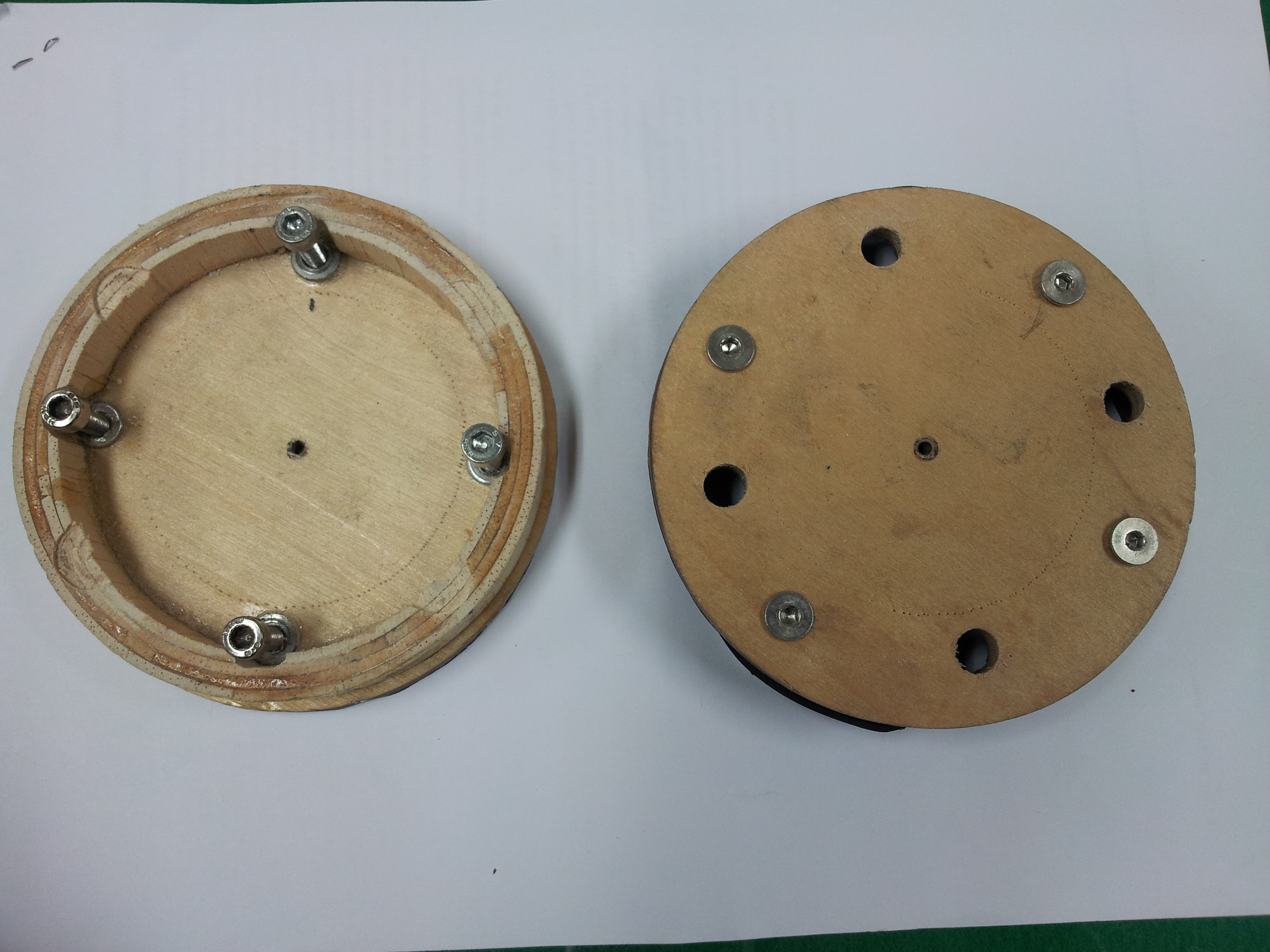

choihjin 09-26-2013 08:34 PM
3 Attachment(s)
Thanks Matt K and Bob for your concern on my soft mount project.
After glued the flat-head bolt with carbon washer on the front plate, and epoxied the balsa ring on the front plate.
After hardened it, then epoxied it to the rear-plate, and tightened with M3 bolt (photo). After hardened it, the balsa ring was divided into two pieces.
On the rear balsa ring a rubber piece was covered and glued with CA (thin regular), and trimmed off some rubber.

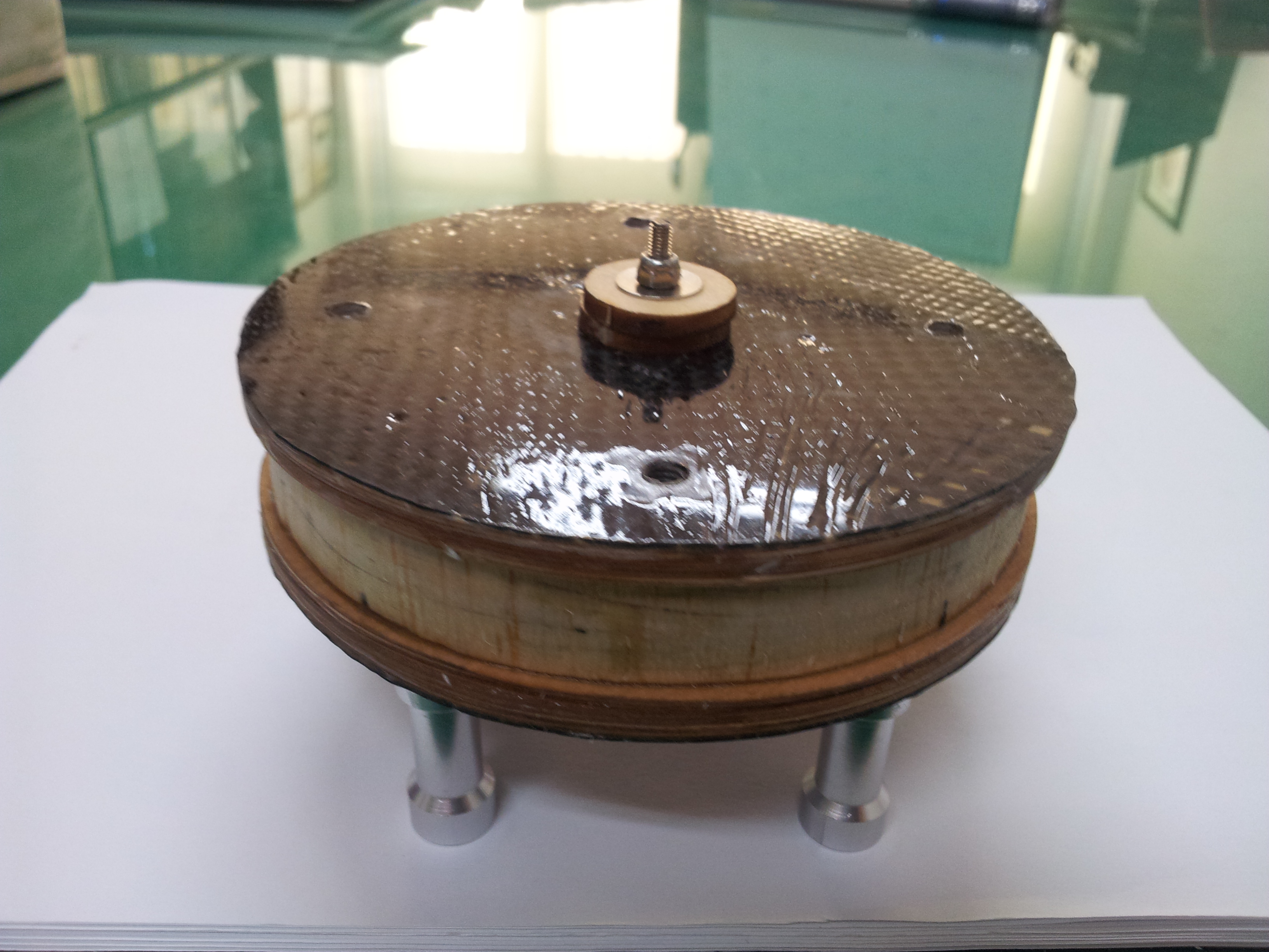

choihjin 09-26-2013 08:43 PM
2 Attachment(s)

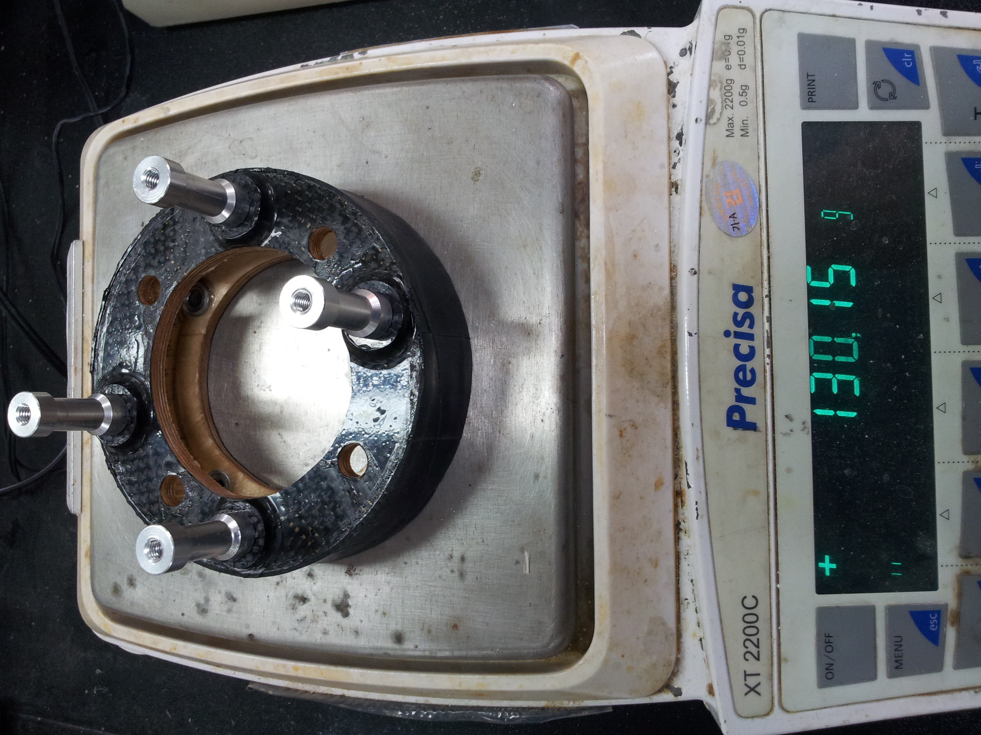

Now I am posting my first hand-made soft mount for OS 33GT.
Thanks a lot Matt. Your guidance really helped me very much.
Mine (130 g) is heavier than what you and I expected. Probably I glued too much epoxy and CA. But it includes four stand-off mounts and beautiful carbon clothes on the front and rear plates.
Now I know what I will do or not for next projects. Thanks again Matt.
Regards
http://www.rcuniverse.com/forum/atta...mentid=1925128http://www.rcuniverse.com/forum/atta...mentid=1925129
cmoulder 09-27-2013 03:36 AM
That weight is very respectable considering it includes 4 stand-offs! Nice work!

Choihjin, 130 grams with the 4 stand offs is about as expected. The stand offs probably weigh around 50 grams, so the mount itself weighs around 80 grams. Very good for a first effort. As you build others, you will find how and where to remove weight. For example, if you wanted to spend some time grinding away some of the wood on the facings, you could remove another 10 grams at least. If you cut the studs back at least 1/4" that will shave another 10 grams. Remember you only need about 7-8 threads on the studs. Four - five threads are usually enough for a 100% strength joint.
One thing you probably should do is to add a thin ply ring (1/64" is plenty thick) on the balsa spacer where it was cut. You want a smooth surface riding on the rubber facing of the rear balsa spacer. Otherwise, the rough balsa edges will grind the rubber apart quickly.
Good work!! I am interested in its performance. Please report back after flying it a few dozen flights

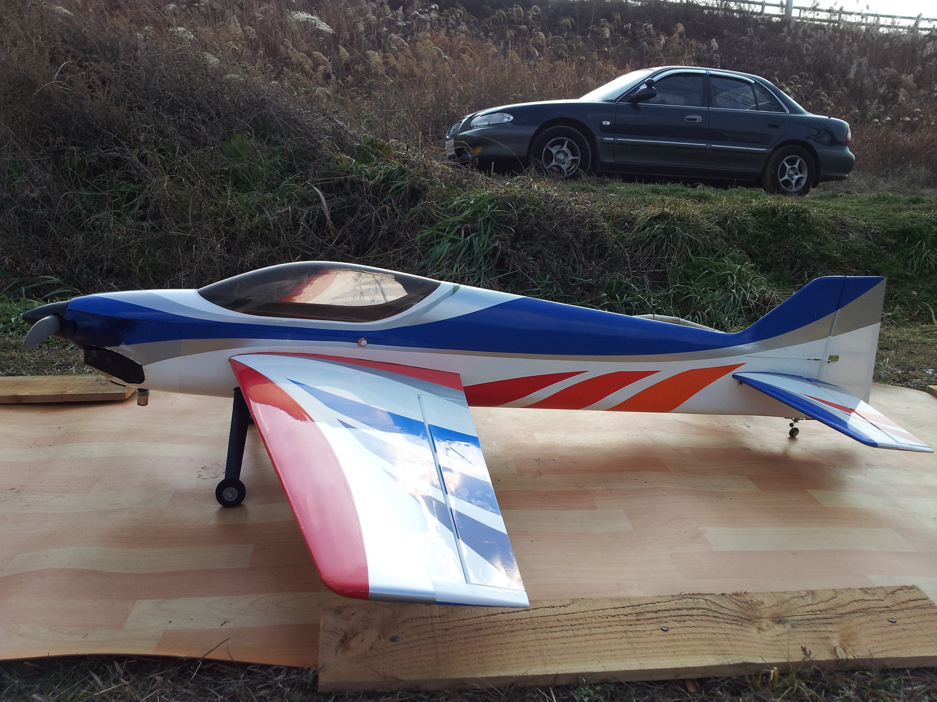

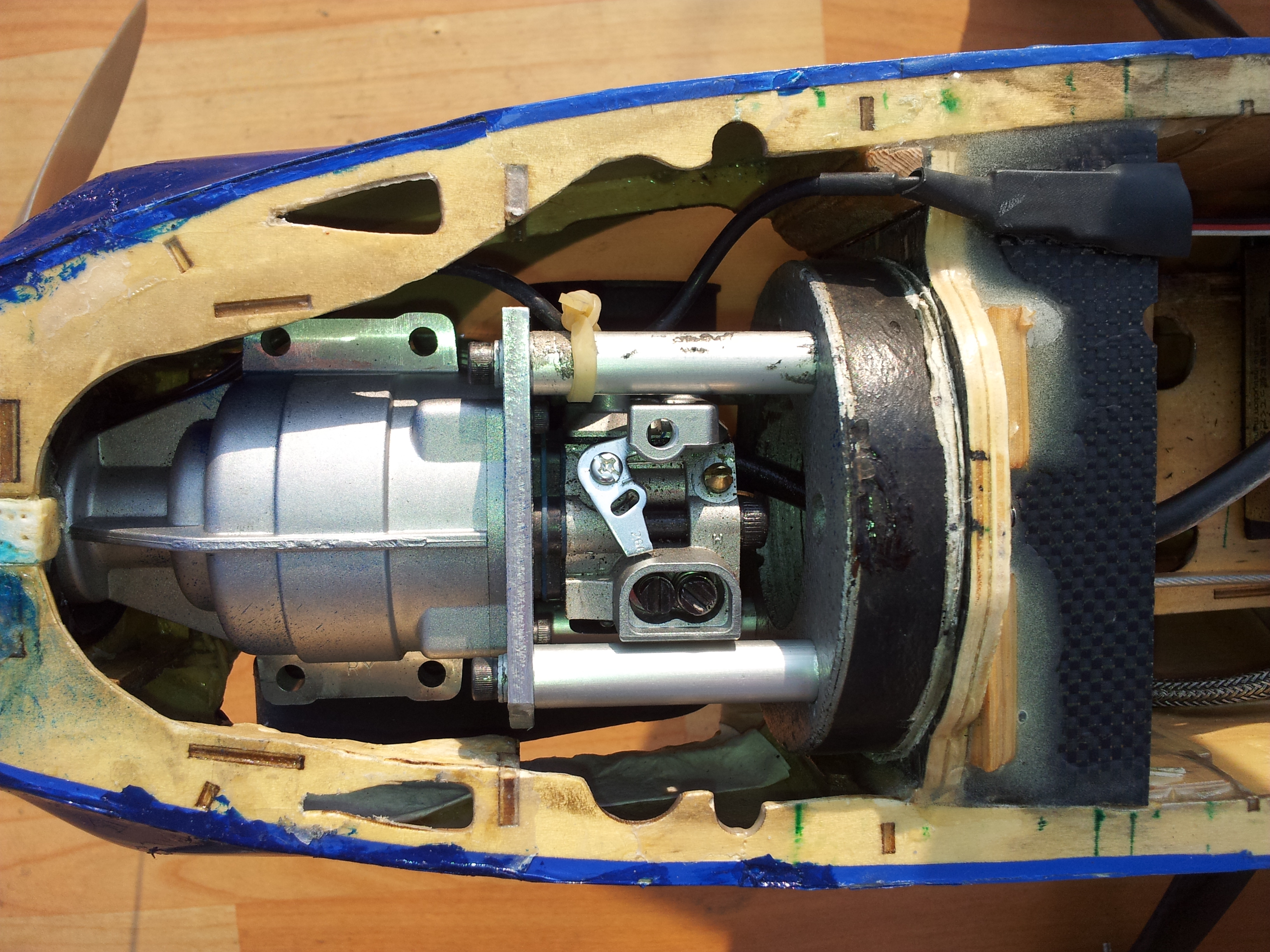

choihjin 10-13-2013 08:33 PM

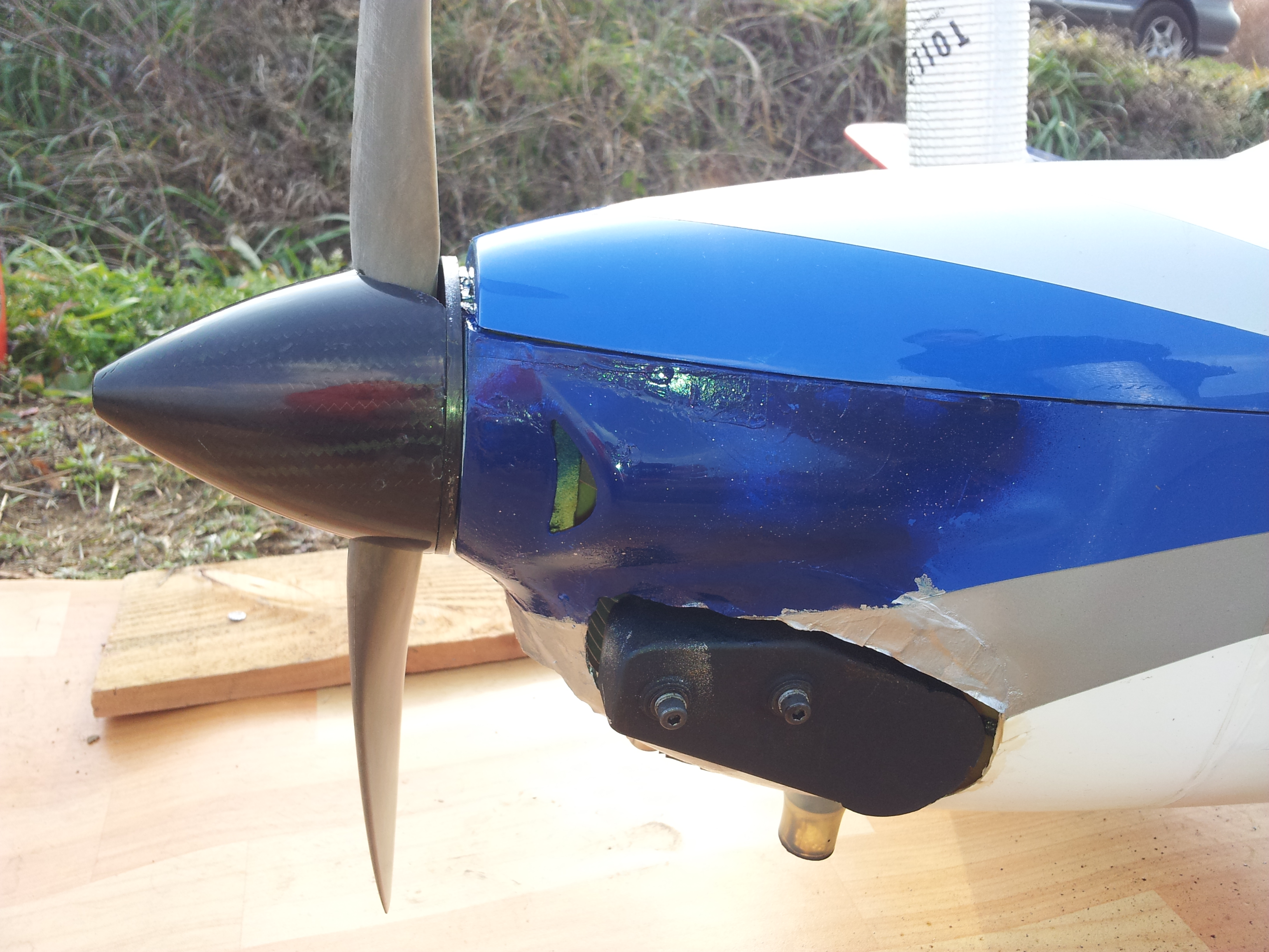

My Vanquish is finally converted to the gas-powered with OS GT 33 gasoline engine, following with Matt's suggested procedure.
With my soft mount, OS Gt 33 engine with stock muffler, 2600 mA/h Lipo for receiver, 1200 mA/h Lipo for ignition, 16 Oz gas tank, a power box and enhanced gear mount, this Vanquish still weigh 4965 g just under 5.0 kg, It flies unlimited high and sound is soft. My club mate did not recognize that it has gasoline engine. Most of them did not believe it is powered with a gas engine. I am not excellent pilot in F3A, but I love this Vanquish, and I will buy one more Vanquish for back-up.
Thanks Matt

4 Attachment(s)
Hi, Matt;
My both gasified planes are equipped with OS stock muffler which are really a muffler, very quiet, quieter than YS stock mufflers, IMO.
Sebart's Wind S 110 is quite large plane, but not heavier than most gas-powerd 110-sized plane. I have not weighed it (4,295 g), but OS GT 22 is enough for this plane, unlimited flying high.
APC 16x10 prop is installed, compared to APC 19x10 on OS GT33 on the vaquish.
This gasified Wind S 110 is now flown more than 20 flights already.
From Picture this GT22 is modified to stand-off to original Hyde mound, which I bought from Central hobbies two years ago.
It is not easy to install in a limited space of engine bay in Wind S 110, so I tightened each part, engine, stand-off, mount, in the engine bay, and muffler from outside.
To modify to rail to stand-off mount, an aluminum plate (8x8x4 mm, I do not remember exactly now) was placed between crank case and carburettor tightened with four M3 bolts (14 mm), 4 mm longer than original M3 bolts (10 mm).
I hope someone follow my mod Wind S 110.
Regardshttp://www.rcuniverse.com/forum/atta...mentid=1944098http://www.rcuniverse.com/forum/atta...mentid=1944099http://www.rcuniverse.com/forum/atta...mentid=1944100http://www.rcuniverse.com/forum/atta...mentid=1944101
