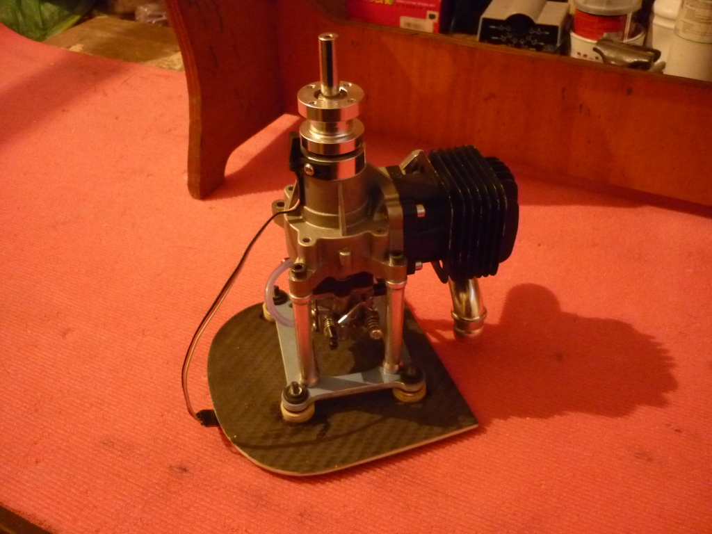

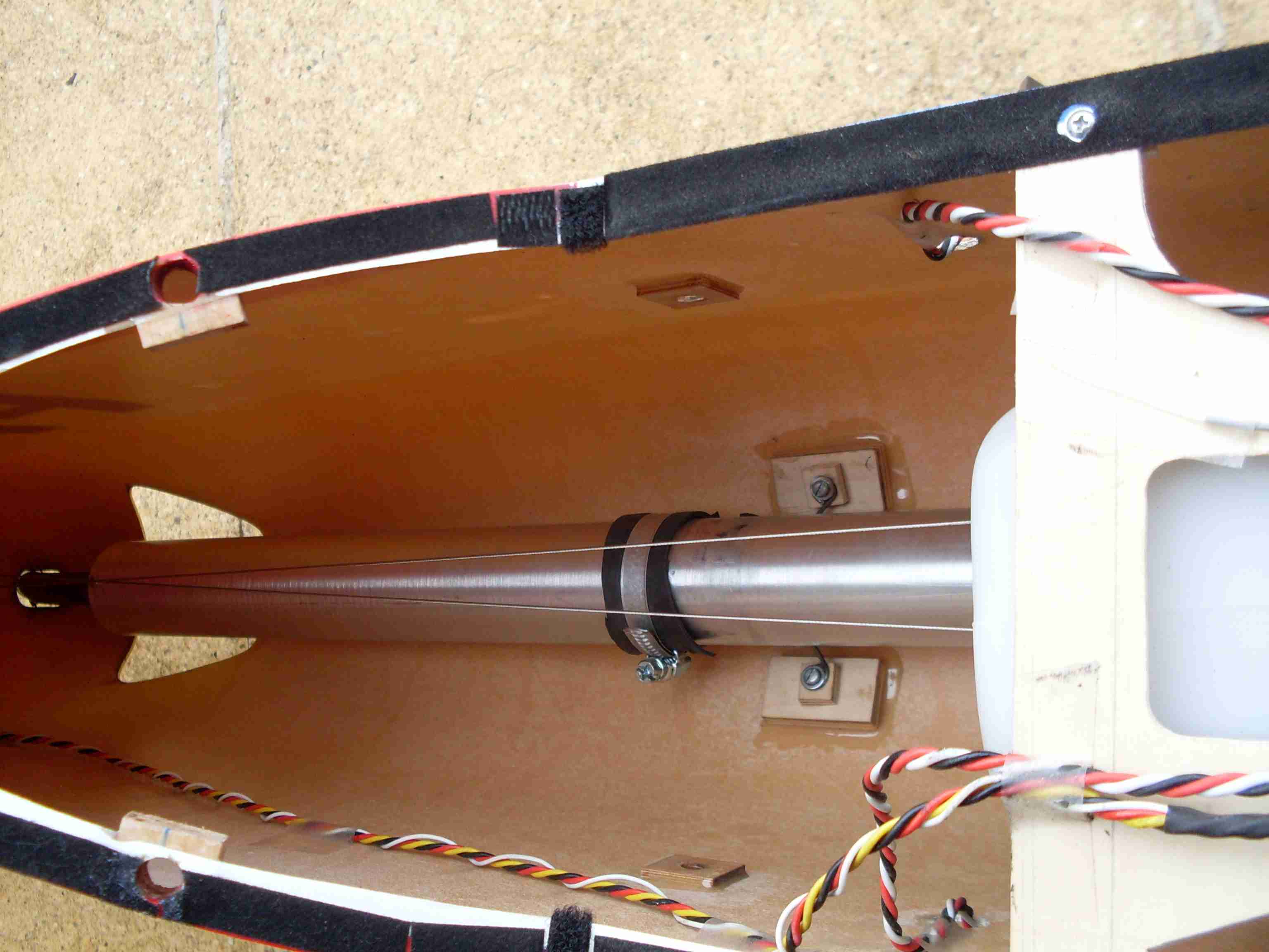

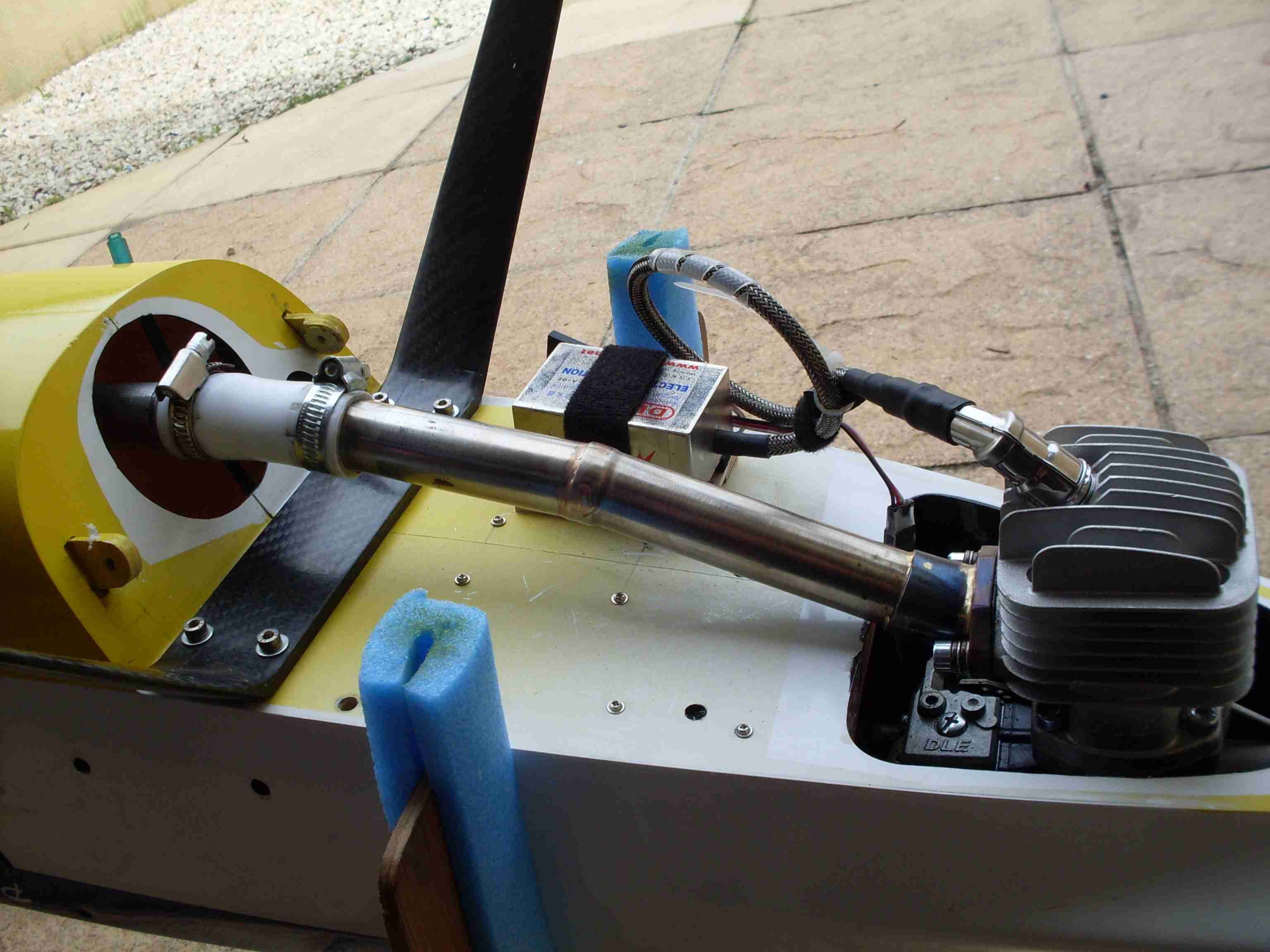

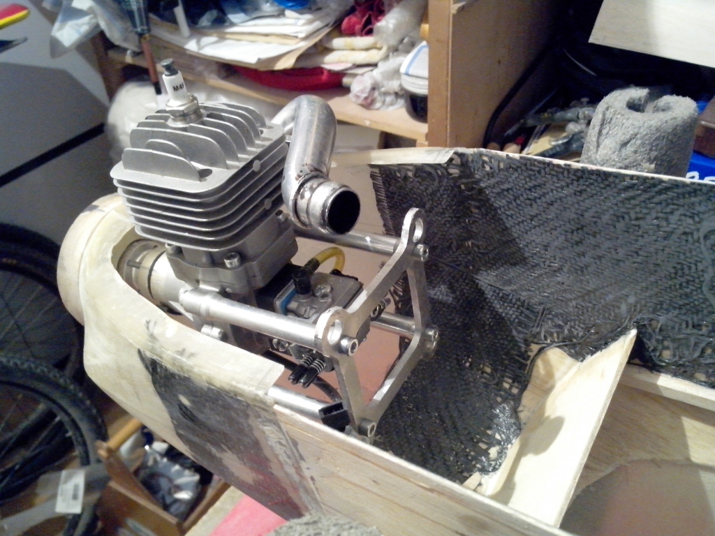

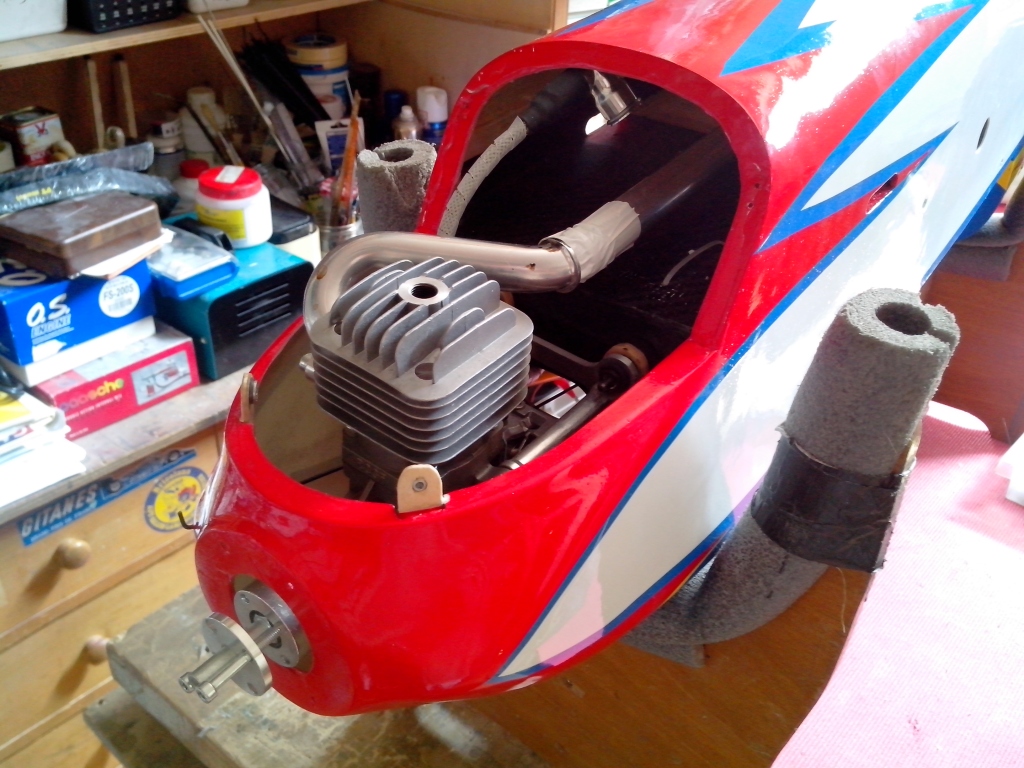

papaone 02-28-2014 03:14 AM
10 Attachment(s)
Hello
Friends of mine used :
RCGF32 reliable, cheap (Hatori exhaust and pipe same price as engine)
DLE35RA cheap, very powerfull, reliable, rear exhaust
PTE36R powerfull but 2 crancases failed

MTK 02-28-2014 06:46 AM
Originally Posted by tele1974 (Post 11747751)
To date what are the gasify options. I have been out of the game here for a few months. Job change.
-- OSGT33
-- PTE 35
-- Syssa?
What else?
I've seen and handled an RCGF32. It looks like a nice piece of equipment. But have not run one....
I've played with the DLE35 rear exhaust. Same benefits as the Syssa180 but more powerful. A pretty nice engine actually.
I've played with the PTE36R rear exhaust. Same benefits as the Syssa but more problematic. Not recommended
I also don't recommend the Mintor 38cc.
The Revolution 33 looks like a nice product but I don't know anything about it and unless someone gives me one to play with, I will not have personal experience
I just bought the ValleyView 40cc twin. Lightweight, and should be as strong as the OS33, but I have not run it yet.
If I were to grade them,
OS
DLE
RCGF
Revolution
Syssa
VVRC
