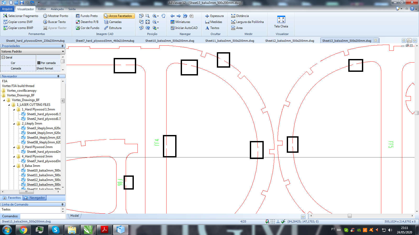

AndersonR 05-24-2020 07:21 PM
2 Attachment(s)
I have other question too why many locate plant have some bug when Laser will cutting he will stop and continue other locate see this.
Attachment 2267460
Alex Voicu 05-24-2020 10:46 PM
Hi,
The purpose of these tabs is to keep the parts attached to the balsa sheet, otherwise it is easy to loose some parts. You can easily cut these tabs with a cutter and detach the parts from the sheet when you need them.
